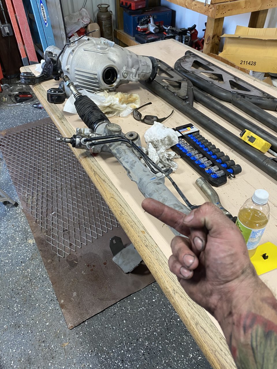

    I was pulling the piss out of it!!! Had to undo the tie rod BEFORE pulling the shafts. Got it removed finally. Took me 5 F’n hours!!!!! The diff damn near broke my arm. This is definitely a 2 man job. Doing it by myself sucked ass and is a total PITA!!!
    Now I get to replace 2 diff axle seals and probably 2 tie rod ends. What trick do y’all use to get the axles back in the diff without messing up the c-clips sliding them in? Tricks for getting the diff axle seals in?

    Is this even factory? I bought the truck a month ago with 53K miles. Does the new toyota R&P come with boots? I ordered directly from

    If y’all could point me in the direction of a how-to on re-installing these front diff axle seals and sliding the front axles back in the diff, that’d be awesome! I’m sure I can get the seals out but putting them back in properly is my question, along with compressing the c-clips on the axles. I know the Taco guys use hose clamps but there’s got to be a better way. thanks!

    Just push them w some force they pop right in...

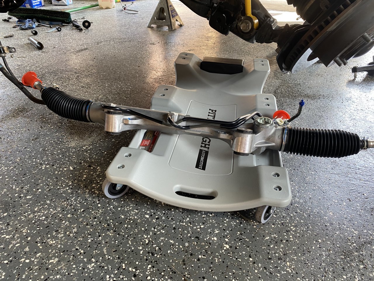

    Time to put the new one in! It came with a hard line stub that I may have to remove to get it in. Idk yet but will in a few minutes.

    Good luck, and you may have to but not a huge deal if you do. Also nice garage floor!! did you do it or have it done professionally ??

    Got R&P in and all buttoned up. Didn’t have to remove the nub. Way easier going back in! Waiting for a buddy to help me put the diff back in.
