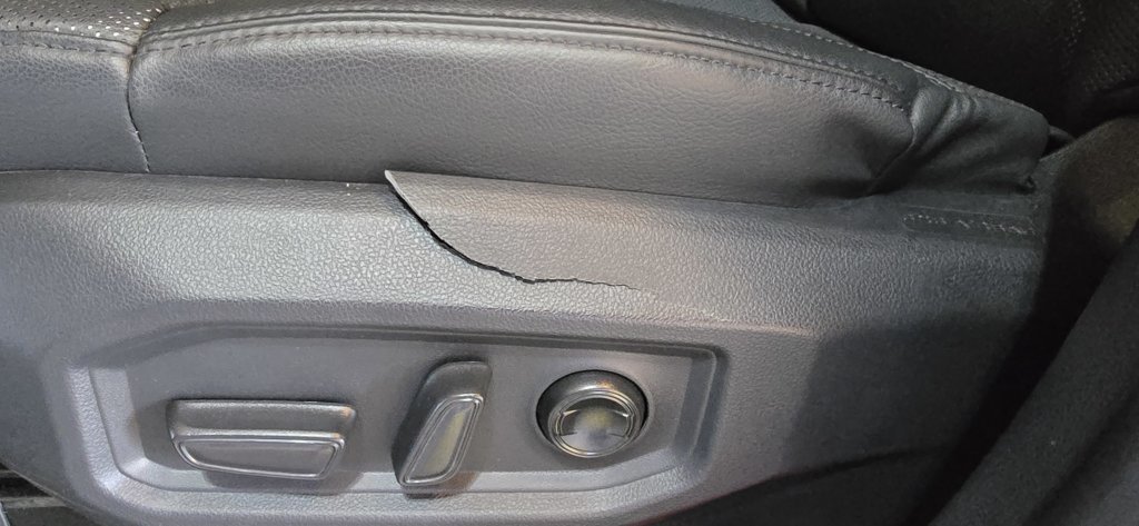

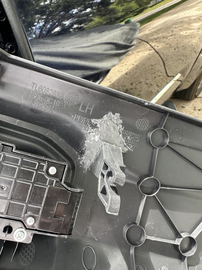

    Cracked mine today 2025 TRD with 25K km on it .... taking it to the dealer tomorrow.
    Dealer said: Yes its covered under warranty ... (silver lining after all)

    My last one looked exactly like yours. The first two weren't completely broken away this bad, just a couple of stress splits in the same area as this. I can kind'a see my first couple breaking from me being a fatboy. I've lost around 75lbs since then and the last 2 have been replaced with the "new and improved" panel that still breaks at 225lbs.

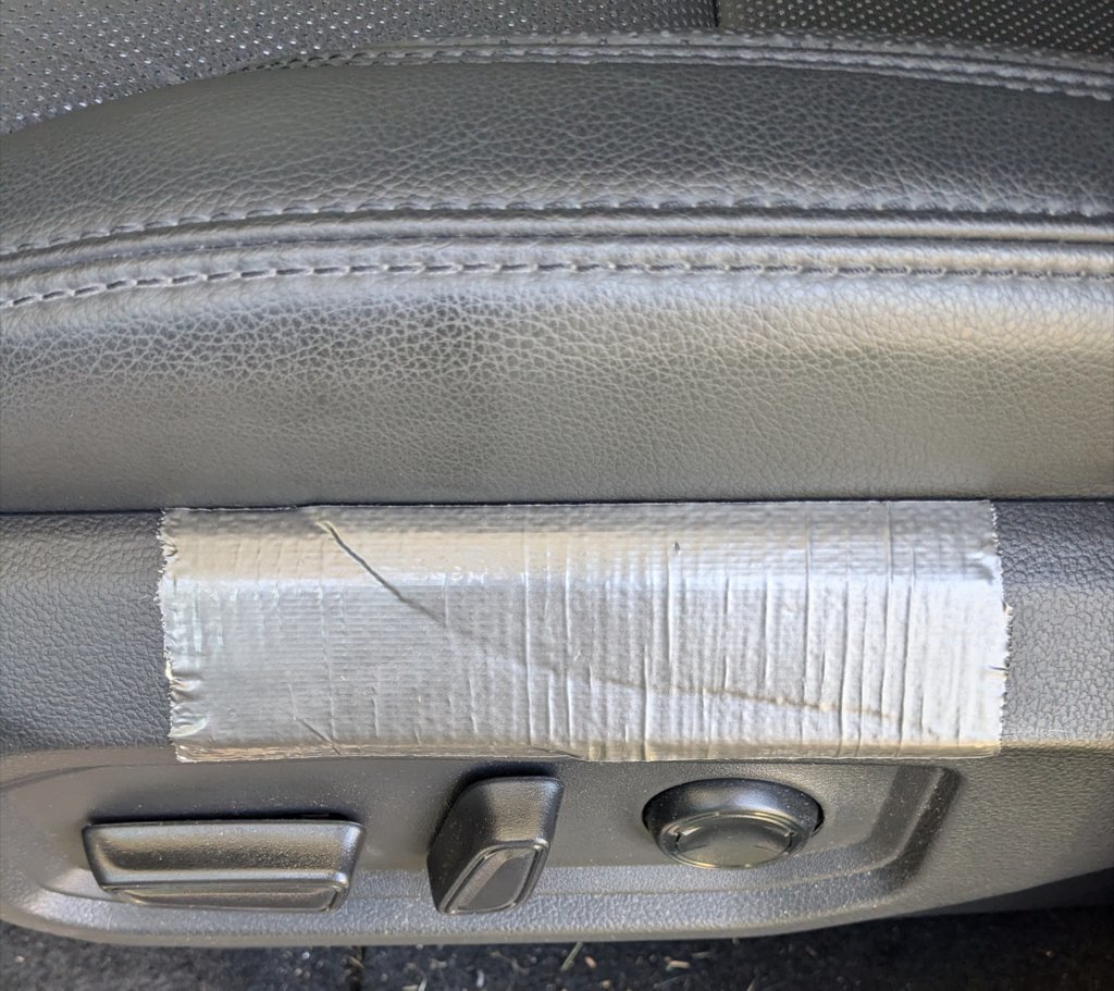

    That’s how mine broke, I put duct tape on the plastic to keep from ruining the seat until the dealer can get it in!
    kirkb and Tundra Sam[QUOTED] like this.

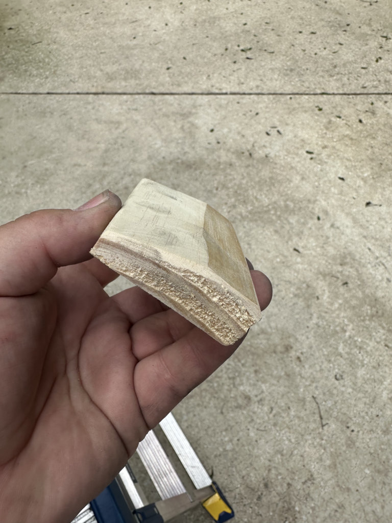

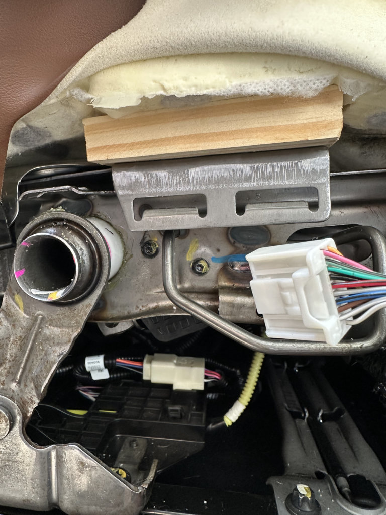

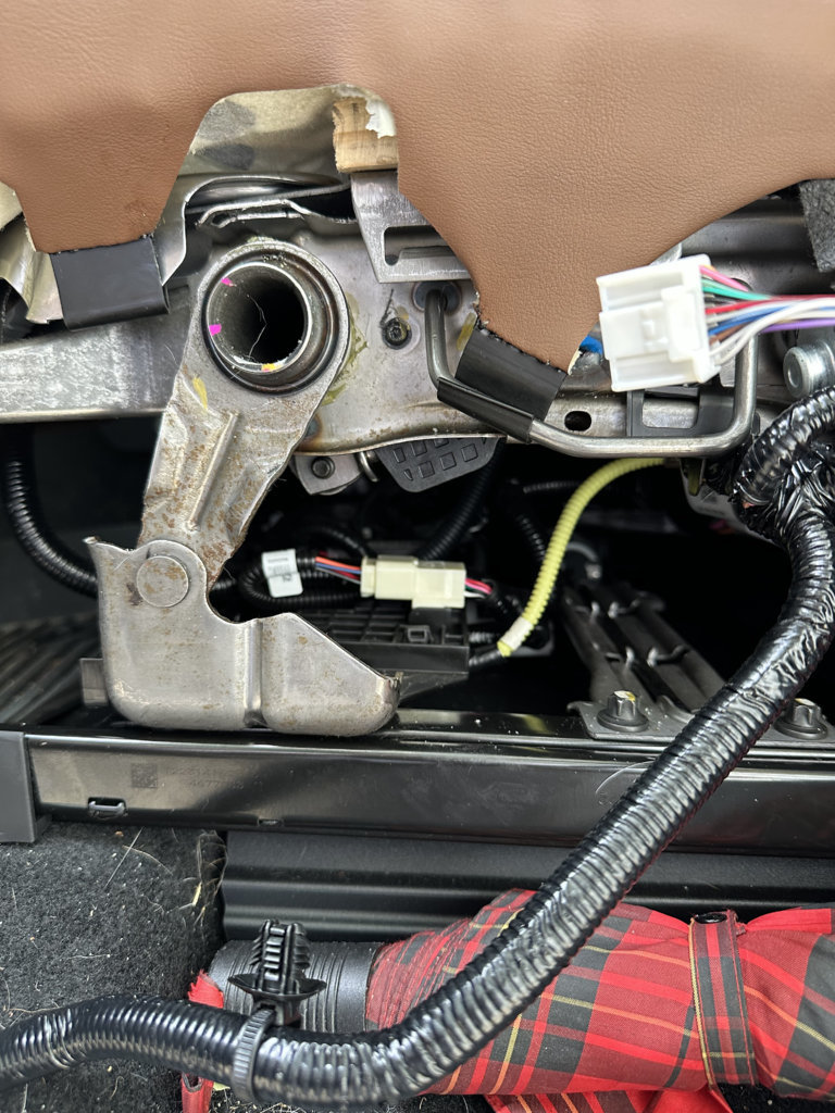

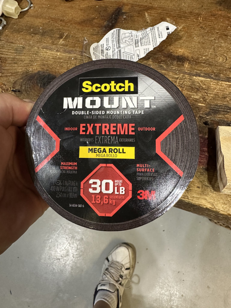

    This is my simple mod to keep the seat panel from cracking. Mine always cracked in the same place as this one
    [​IMG] I JB welded my crack
    [​IMG] Then I found a 1x4 board I had lying around and sanded it to a curve.
    [​IMG] I used double stick tape to affix it to seat frame under thigh bolster. Curved side towards center of seat
    I reinstalled the panel. You can't see the board, once panel is installed. I've been purposefully sliding off the thigh bolster to get out of truck for two months and 2000 miles. I would think since the JB Weld is stiff and the seat panel flexes that it would have re-cracked. The crack hasn't returned. The thigh bolster does feel a little stiffer, more like my sport car seat. When I get back home in October, if the crack hasn't returned, I'll get a new panel.

    According to a recent Tech Tip (T-TT-787-25) released by Toyota, if the panel keeps cracking in this area, it is due to improper installation.

    This last time was the only time it was installed improperly. That's why it cracked the second time I sat on the seat. The previous 3 times it was installed correctly.

    Doesn't seem like it can be installed wrong being such a simple piece. Obviously you can't show the full tech tip, but curious if you can describe what Toyota thinks is being done wrong?

    There is a clip that is being forced above where it should be below, hence cause fatigue in the plastic.
