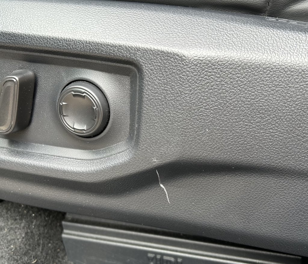

    I just noticed my passenger seat is starting to crack. I'm on my third drivers seat panel now as well.

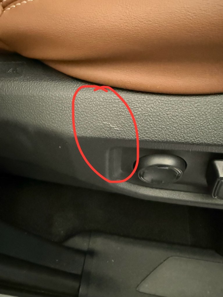

    My has a 5" long crack. Looks like a light scratch so I don't care. If it breaks through or if a permanent fix becomes available, i'll deal with it.
    Has anyone ever tried filling it with some sort of resin?

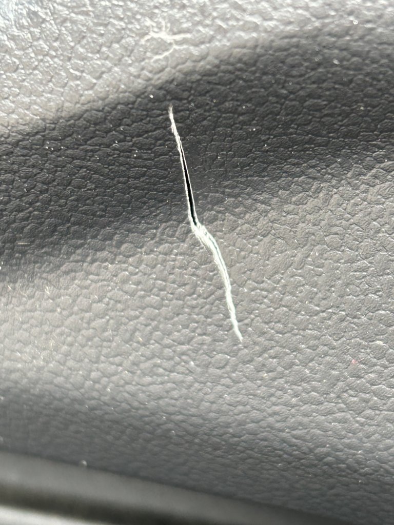

    I'm in this line now. My panel has gotten worse now. It is my work truck so I'm in and out more then just a drive to work and home. There seems to be some kind of back support on the panel that could help it not crack.

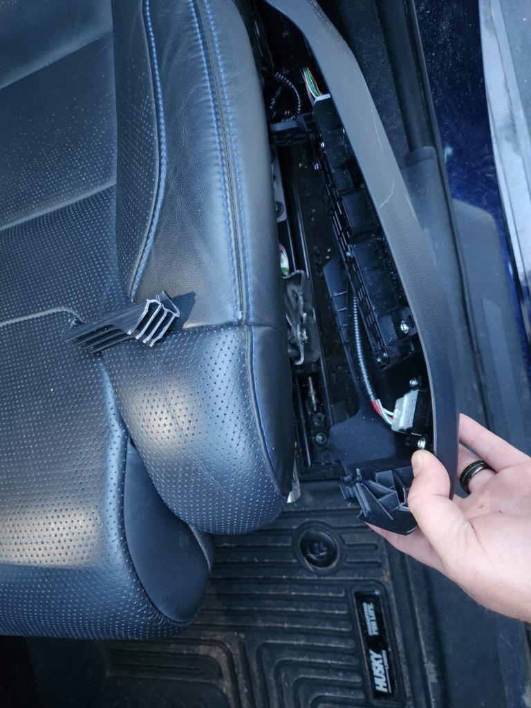

    They have almost joined... 2024, 4900 miles, yes running boards and no I'm not small.
