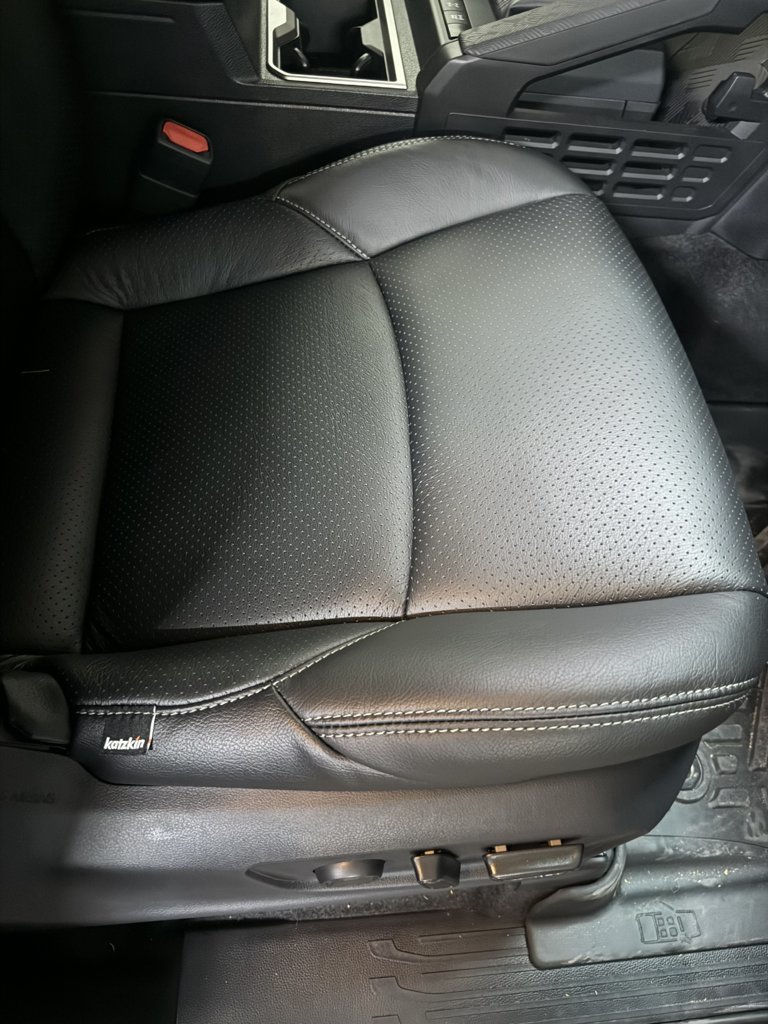

    I just installed Katzkins in my 24 Taco, can’t believe I didn’t takes pictures of the seat panel. It’s a completely different design much beefier, appears to stick out further allowing the seat cushion more room to compress when getting in/out? and is a pain in the ass to remove! So it isn’t coming off again! Hopefully Toyota gets the Tundra seat panel fixed soon! Maybe copy the Taco seat panel’s? (Sheldon Brown) it’s time!

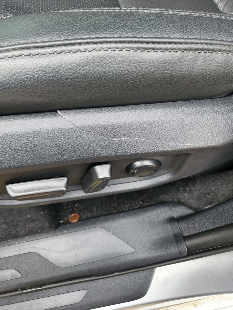

    Well I have now joined the club. Detected an ever so small hairline forming. Thought at first it was a dog hair stuck to the panel. What a ridiculous design. I am at 26k and always get in and out using the side steps and grab handle so I cannot understand how just sitting in the seat would do this over time, but there it is anyway. Just add it to the list of other defects and problems with my rig. What a disappointment this truck has been. :(:mad:

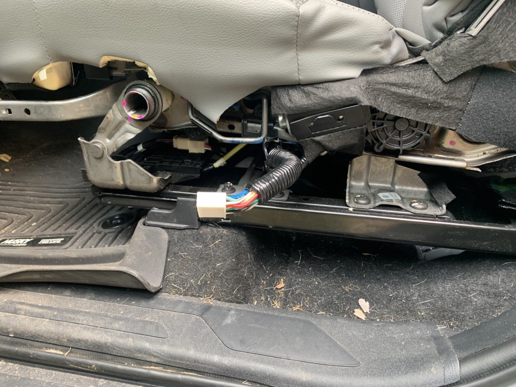

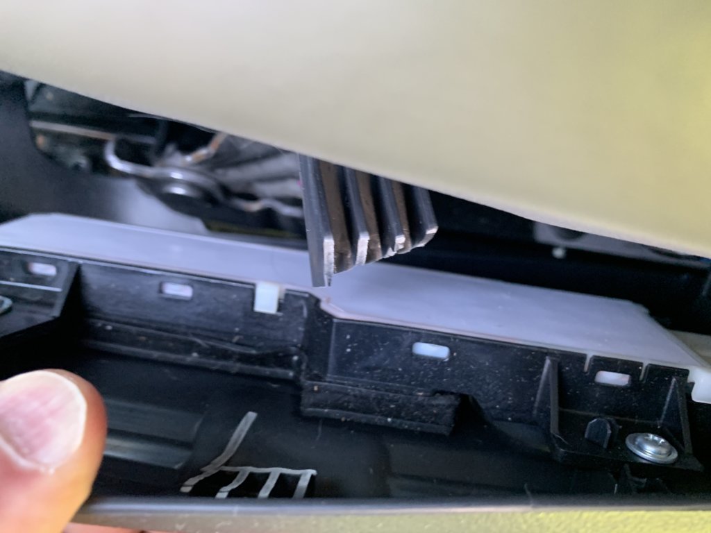

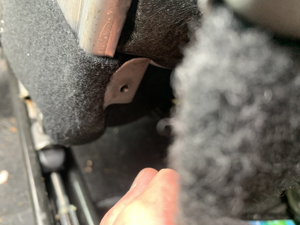

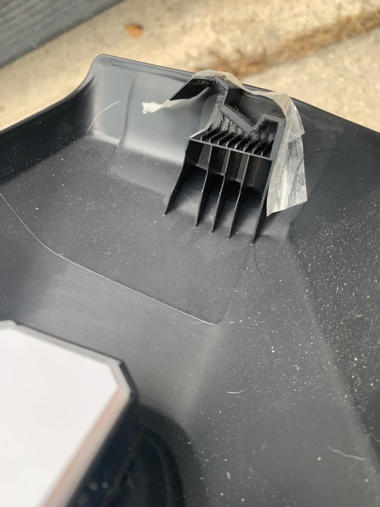

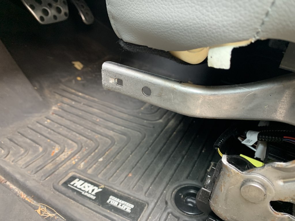

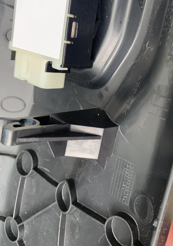

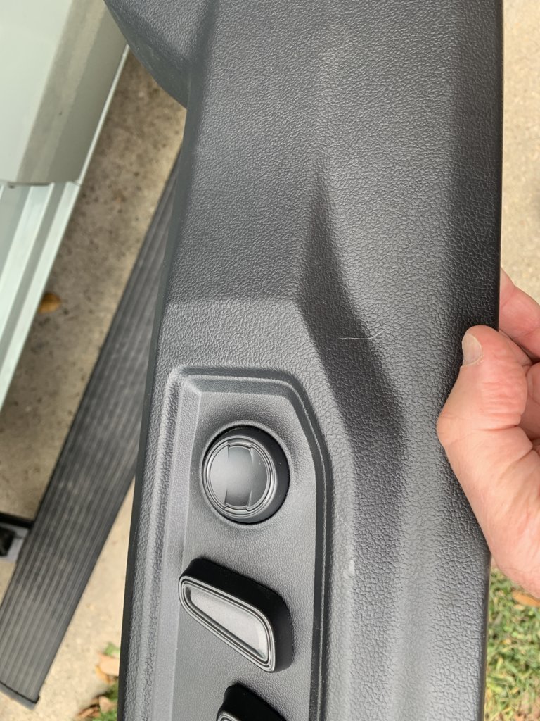

    So, I took my drivers side panel off today to try to do a temp fix, which I should be able to do. But I don't know whether to laugh or cry at what I found. First, to remove the panel there is one Phillips head screw at the bottom of the seat back under the flap. Then just a few clips. One of my clips was already broken (really all 3 but we'll get back to that). Then you need to slide the panel forward to get the front clip to slide out. But, wait. That clip was also broken and obviously broken during assembly and Toyota merely taped it to the rail and sent the truck down the assembly line. LOL. But wait, again. The third and final clip is showing signs of cracking. I mean between the horrible quality of the part and the shoddy assembly this almost seems like it was designed and built like a first year Hyundai product from the 1980s. This is simply pathetic.
    Photos:
    Screw fastens rear of the panel
    Panel off... UGLY.
    Other clip cracking
    Other clip cracking from the outside
    Front clip broken from the factory and TAPED. Note the too thin plastic on the broken side.
    The broken front clip is supposed to slide into this rail but was TAPED on. LOL

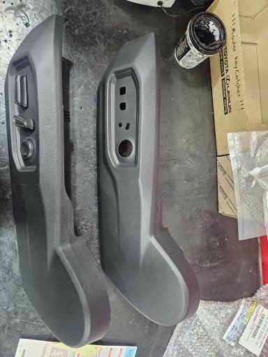

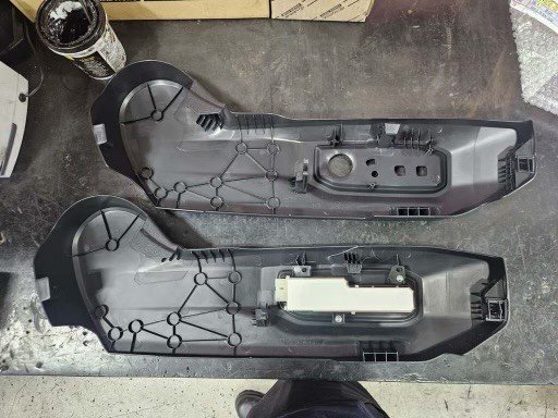

    Got mine replaced today in my 1 year old 23 platinum. The receipts said that it was improved panel. I guess we'll see.

    So, I got my repair done. I glued the broken off clip back onto the panel with 3M Scotch Weld for plastic. Then 3D printed a couple of collars to reenforce that clip as well as the other one that was starting to crack. These have small feet that spread the load onto the panel. Then glued those collars onto the clips with JB Plastic Weld. Then touched up the little crack on the outside with a black sharpie. Feels as solid as new but who knows how long this will last. I plan to get the panel replaced when I take the truck in for its engine replacement or for the final fuel line recall fix. But, after a year and a half waiting is that even still a thing? LOL.

    Yeah, that front clip is almost unnecessary. Tape or a zip tie is plenty. Frankly, it is a dumb design. That clip should be open and just snap onto the rail. It is designed to fail and/or to be broken during handling.
