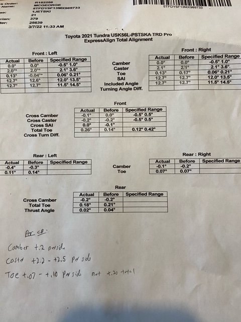

    If I have a cb +3 shackle and RAS HD on lowest setting is that going to put me riding at the top of the shock travel? Would i need to consider a longer shock as well? Fox 2.5 or 3??
    Would SPC adjustable Upper control arms give me better alignment range, as i am trying to avoid spacers and aftermarket wheels? currently cannot fit a pinky between tire and stock UCA.
    I am trying to learn all this stuff, and the local shops are too busy to advise. Any help or thoughts on previous post would be really appreciated

    This is the alignment reading without spacers, felt unstable and twitchy and followed road on its own. CB recommendation are on the bottom, just wondering if those in the know would be able to tell if i could achieve what I'm looking for with the adjustable UCA. Thanks all

    I'd love to help, Feel free to give me a call when its convenient.
