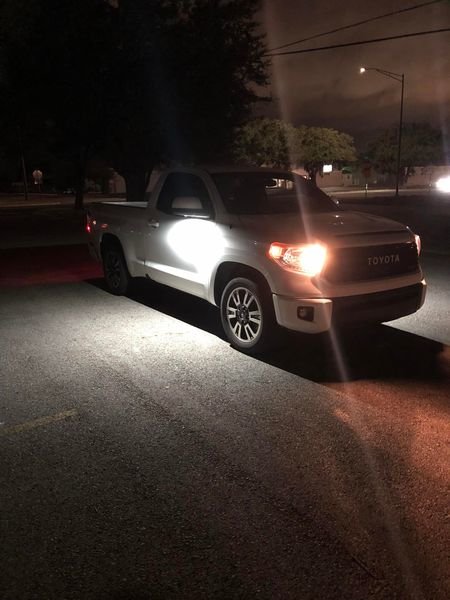

    Also took a minute to finish wiring in the VLED puddle lights I installed in the bottom of the mirrors. They are wired to the cargo light circuit and will come one with the key fob ect. Very bright at night.
    Will soon be adding new LED TRD Pro headlights and fog lights up front.

    VLED Interior VLED Cargo Light VLED Reverse Light Driverside Grab Handle Bilstein 5100 front 2nd setting TRD Dual Exhaust Black Chrome AJT Chrome Delete TRD Air Filter Tyger Side Steps TVD Vinyl Decals MGM Tundra Radio Decals TVD Vinyl Decals MGM Tailgate Handle Decals Tundra Tailgate Badge Chrome Moto Metal 970 wheels 275/70/18 KO2 Tires TRD Rear Sway Bar MGM Door Handles and Mirror Caps TRD Pro LED Black Housing Headlights Black Housing LED Fog Lights AJT Black Door Handles AJT Black Steering Wheel Controls Tacoma Leather Steering Wheel Pedal Commander TRD Pro Hood Scoop 12 Volt Solutions Remote Start Clazzio Leather Seat Covers

    1st tundra nautical blue 4x4 5.7l DC TRD had oracle custom color shift halo projector headlights, Fab4 bumper with 12k winch. RBP RX3 Grill Pro Comp stage 1 with bilstein 6112 coil overs SPC UCAs BFG KM3 35x12.5x20 with Moto metal 959s NFab running boards TRD LED DRL pioneer avh 4200nex with Polk speakers and JL 600w amp with JL audio stealth box 196k miles and running strong ready for another 200k until I wrecked it on 2/26/21 Just bought 2018 CM 4x4 5.7l quicksand TRD package upgraded headlights and adaptive CC Trifold bed cover, blacked out badges, KMC wheels BFG KO2 tires, 3/1 pro Comp lift FAB4 front bumper with rigid lights and fab4rear bumper.
    Amazing work. The new LED headlights will really take this up another notch
