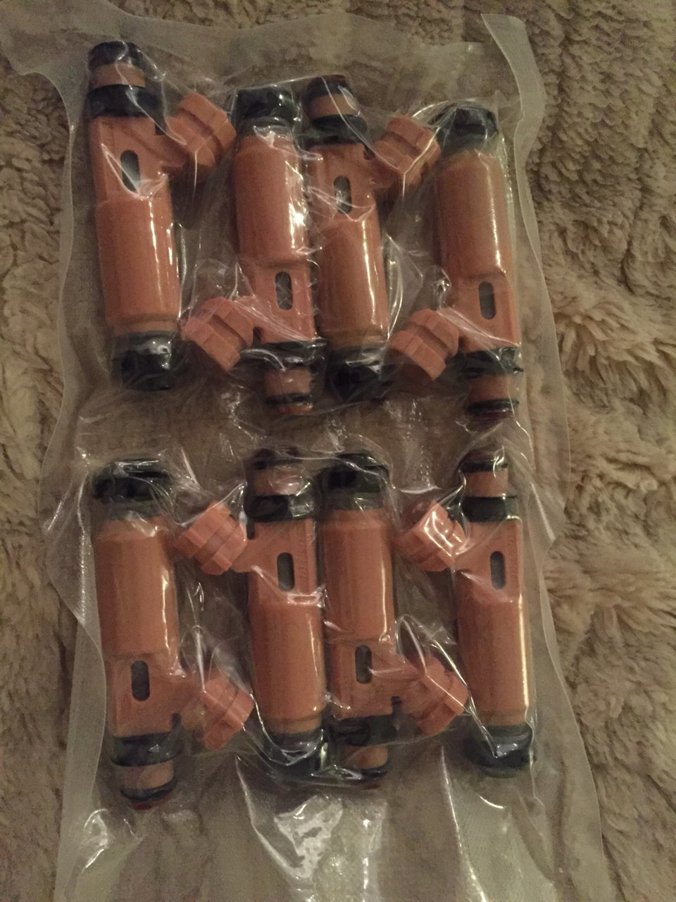

    Performance enhancement was up next once the total truck shake down dust settled and the prior mechanical work was making a huge positive difference.
    12 Hole Injector Upgrade using Denso 250cc type. This modification came about from wanting to see if the old injectors were an MPG hog due to age. Figured I’d buy this set of 250cc reman’d injectors as they were very cost effective OEM replacements that made the truck better. Enhancements from the mod were better shifting points, gears holding longer, and noticeable downshifting on deceleration. MPG slightly improved, but negligible. A very nice modification and highly recommended.

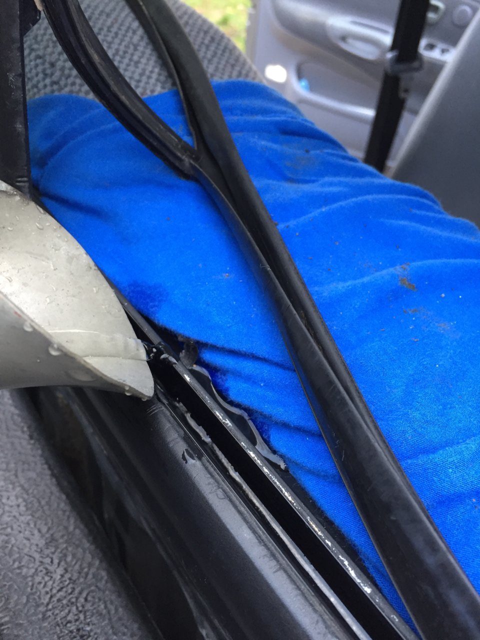

    Leak Repairs
    Rear Slider window gasket clean up to fix the leaks everyone sees in the floorboard corners and are mistaken for ‘3rd Brake Light’ leaks. In my case, the rubber slider gasket drain ports became clogged both on the gasket and underlying truck body frame. A simple clean up and poking out the holes frees up the draining process. The water should exit out the rear bottom gasket flange.
