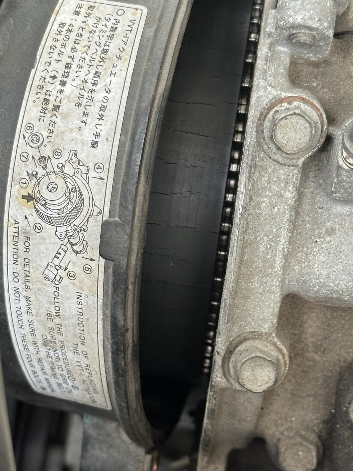

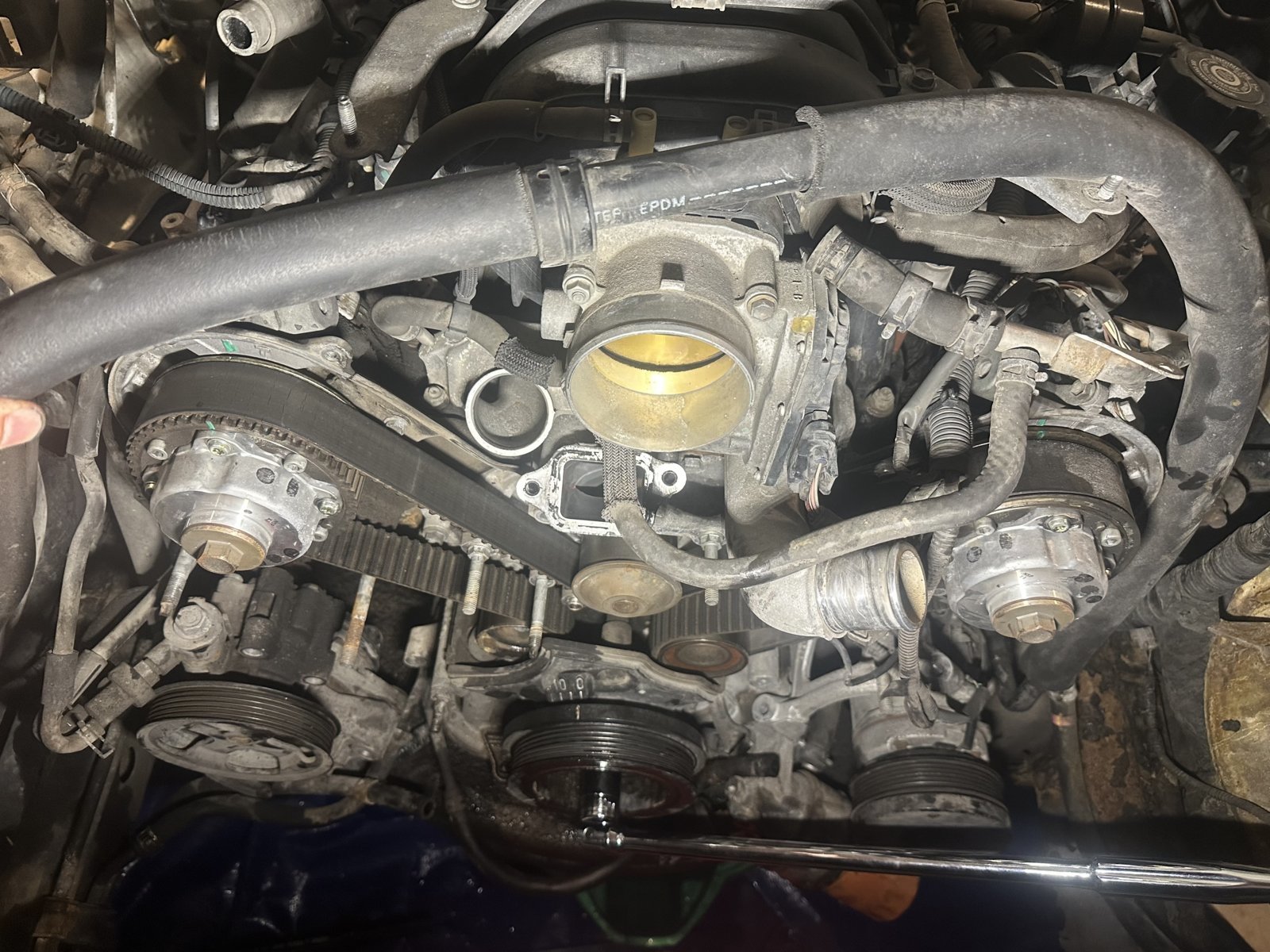

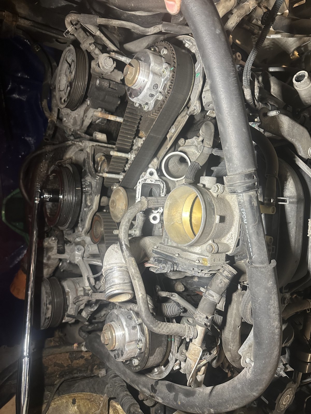

    Ok so I’ve tore it all apart exempt pulling the water pump and the belt.
    the timing marks on the camshafts pretty well line up. But the crankshaft shows a 2* off?

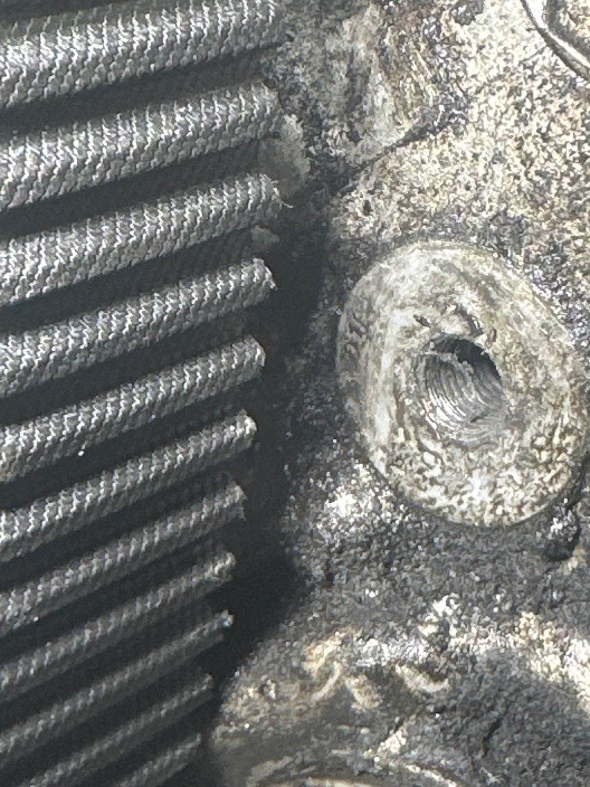

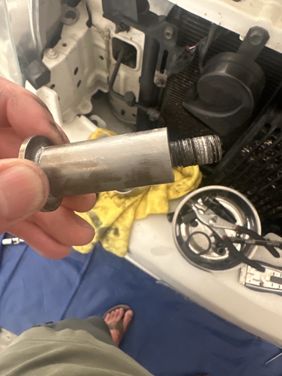

    Well, I royally fucked up. I forgot to Torque the timing belt tensioner mounting bolt until after I released the tensioner. When I tried to keep tightening it, it just kept spinning, so I thought that was wrong and I removed the tensioner only to find out that I stripped the bolt‍♂️‍♂️‍♂️‍♂️
    i’m realizing because it was under tension that’s why it stripped.
    what can I do to fix this?? Obviously, I can tap the hole to a bigger size, but I don’t know about the bolt. Or I could JB weld the bolt in there and never replace the swivel assembly.. I could still replace the tensioner and bearing when I replace the belt again.

  19. Jul 12, 2024 at 4:18 PM
    #79
    MTPatrick
    MTPatrick [OP] New Member
    Jul 5, 2024
    #119441
    35
    Patrick
    SW Montana
    2006 Tundra DC 4X4 Limited
    It looks like the part that it bolts into can be replaced, but I don’t know if that’s something I can do from the front side of the engine or if I would have to pull the engine to do that??
  20. Jul 12, 2024 at 4:38 PM
    #80
    assassin10000
    assassin10000 New Member
    Oct 27, 2020
    #54157
    2,201
    Andrew
    Northern CA
    '05 SR5 AC
    Heli-coil it.

  21. Jul 12, 2024 at 4:42 PM

    Never heard of that. Looks like what it mounts to is the oil pump body. I could replace this with an AISIN for $66 plus shipping from rock auto. I'm just curious how difficult that is to replace..

    I'll try to helicoil does anyone know what thread size it is?

    Have you tried to retap it with a thread chase? Not sure how boogered it is. If the threads can be salvaged, that’s better than Heli-coil. But Heli-coil is a solid option otherwise.

    I ended up doing the Heli coil. I was concerned that the threads were too buggered.

    For future reference a little more expensive but a timesert is probably the better option. Good work on it!
