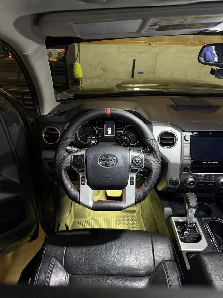

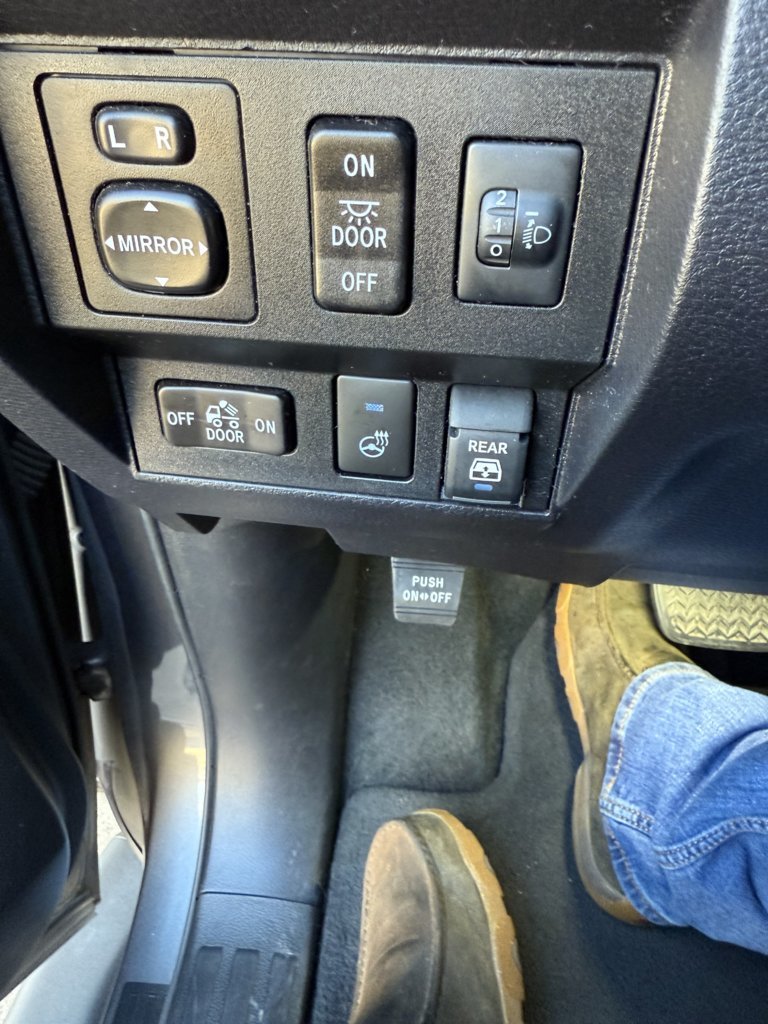

  15. Jan 5, 2025 at 12:48 PM
    #105
    Abell207
    Abell207 New Member
    Aug 24, 2020
    #51252
    244
    Anthony
    Maine
    2020 Army Green TRD PRO
    Got mine installed today, I used the spot where the auto high beams are for the heated switch. I never use that button so made sense for me. IMG_0425.jpg IMG_0421.jpg
  16. Jan 5, 2025 at 1:25 PM
    #106
    woods
    woods New Member
    Jun 22, 2021
    #64625
    846
    2021 SR5 TRD Sport
    did you just leave the auto high beam switch behind the dash?
    Rdrcr and bulldog93 like this.
  17. Jan 5, 2025 at 1:28 PM
    #107
    Abell207
    Abell207 New Member
    Aug 24, 2020
    #51252
    244
    Anthony
    Maine
  18. Jan 6, 2025 at 9:17 AM
    #108
    lerbud1
    lerbud1 New Member
    Feb 26, 2023
    #92779
    91
    Larry
    Waco, TX
    2021 Tundra SR5
    Got my steering wheel kit today. Opened the box and my clock spring clip was not attached. I watched the video and got it centered. I used some tape and the clip so it wont move. Hopefully when it warms up again I can get it installed.

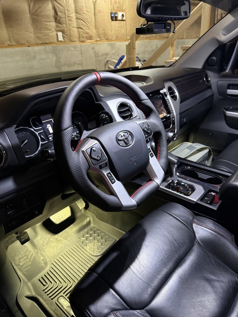

  19. Jan 12, 2025 at 9:29 AM
    #109
    lerbud1
    lerbud1 New Member
    Feb 26, 2023
    #92779
    91
    Larry
    Waco, TX
    2021 Tundra SR5
    Got mine installed today. Man was I nervous messing with the clock spring! Got it done and it works! IMG_0317.jpg IMG_0318.jpg
  20. Jan 12, 2025 at 9:36 AM
    #110
    Abell207
    Abell207 New Member
    Aug 24, 2020
    #51252
    244
    Anthony
    Maine
    Did you also put your auto high beam behind the dash?
    Rdrcr and woods like this.
  21. Jan 12, 2025 at 9:49 AM
    #111
    lerbud1
    lerbud1 New Member
    Feb 26, 2023
    #92779
    91
    Larry
    Waco, TX
    2021 Tundra SR5
    Yes i did. Seemed the easiest way to find a spot for the switch.
