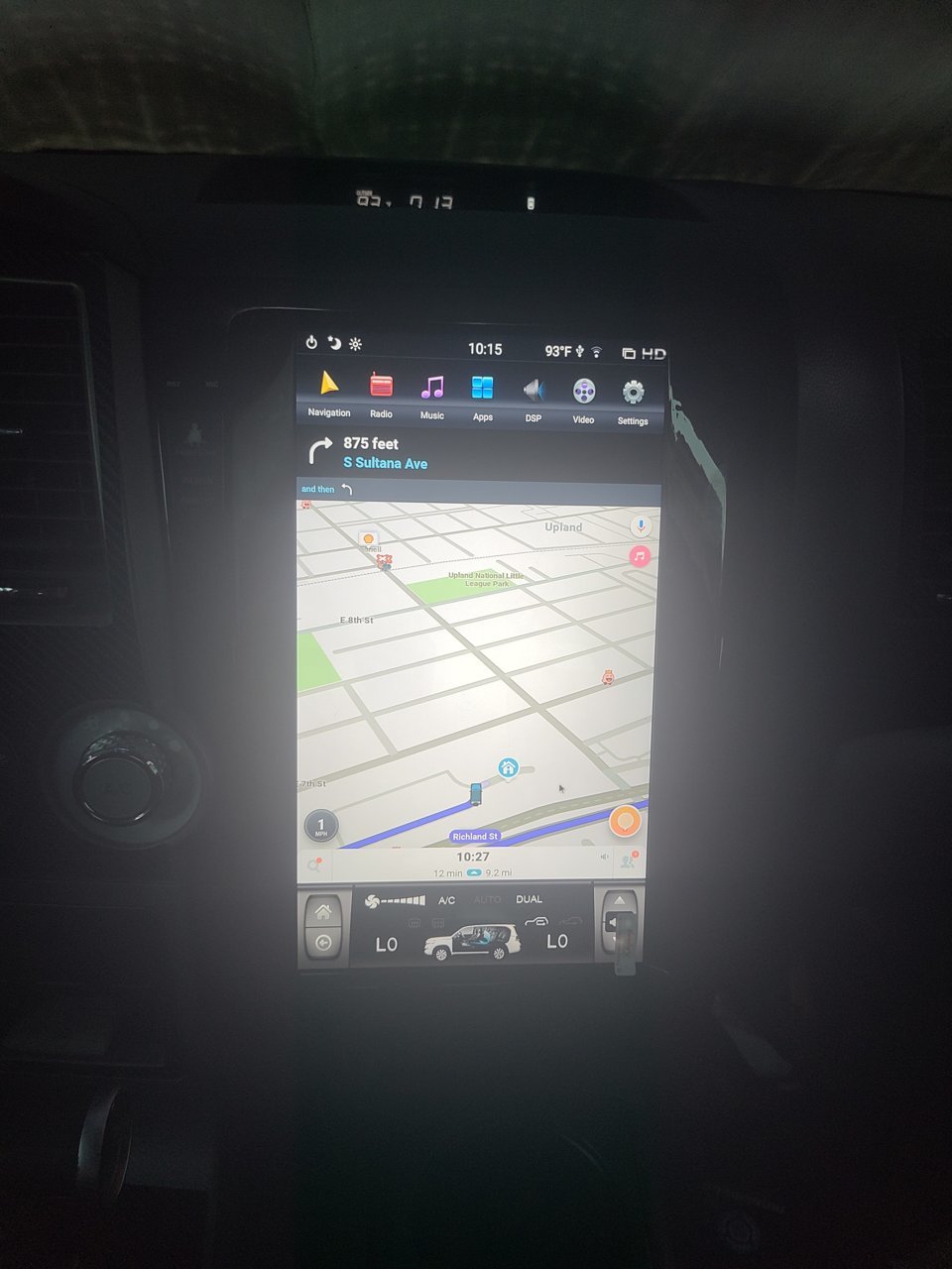

    Hello Tundra brothers I'm hoping someone on here can help me out. I just purchased and Installed a tesla style head unit on my 2012 Tundra. I have ran Into a problem with install I have some engine noise when I drive and my battery meter shows that it is draining the battery when idling, when driving it goes towards the middle but still not where it should be. As far as I can tell everything is connected correctly. Have any of you installed one of these and had similar problems that you were able to solve? My local shop I usually go to won't mess with it cause there is no instructions with it. Another shop quoted me $750 to install it, there is no way I will pay $750.

    well for one it'd be nice to include a picture/model or more information about the headunit. If no instructions came with it I'm sure it's a cheap chinese knockoff and the engine noise just may be a side effect of the low quality of it. Also, one thing to check would be any wires you had to tap into, or use butt connectors and the likes. Soldering connections is more time consuming but will assure you have good solid connections and minimize any engine noise/loose connection issue most of the time.

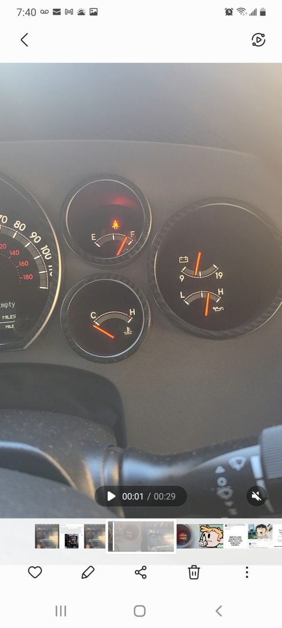

    I'm more concerned about the battery issue I'm going on long trip and the last thing I need is to get stranded with a dead battery in Laughlin when it's 120 degrees out

  12. Jun 14, 2021 at 7:41 PM
    Froggmann
    Froggmann [OP] New Member
    Oct 17, 2018
    #20682
    17
    2012 Black Tundra 4x4 Platinum
  13. Jun 14, 2021 at 7:45 PM
    Froggmann
    Oct 17, 2018
    #20682
    17
    @RdKing what do you mean swap it hot? My battery is good only a few months old Interstate specifically for trucks with lots of accessories.
  14. Jun 14, 2021 at 7:47 PM
    RdKing
    RdKing Not A Roll Model
    Jan 6, 2020
    #40831
    526
    Rich
    Eastern Seaboard
    2019 Tundra Platinum 3R3 / Barcelona Red
    Roadtunes By: Taylor's Audio/Tech12Volts Alma GA. JBL Complete System
    Coincidence
    I’d tap a test meter on your battery and see if it’s charging

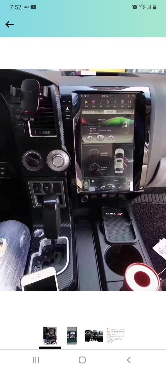

  17. Jun 14, 2021 at 7:56 PM
    Froggmann
    Oct 17, 2018
    #20682
    17
    @CodyP this is what it looks like I got it from Amazon it says the brand is lucky china definitely not something I was happy about I usually go with Alpine, Kenwood or Pioneer for head units but they don't make anything remotely close to this it looks really good in the truck I love my truck but the head unit and interior are definitely a little dated so I wanted to give it a makeover Screenshot_20210614-195219_Amazon Shopping.jpg

  18. Jun 14, 2021 at 8:57 PM
    Jego
    Jego New Member
    Jan 17, 2021
    #57757
    341
    Orlando
    PR
    2018 Tundra 1794

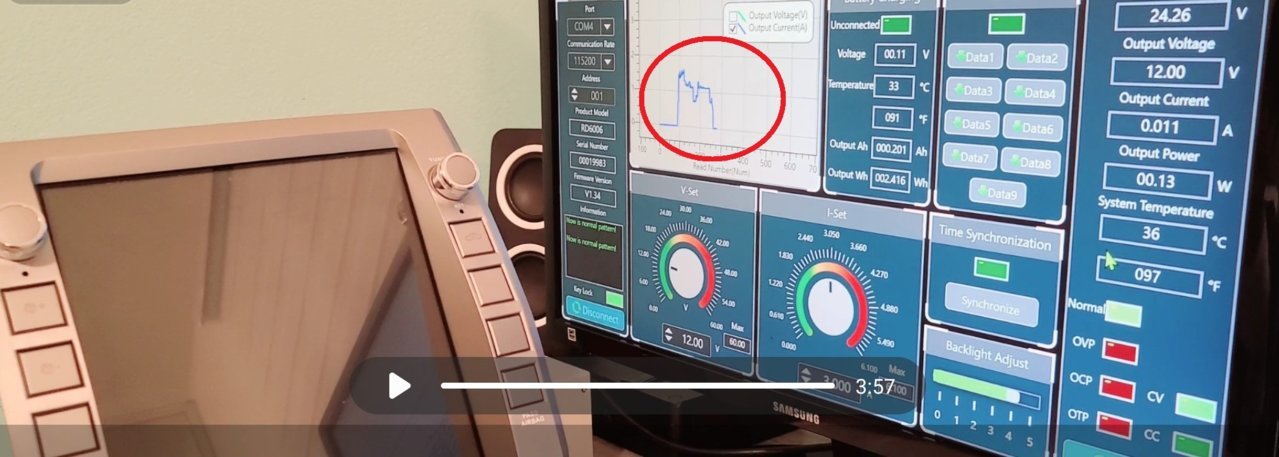

    I have 2018 1794 Ed. with JBL system. It sounds very good but no cool features. I have been looking into these tesla styles radios for a couple of months but too expensive considering the QA. I recently decided to give it a try because I found a less expensive version with Android 9. Got it for 471 shipped to my door. I haven't installed because I actually doing some tests. The first thing I tested was the power management to make sure it doesn't drain the battery.
    So this is what I did.
    I connected the unit to a power supply and monitored the amps/watts consumption in different scenarios.
    Case 1: Connected to Power Supply (Battery), Ignition switch on, normal use -> Consumption 1.3 amps
    Case 2: Connected to Power Supply (Battery), Ignition switch on, idle (Not using it) -> Consumption 0.7 amps
    Case 3: Connected to Power Supply (Battery), Ignition switch OFF, Unit OFF Fast Boot Enabled -> Consumption 0.011 amp
    Notes: these scenarios were simulated using a 12v power supply.
    So the case 3 is the more critical because the truck is off. For me 0.011 Amp is acceptable.
    In your case maybe the ignition wire is connected to a constant power source? That will prevent the unit to switch into a less power consumption mode? That will cause similar results as my Case 2 instead of case 3 above. In my unit a yellow cable is connected to the battery directly and the red cable is connected to the ignition/accessories circuit.
    I hope it helps!
  19. Jun 14, 2021 at 9:09 PM
    Froggmann
    Oct 17, 2018
    #20682
    17
    @Jego Definitely will look into that scenario maybe that's what's going on.

  21. Sep 18, 2021 at 9:02 AM
    Froggmann
    Oct 17, 2018
    #20682
    17
    Update: So it turned out that my alternator went out. That's what was causing the battery drain. As far as the engine noise i just tightened my grounds and that did the trick thank you all for your feedback and suggestions.
