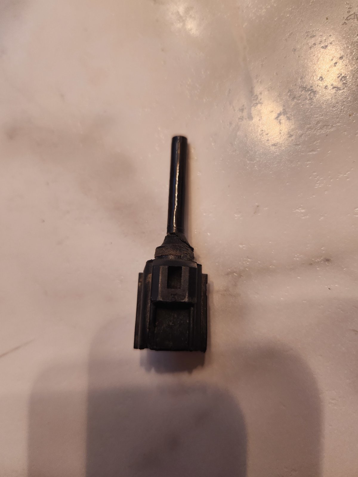

    2002 Tundra started misfiring and threw a p0125 code. The temp sensor I removed was broken and bought a new one. I was surprised to see the OEM sensor I bought was different than the one I removed. The one I removed was plastic while the OEM was metal. Furthermore, the OEM sensor does not fit in the wiring harness and I am having trouble tracking down the sensor that I pulled. Anyone seen a plastic temp sensor like this before?

    Comparing the two

    My apologies for the lack of information. It is a v8 and the plug was pulled from.where you stated: passenger side throttle bottle and it is the front ofnthe two sensors. When I pulled it, it was obvious to see it failed as the plastic is completely cracked.

    In that case, it looks almost like you pulled the temp sender out of its brass housing?! Do you see the brass housing is still intact on the block?
    If it's the black one, that should be for your gauge, not your ECU.

    I will go take a pic of where I pulled it. Not sure I saw the brass come off woth it.

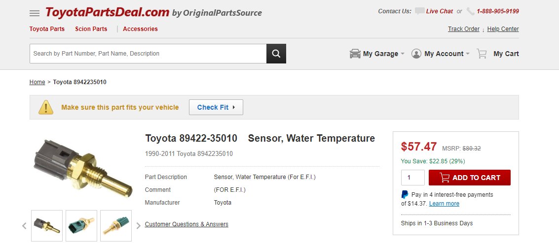

    Yeah, I think you got the wrong part number on this one? See part numbers I posted. I think the one you pictured is maybe for the V6? I'm not 100% certain on that.
    If you can PM me your VIN I can confirm part numbers for you. Or you can just look it up on your own using the parts lookup thread, the bulleted points at the top here: https://www.tundras.com/threads/howto-use-the-toyota-parts-system-to-find-order-parts.113808/
    Even TPD is showing different part picture.

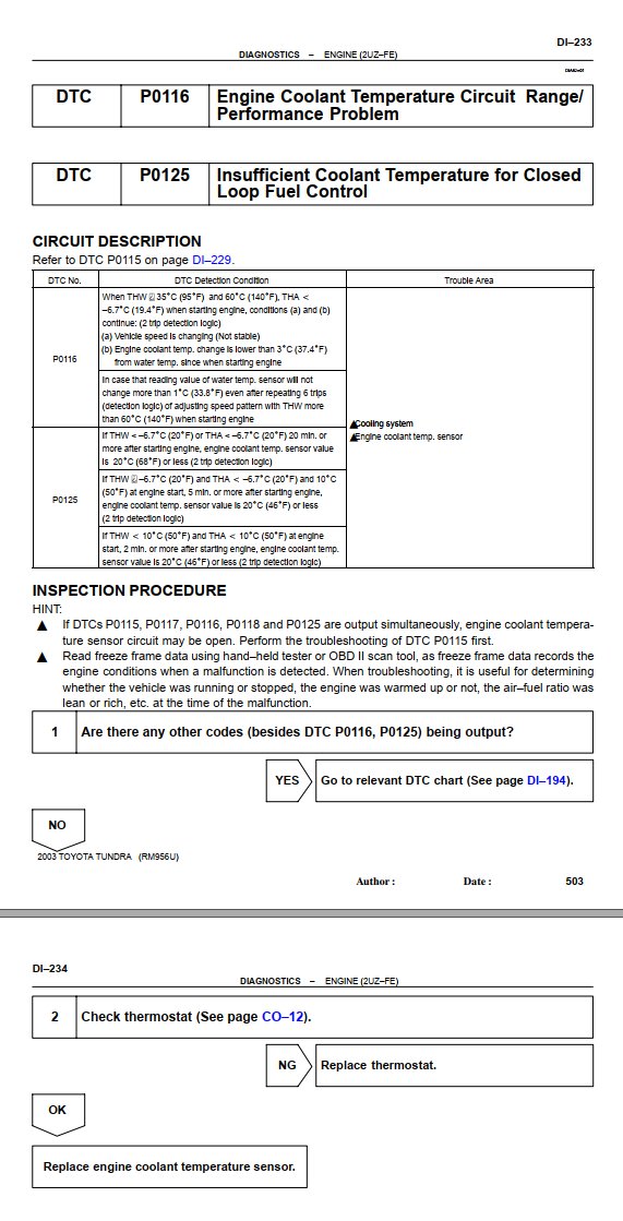

    Oh, and just because it's something that should be asked ... are you certain your t-stat isn't stuck open? I'm still also stumbling on the misfire thing, I don't think this should cause a misfire, but that's another story.
    According to the FSM, which is readily available for download, p0125 is one of those cases where:
    • If the ECU temp sensor (green one, not the dash gauge sender) is bad, it will often throw additional codes (P0116, P0117, P0115)
    • If you're not getting additional codes, it's probable your thermostat is stuck open and not letting the engine warm up sufficiently

    I looked up the number you gave me and it said it will not fit my truck and directed me to the sensor I bought. Weird part is I just found the brass top you mentioned (thank you) and it has a part number on it that does compute with toyota: 39422-30030. So tracking that down now.
