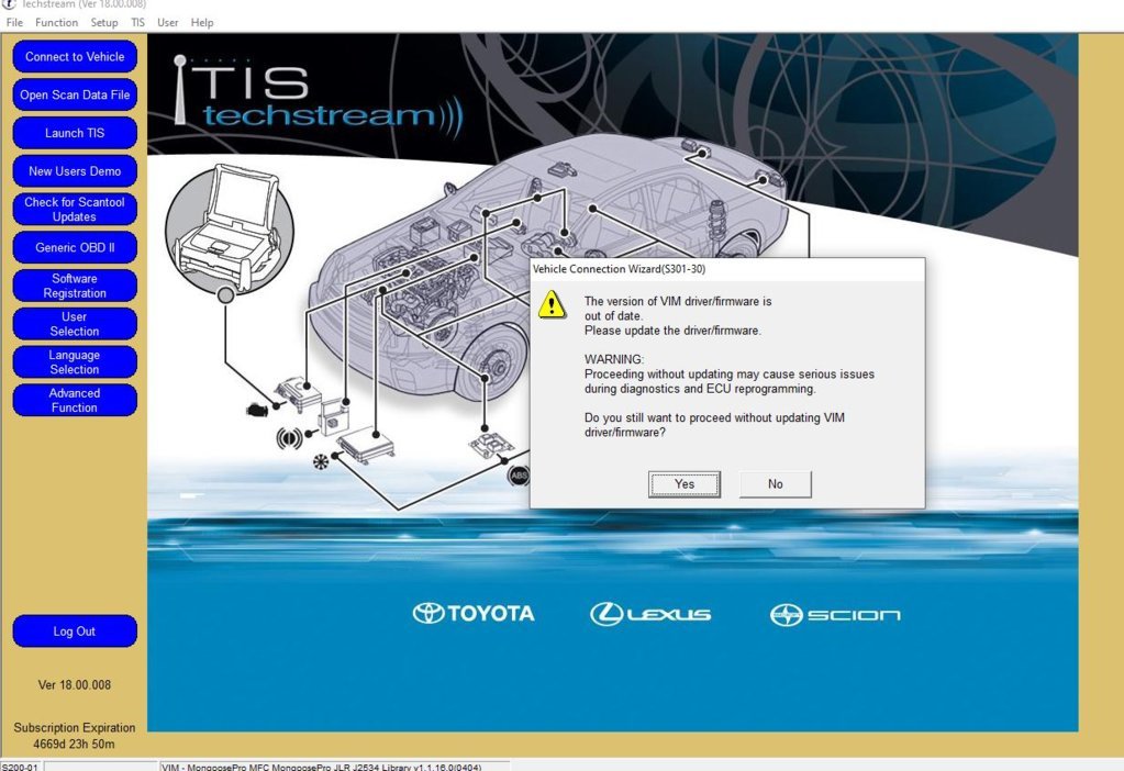

    So I got this just for the hell of it, shipping was like superfast. Did you get this error when you started your TIS?

    I think I've got that warning. I clicked ok and ran it.
    Techstream can't do anything until you get into specific ECU's.

    Actually I watched the video and he gets the same error. Good to go I guess. So yeah this Mongose clone works pretty well, good driver install as well.
