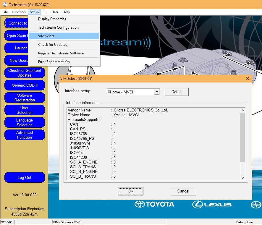

    What is message when not connecting ?
    Did you select the correct driver.....Setup/VIM Select/XHorse

    No message. I did put as Europe not sur if that smacks a difference. I did look at my device driver and it's yellow.
