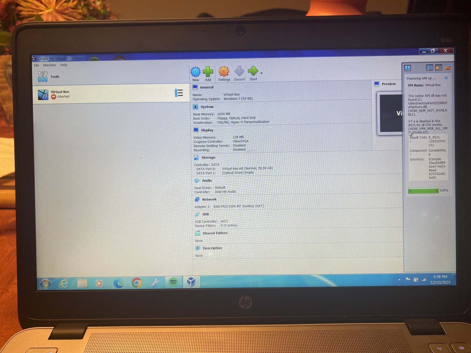

    Examples of troubles:
    trying to open up a virtual box. Got it downloaded and try to start a new screen. Can’t get past here:

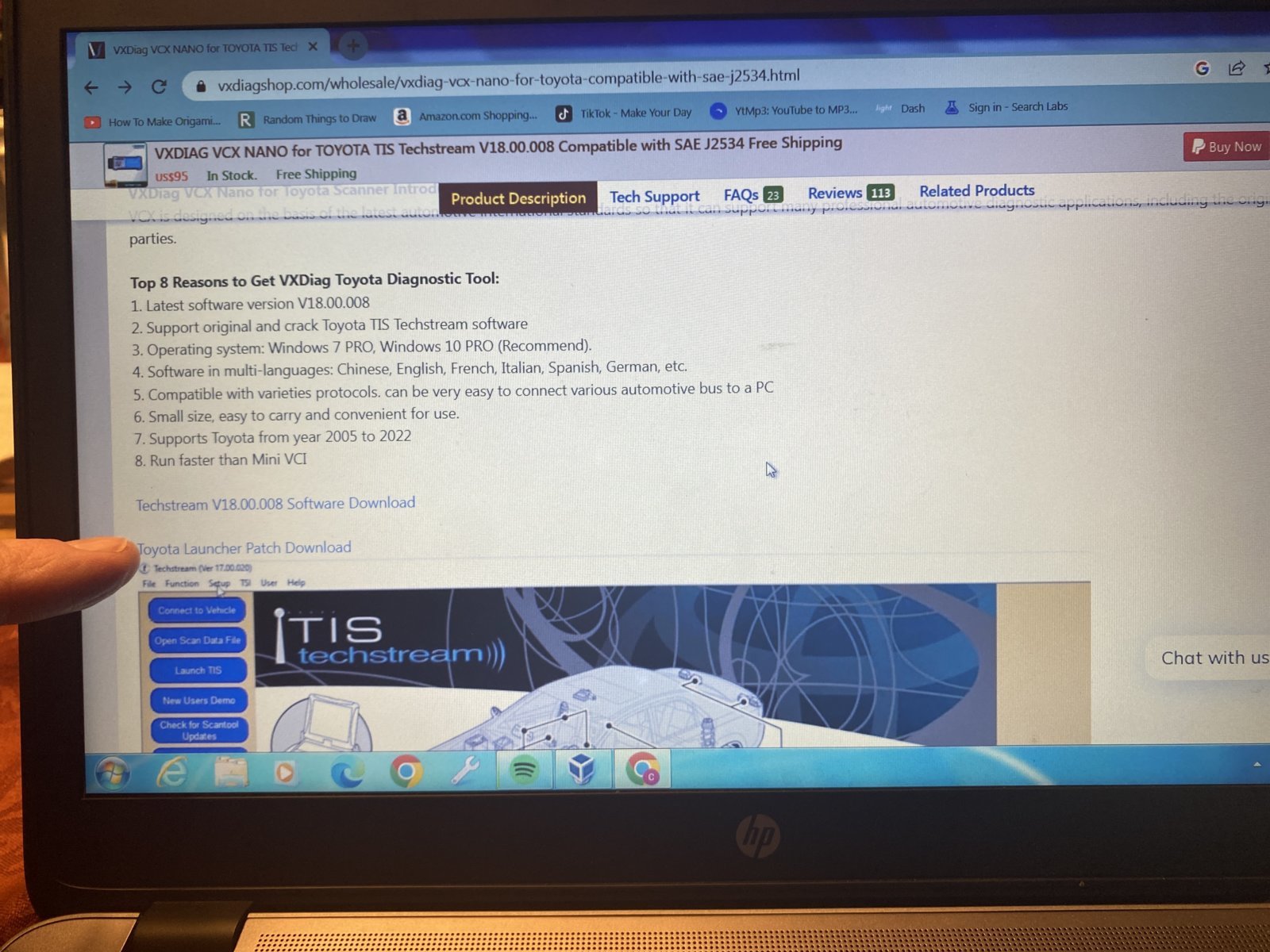

    My troubles have been narrowed down to a bad patch link. VXDIAG sent a new link, which had also expired.
    Trying another route, I made an offer on some eBay shop for Techstream with a login key, but he blocked me when declining my offer. Rumor has it that another member here had offered the same with success, but it’s not enough now! I messaged the seller to unblock me for full price.
    Hoping to either have a patch that works or a sale from eBay today. Yeesh. Why can’t things just work the way they’re advertised?

    I only need the patch that was supposed to come with the Nano from VXDIAG. waiting for a response after the second one was expired and couldn’t download.

    Why are you using VirtualBox in a windows laptop? Can't you do a straight install in windows OS? Now I am confused
  16. Dec 11, 2023 at 8:53 PM
    #46
    Chad D.
    Chad D. New Member
    Feb 12, 2019
    #26010
    1,525
    Western Oregon
    2018 CrewMax Platinum
    That’s a good question. I’ve heard so many opinions and “sure-fire” fixes, it feels like I’m working with gypsies! lol.
    To be fair, I haven’t used the virtual box. Can’t get it to work…
    Currently waiting for Vxdiag to respond via WhatsApp. He emailed me another dead link for the patch about 15 minutes ago. Swears he can make it work via WhatsApp…

    Wait for VXDIAG to actually get me a patch that isn’t expired so I can use the software I already have downloaded and installed.

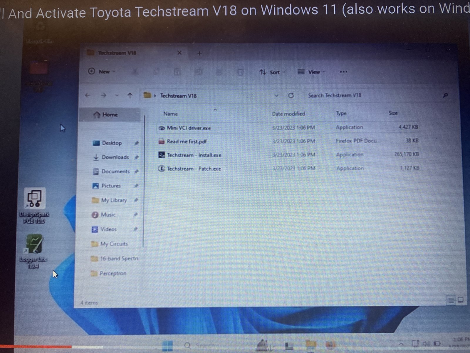

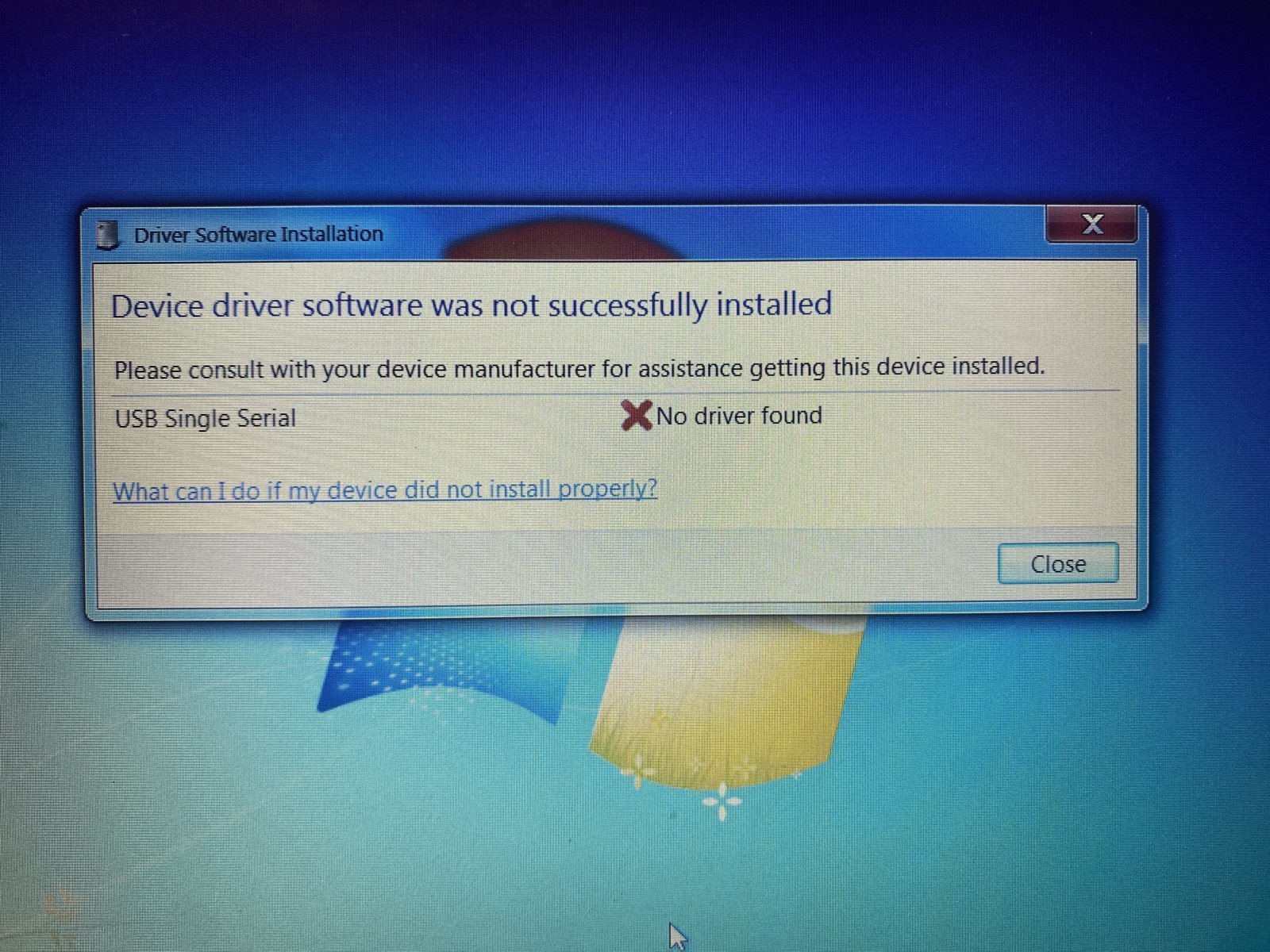

    Looking at your post history I think you have everything you need. For some reason your driver for the nano didn't install and TIS can't see the open port.
    Try it again and leverage this video, it will help you with the steps which are very similar
    https://www.youtube.com/watch?v=oQjoQTO09fI

    The patch is all I’m missing, and vxdiag sent me another link last night via WhatsApp. If that works, I’m in.

    I just downloaded the patch from their device link. It worked for me. Is only 7 megs and I can email it to you? Make sure to disable antivirus when you do all this work.

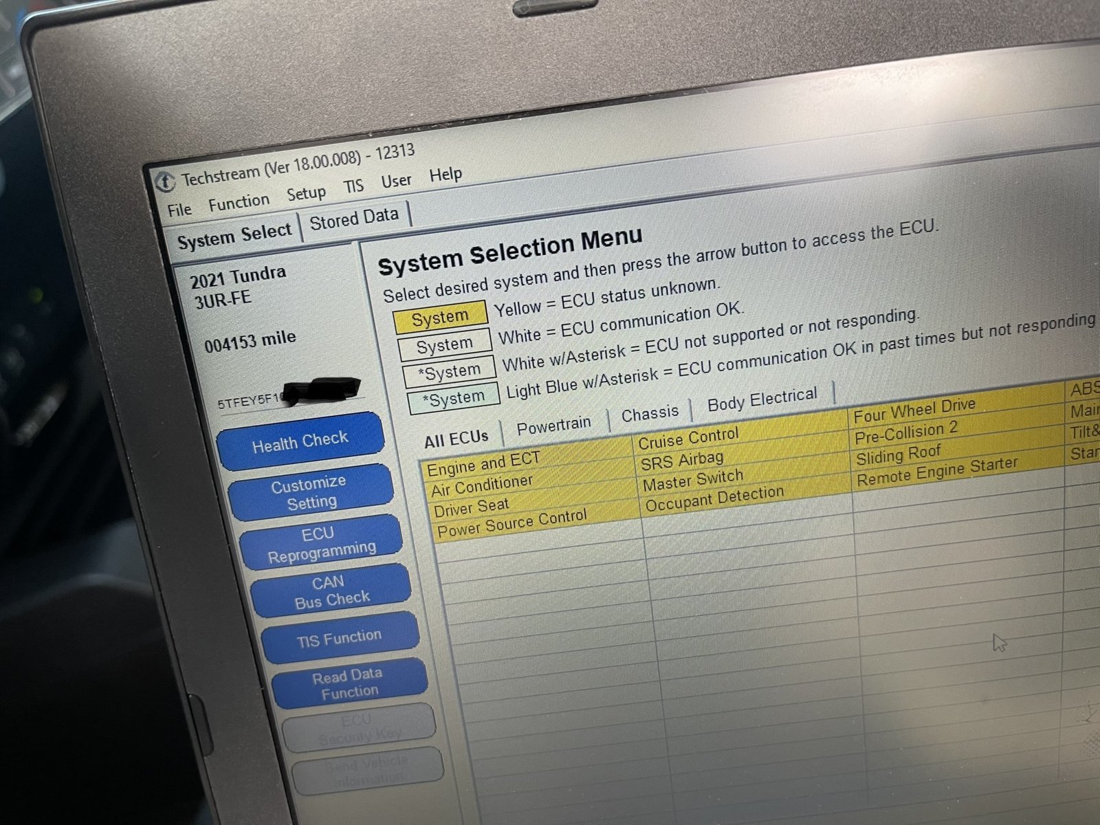

    the folks at VXDIAG logged in remotely and I’m all dialed. Working on little things now in the truck.

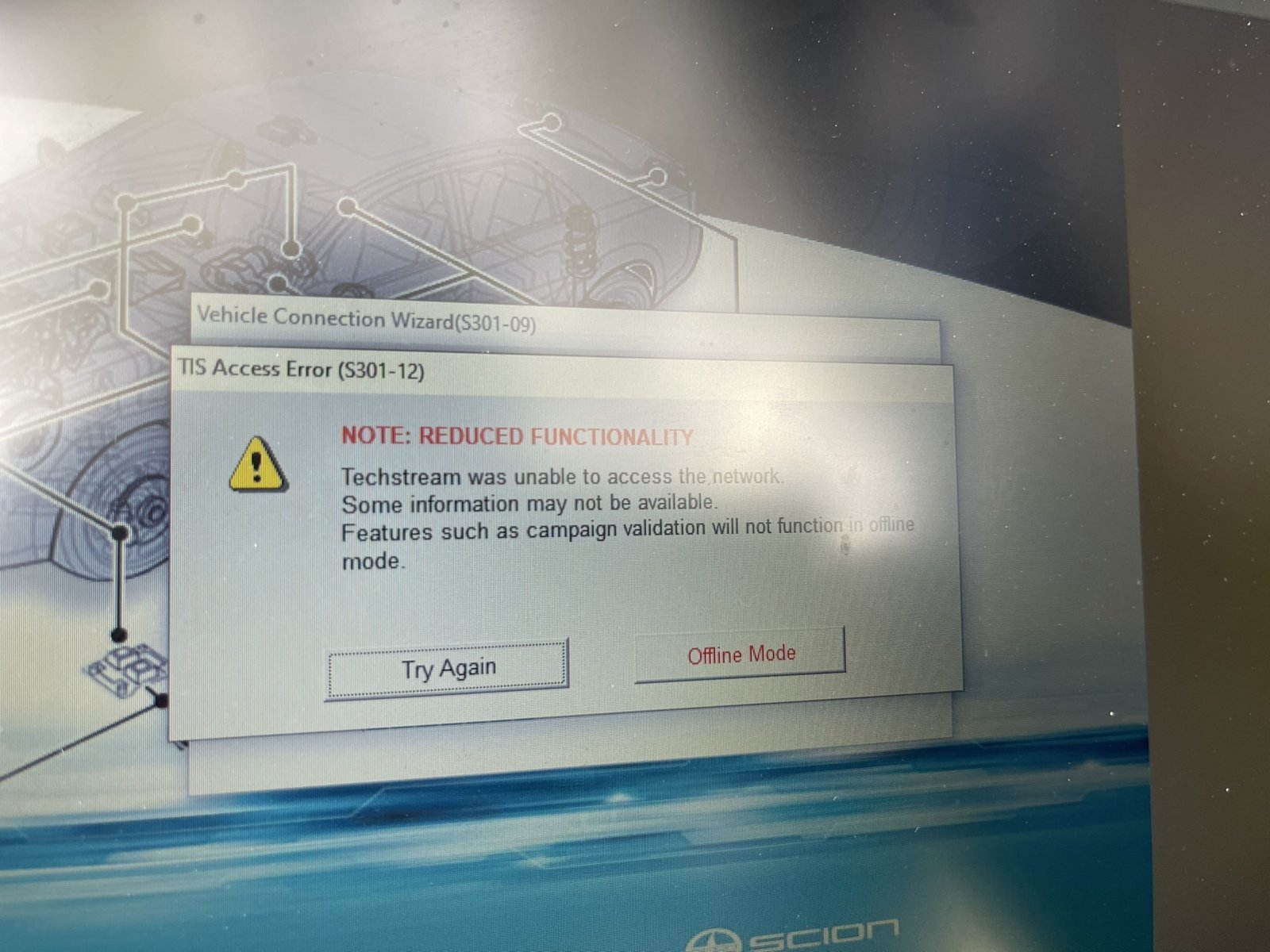

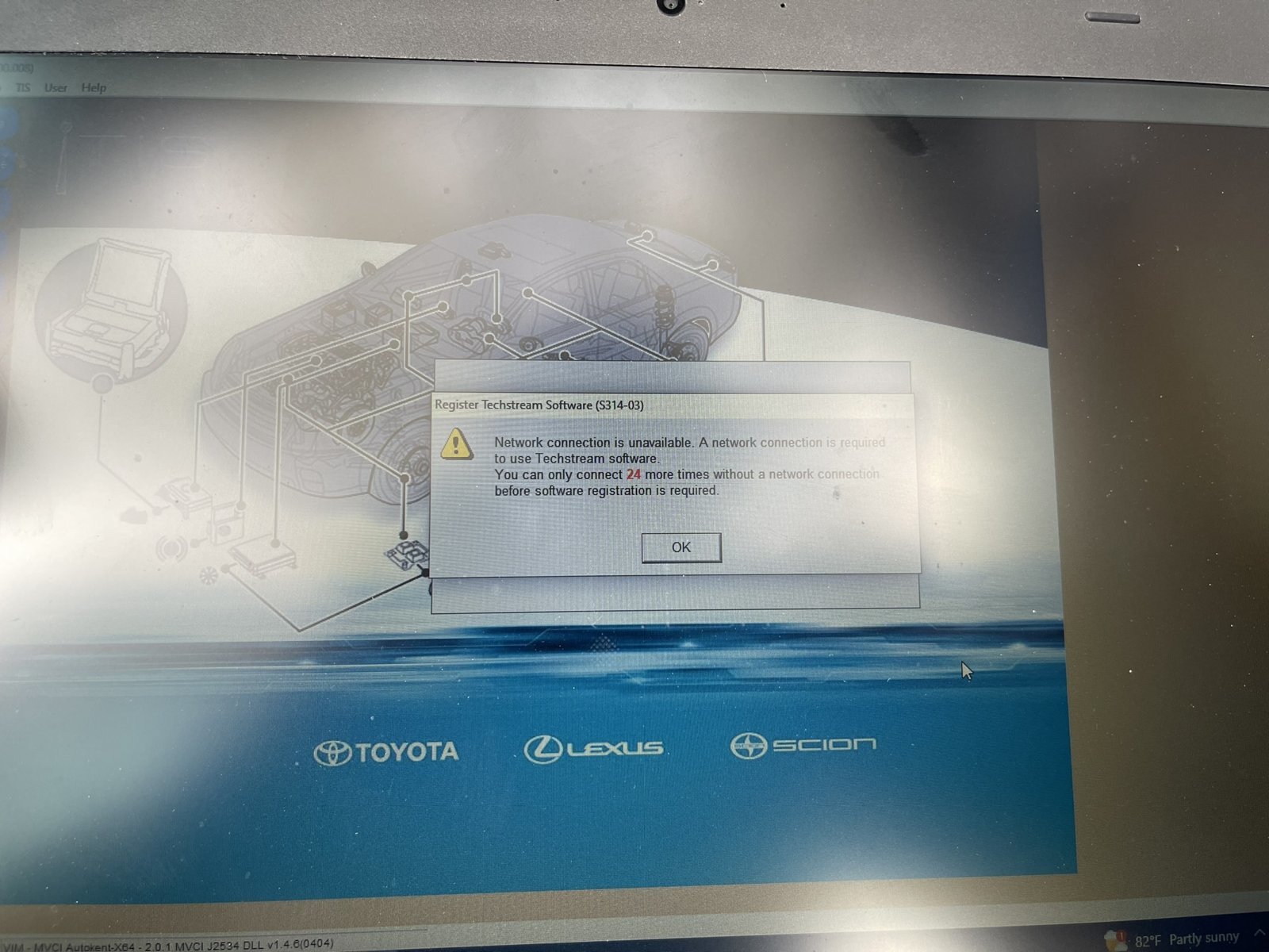

    So I got my Techstream 18 running but when I connect to the truck I get this 2 errors? Is this normal? It connects fine if I go offline. Do I need to be on a wireless network for this to work?
    1. Network connection unavailable, you have so many try bla bla, like 24 try, se attached picture
    2. REDUCED FUNCTIONALITY -Techstream was unable to access the network. - Some information may not be available. Go Offline Mode

    Normal when your not connected online. Techstream wants to contact mother Toyota to access TIS. If you choose offline mode it works fine but techstream can't check for calibration module updates. In your case you can connect 23 more times then you will have to go online then the countdown starts again.

    Did you install the driver for VCXNano and set it up properly under Techstream settings? Make sure it points to the the right device / driver in TIS.
