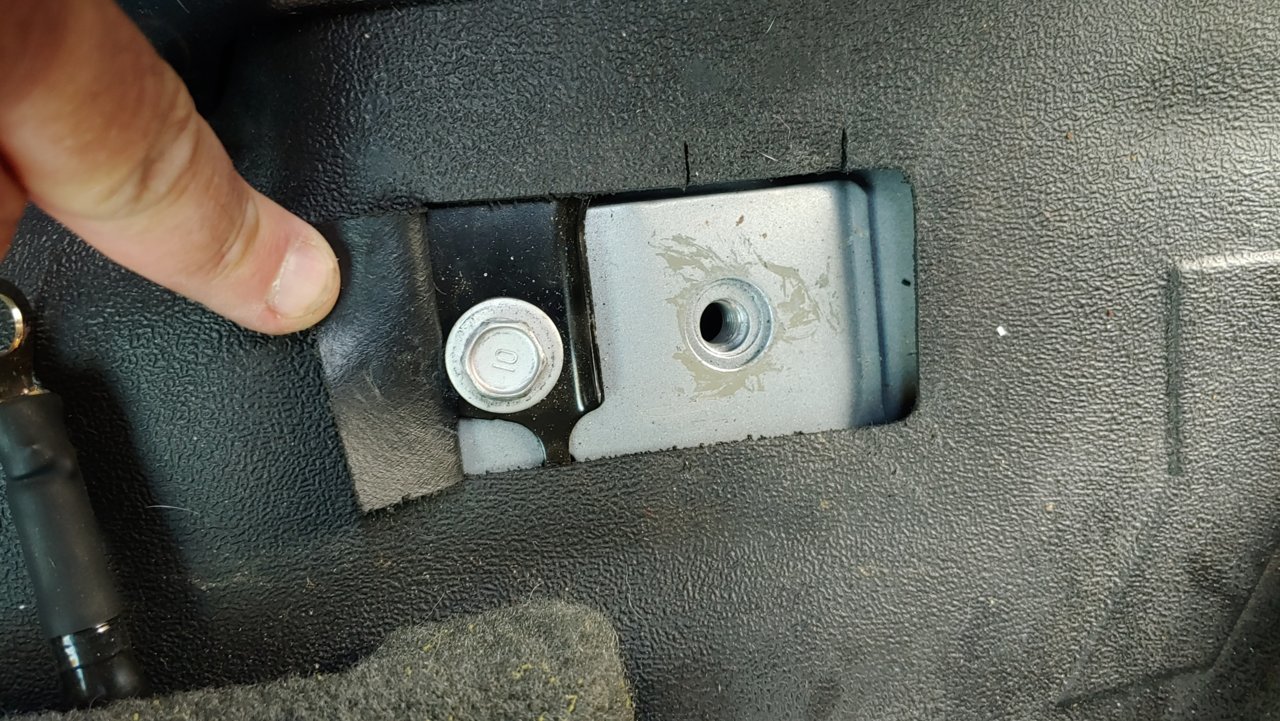

    20201213_153444.jpg 20201213_153453_HDR.jpg In other news, is this a good place to attach the ground for the amp?

    That spot will be ok for ground. Just sand off the paint first.

    There is a Factory ground spot with bolt and wire on the passenger side. Under the carpet where i circled in red. You'll have to pull the carpet up to see it.
    If you are setting your amp under the passenger seat then use this point.

    He is correct the stock AMP also had a ground on the front ledge, I just opted to utilize one of the stock bolt downs for the stock AMP to manage how my wires would run.

    I will look when I get home. Keep in mind that I did not have a factory amp installed, this was the most basic truck.

    There would be a pre-drilled hole there even if you didn't have the factory amp.

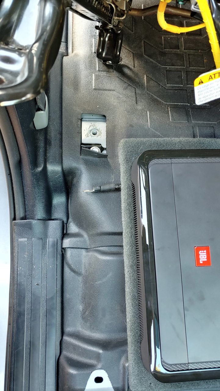

    No bolt there, however to make it easier on me, I chose a more accessible spot. I put on a wire brush on my drill, cleaned off paint to the metal, drilled a hole and sunk a screw there. Works great.

    I chose an easy spot to get to between the passenger seat and door, ground away the paint, drilled a small hole smaller that the screw, then drove it in. Nate metal meets the neg wire

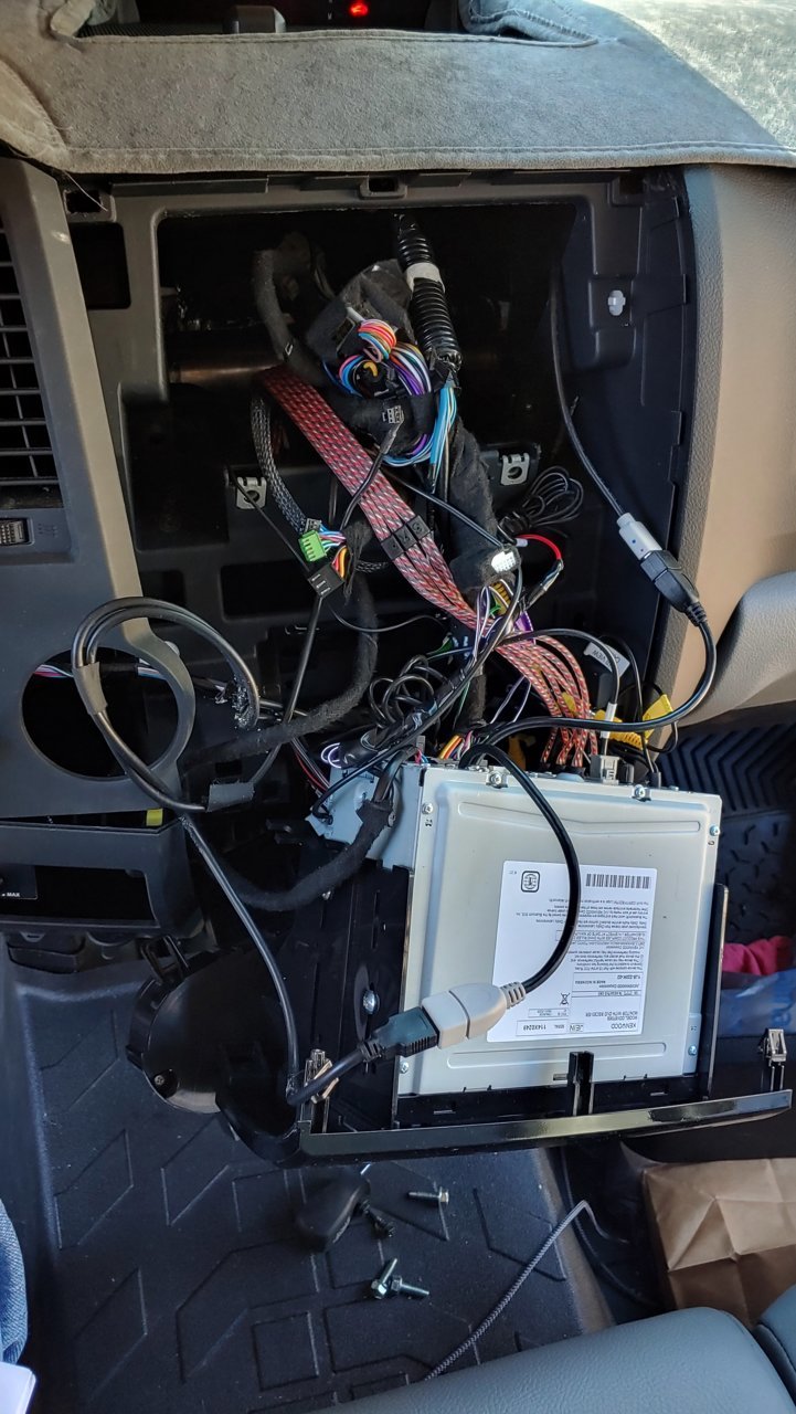

    I had to pull it all open again. My maestro wasn't working and my front usb wasn't working either.
    I didn't hook up two plugs on the maestro, duh. And I switched the usb so it works now.
