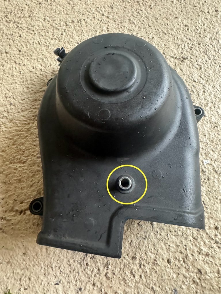

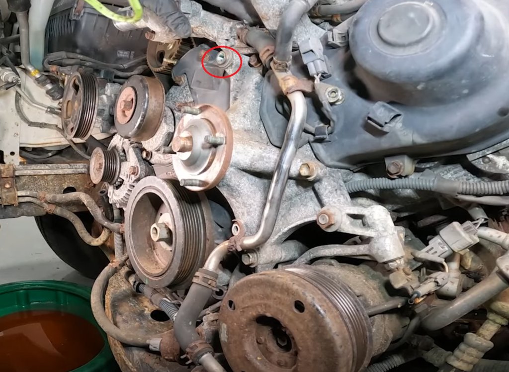

    Looks like one of the reinforcement spacers in the plastic covers, to prevent them from crushing/splitting when you (over)tighten the 10mm bolts.

    I had considered that as well. I seem to recall that somewhere.
    I thought I saw something like that not what I would call an ideal design.

    Those spacers should be pressed into the plastic covers unless the plastic is cracked or deteriorated.

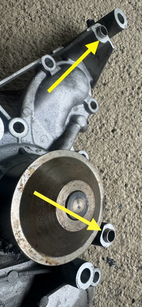

    Yup. That's it. I was flipping through an install video looking for stuff and noticed that.
    I also noticed the fan bracket almost appears to have a pressed spacer in it with similar OD/ID, but I see no way it could potentially come out. Clearly what you have is from the timing cover. Looks like you're gonna be tearing down and a bit there, friend :rofl:

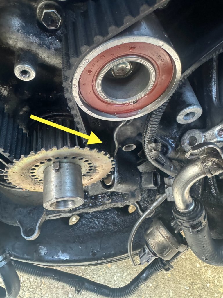

    i'm definitely tearing it down all the way
    I believe that particular one is on the fan bracket:

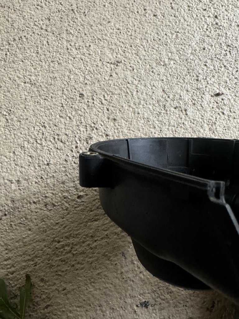

    Most of the tension keeping those bushing spacers in the cam pulley cover is gone if they crack like this one.

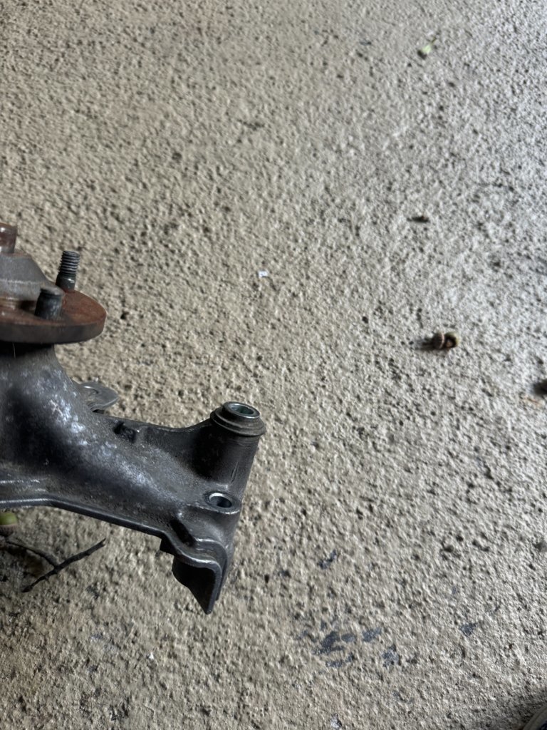

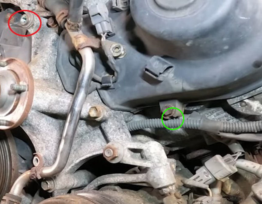

    Was the center one from both the driver and passenger side cover. I had already found the other one
    plastic is not cracked or worn other than just being 18 years old. But it is very loose when you slide that sleeve through.
    The center one on both sides is much shorter than the others so not as much to hold it
    these around the edges are probably twice as long or greater
    At least I have accounted for them all

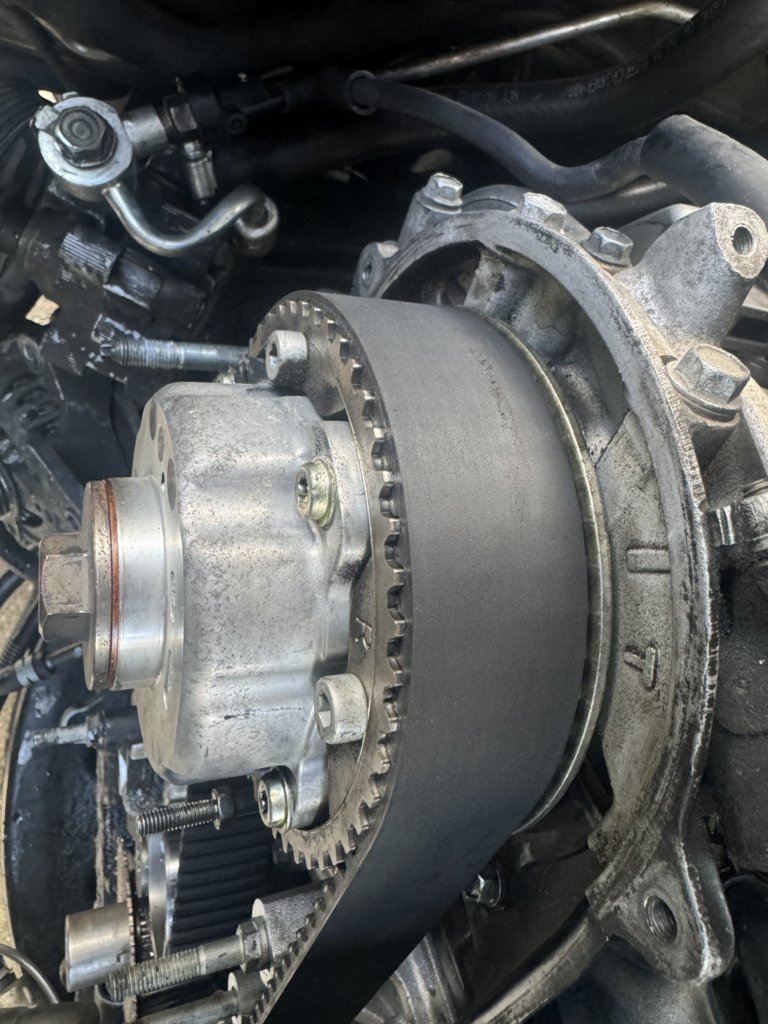

    Checked cam sensor but the sensor and wiring are outside of the timing belt covers, so that is not the issue
    no damage to the sprocket which works with the crank sensor
    crank sensor looks undamaged
    the crank sensor wires are protected by conduit from outside of the timing belt covers at the top all the way under the upper middle and lower covers and out through the bottom to the crank sensor. No apparent damage there
    Still going to take the timing belt off to inspect all the pulleys, cogs, etc But none of that would cause it not to start
    I'm at a loss. Don't want to reassemble in case I'm overlooking something.

    That was my original suspicion. I've seen that type of spacer used on accessory drive components over the years.
    But if it is the timing covers where it came from, pro tip in case you're not aware, you can use any gasket-maker or even a blob of grease on the spacers to make them stick in their hole.
