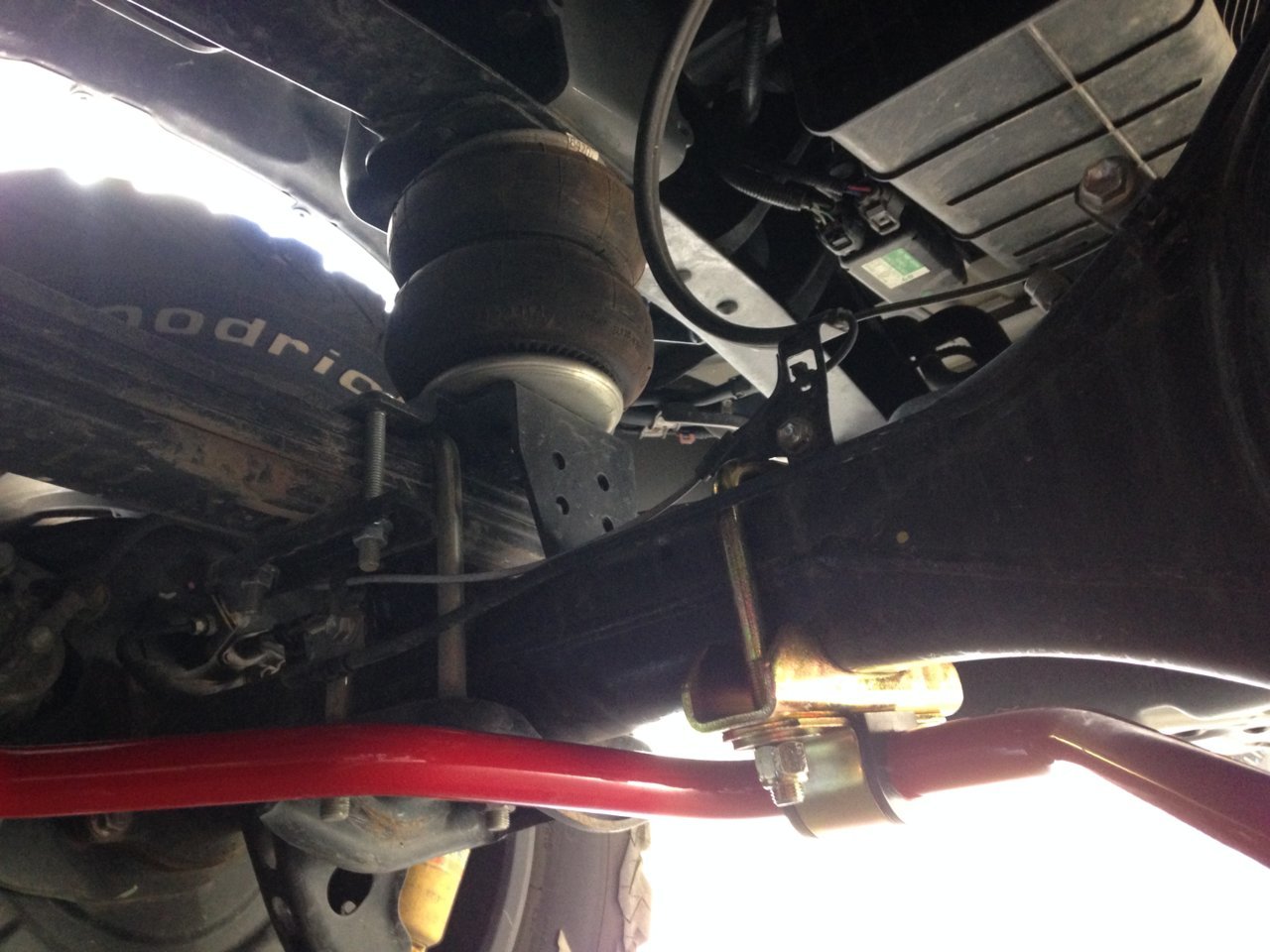

    KMG
    KMG New Member
    Oct 7, 2018
    #20257
    273
    Kevin
    Yacolt, WA
    2018 White Tundra Limited DC 4x4 TRD
    BFG KO2s, TRD Rear Sway Bar, Firestone RideRite Air Bags, B&W Gooseneck Hitch, Trail Ridge Extendable Towing Mirrors
    Earlier I posted I was fine with just Firestone airbags and I was but.... the 40% off sale "forced" me to buy the rear sway bar.IMG_2404.jpg
    Mcarrer91 likes this.
