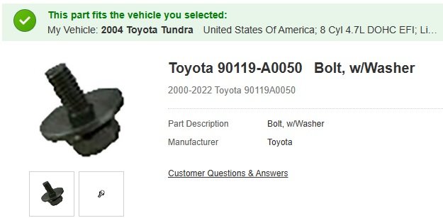

    I am looking to replace 4 bolts that hold my taillights in. 10mm bolts that I am sure are used all over the truck. Seems like a really simple thing to find but cannot find a part number on web or anything in this forum. I am sure it’s a dumb question but I am stumped.

    90119-A0050

    Obviously Bubba has you squared away. But just know, there's a really easy-to-use system to find any part you need if you want to fish for yourself. Info on how to use it is in this sticky thread: https://www.tundras.com/threads/howto-use-the-toyota-parts-system-to-find-order-parts.113808/

    I just used stainless M6 bolts of the same length with washers from a hardware store.

    Yeah - Toyota OEM bolt corrosion resistance leaves something to be desired and I live in the South

    I have had several snap on me but I went ahead and ordered 14 of them just to have them. Since shipping was about half the cost. Local dealer McGeorge wanted about almost 3 bucks each for them. Their online group is good but their walk in parts offerings are criminal. If you look up retail cost online you can expect to pay about 2x on most anything. Online was 85 cents or so if I recall. I needed some other stuff too so paid the 10 bucks shipping. I should have gone to hardware store but the threads sometimes seem slightly off.
