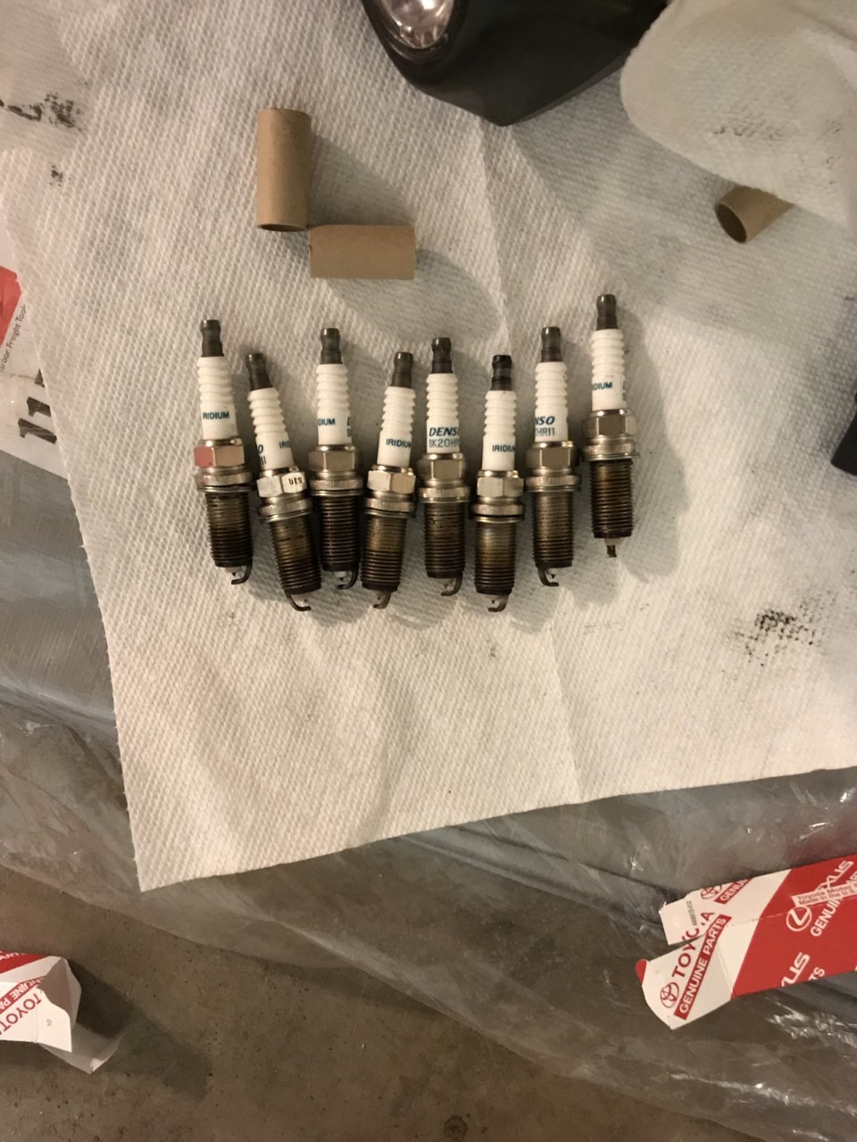

    Well glad I did the plugs. They had quite a bit of wear. More of a bitch than I would have liked. But that’s mainly due to not have the best tools. A wobble extension would have helped a shit ton.

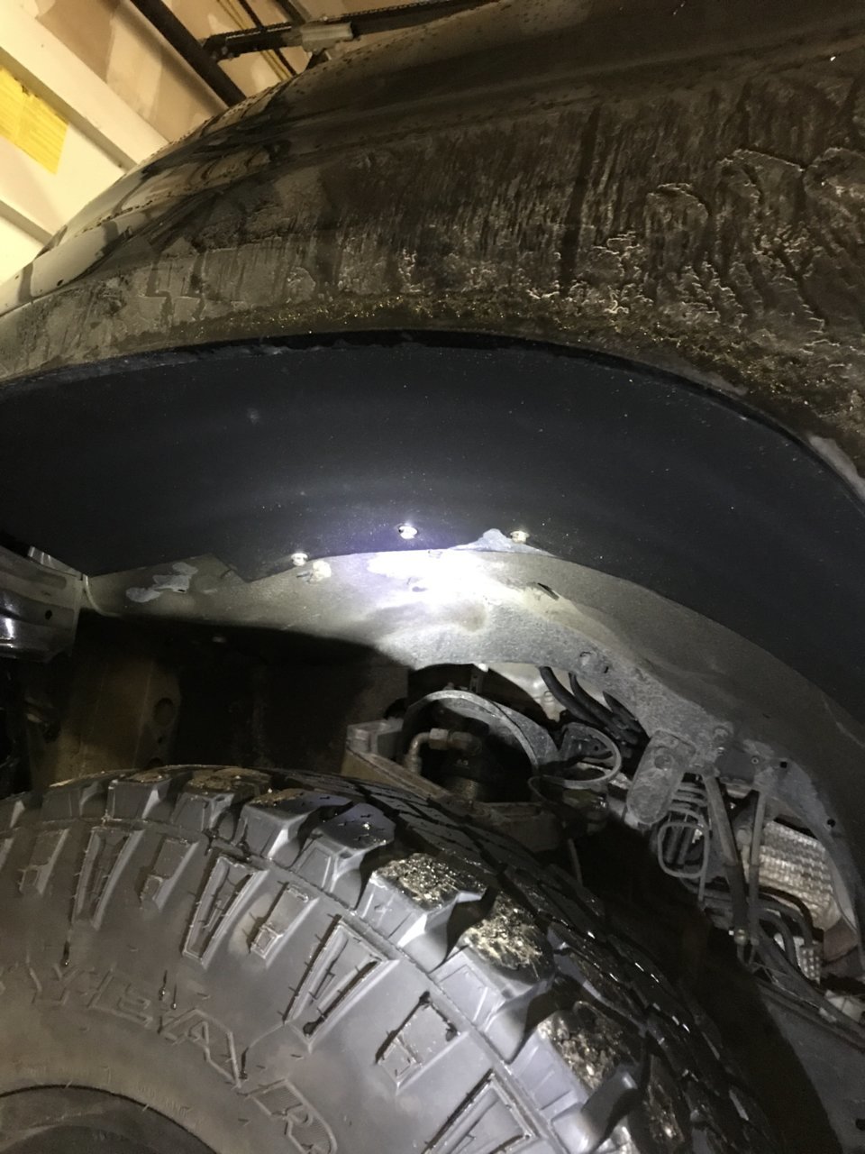

    Also, since there has been a couple threads on fender liners for fiberglass fronts. This is how I resolved the problem. There’s no chance I can run an exposed intake up where I live. At first I was going to do a mini snorkel set up through the fender attached to a silicone hose. Then I thought an hdpe board cut to size and bolted into the wheel well would work. It was a bit of a bitch, but it came out really nice. Only downside... at full, and I mean full stuff, it rubs a touch. Here’s a dirty pic of it all done.

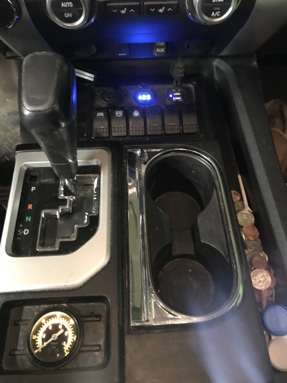

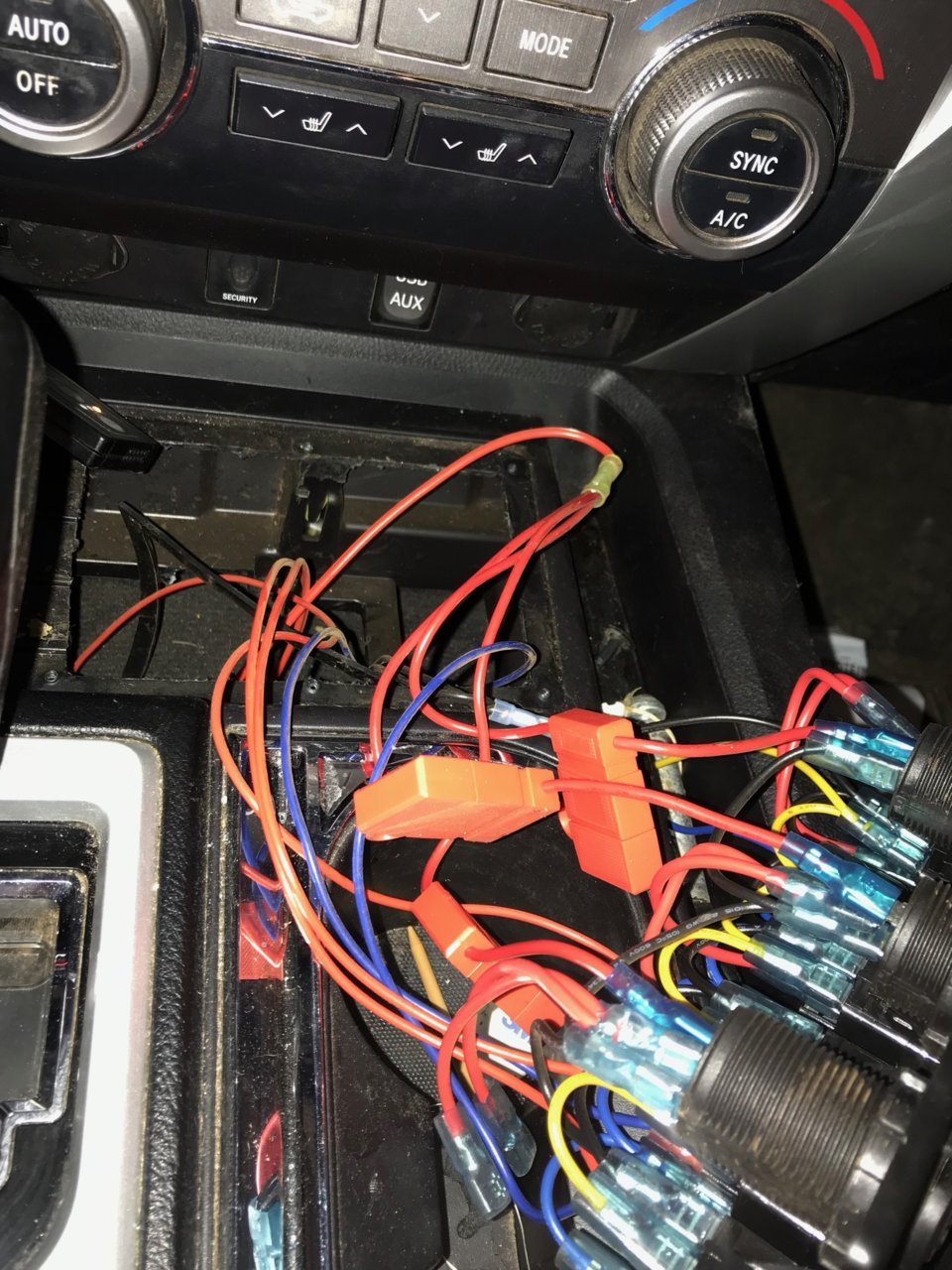

    Quick shot of inside the cab....

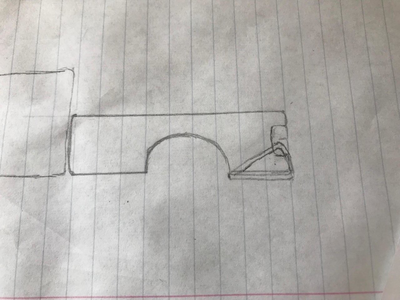

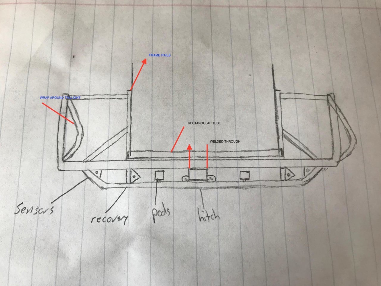

    The Truck is in the shop!
    After speaking with Chris a few times, as well as all of the great info on this site, heres how the bumper will be built.
    It will start with a rectangular tube that sits in between the end of the frame rails. DOM tubing will be welded to the top and bottom of the rectangular tube. The hitch will be welded through the rectangular tube, as well as to the DOM top and bottom. There will be Dom connecting to the wrap around section next to the tire. This will be straight from the frame. There will also be another piece of DOM welded after the shackle towards the tail gate that attaches roughly to the connection point of the lower and upp DOM.
    Accessories... There will be two recovery points directly inline with the frame rails. 2x tab mounts for pod lights. Hitch of course! And I will be putting the sensors in the corners of the connections where the bottom dom welds back into the top.
    This bumper will be a bolt on bumper. I thought about getting it welded on, But with how fast everything rusts up here, I decided it would be easier to take it off and sandblast it once it starts to wear.
    As for cutting the bedsides...
    The plan is to cut off 3" of the bedside all round and role it inward to create bolt mounts for the HDPE board that I picked up. This Point is as far as I can go without relocating the filler neck. Also this is where the inner wheel well liner goes to. He will be pushing that up a little also.
    and to keep it confusing. Heres a shit drawing showing the rough design

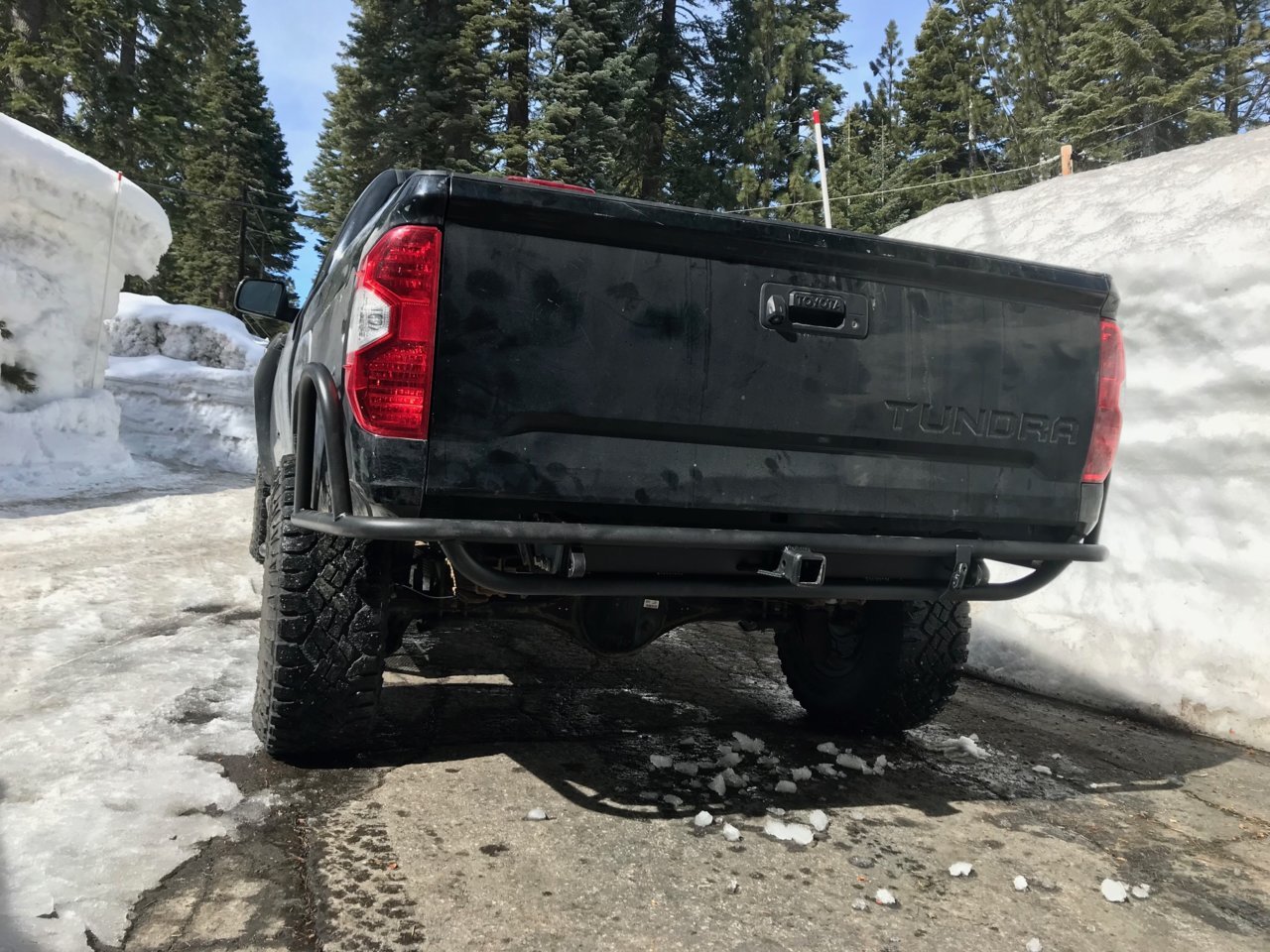

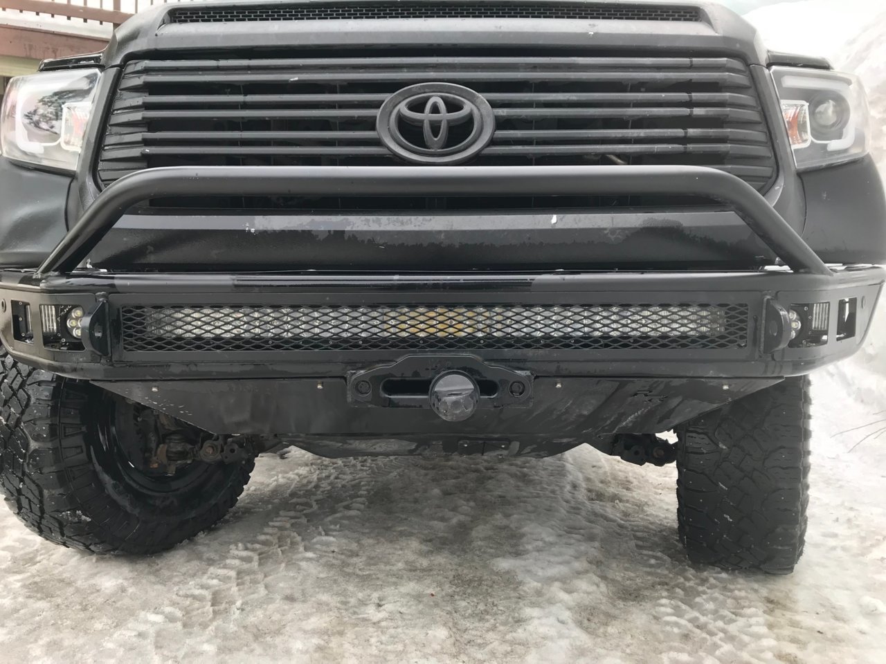

    Alright bumper is completed. It took a couple tweaks and adjustments. But I like the over all look of it. Heres a couple shots of the truck as well as the front+rear bumper in detail. After seeing some of the first posts, my picture taking abilities are a joke... Enjoy
    Working on a few more things in the truck bed and under the truck. Should have them finished by the end of the weekend.

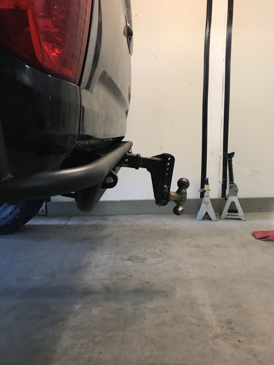

    I like everything from the horizontal line down. And the hitch angle is waaaay effed up.

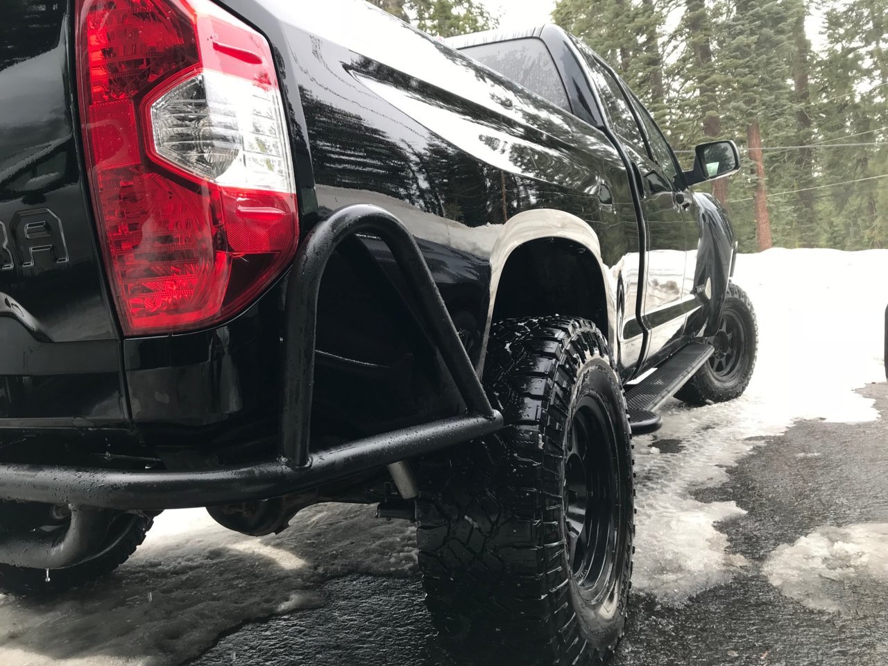

  14. Mar 20, 2019 at 9:40 AM
    #74
    tahoetrails
    tahoetrails [OP] New Member
    Feb 18, 2019
    #26311
    93
  15. Mar 20, 2019 at 9:41 AM
    #75
    tahoetrails
    Feb 18, 2019
    #26311
    93
    Ya it does have a little bit of downward angle to it. That was the first set of adjustments needed. Here’s a pic of a hitch on. I’m on the fence on if it will effect the tow quality or not.
    joonbug and 831Tun like this.

    I love the recovery points and that's one of the sleekest winch mount bumpers I've seen. :thumbsup: I like that rear bumper a lot more than the Westin I've got.

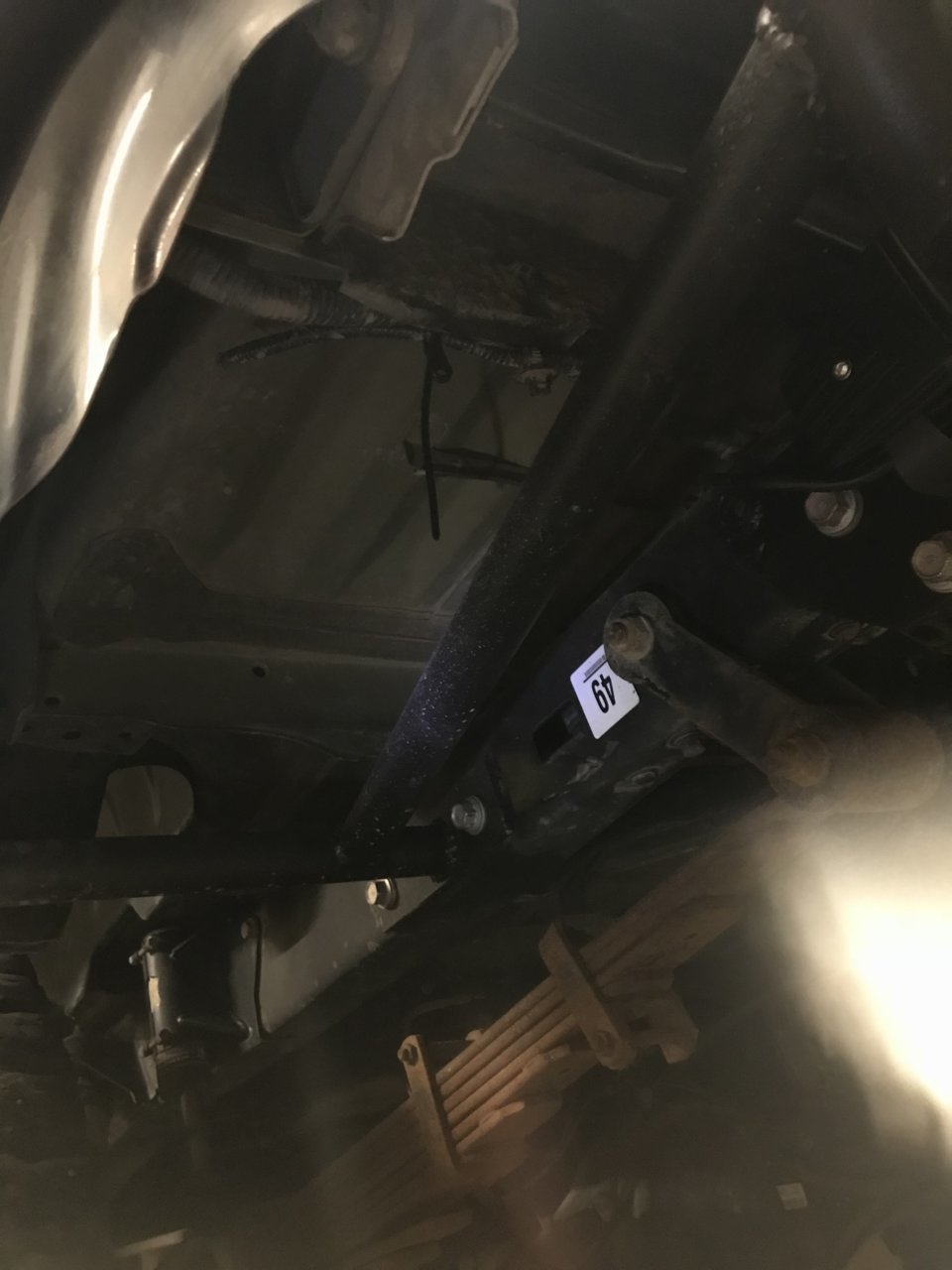

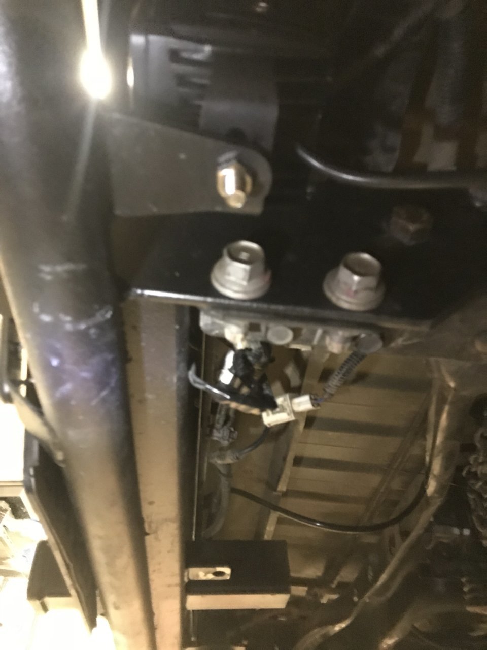

    Can you take a picture from underneath, so we can see how the rear is tied together?
    831Tun, dcsleeper408 and joonbug like this.

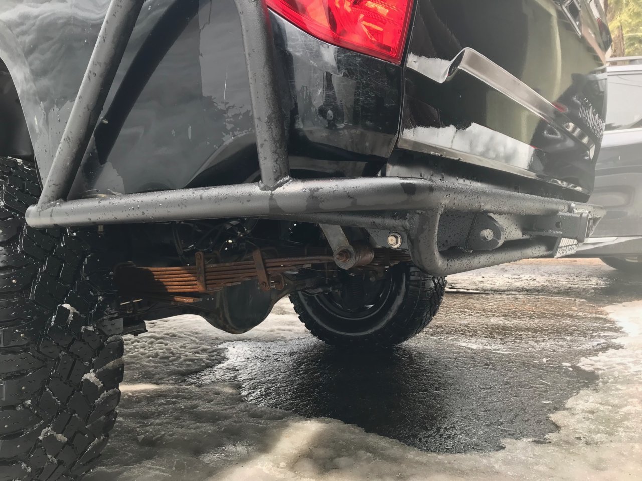

  18. Mar 20, 2019 at 11:21 AM
    #78
    tahoetrails
    Feb 18, 2019
    #26311
    93

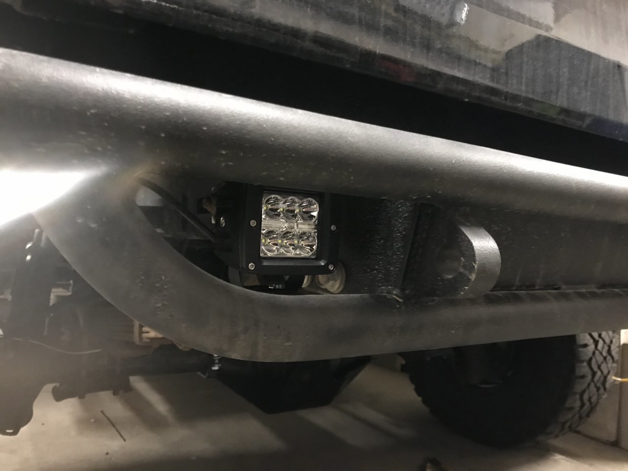

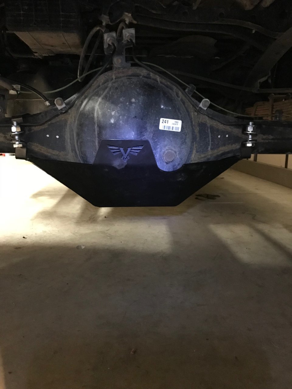

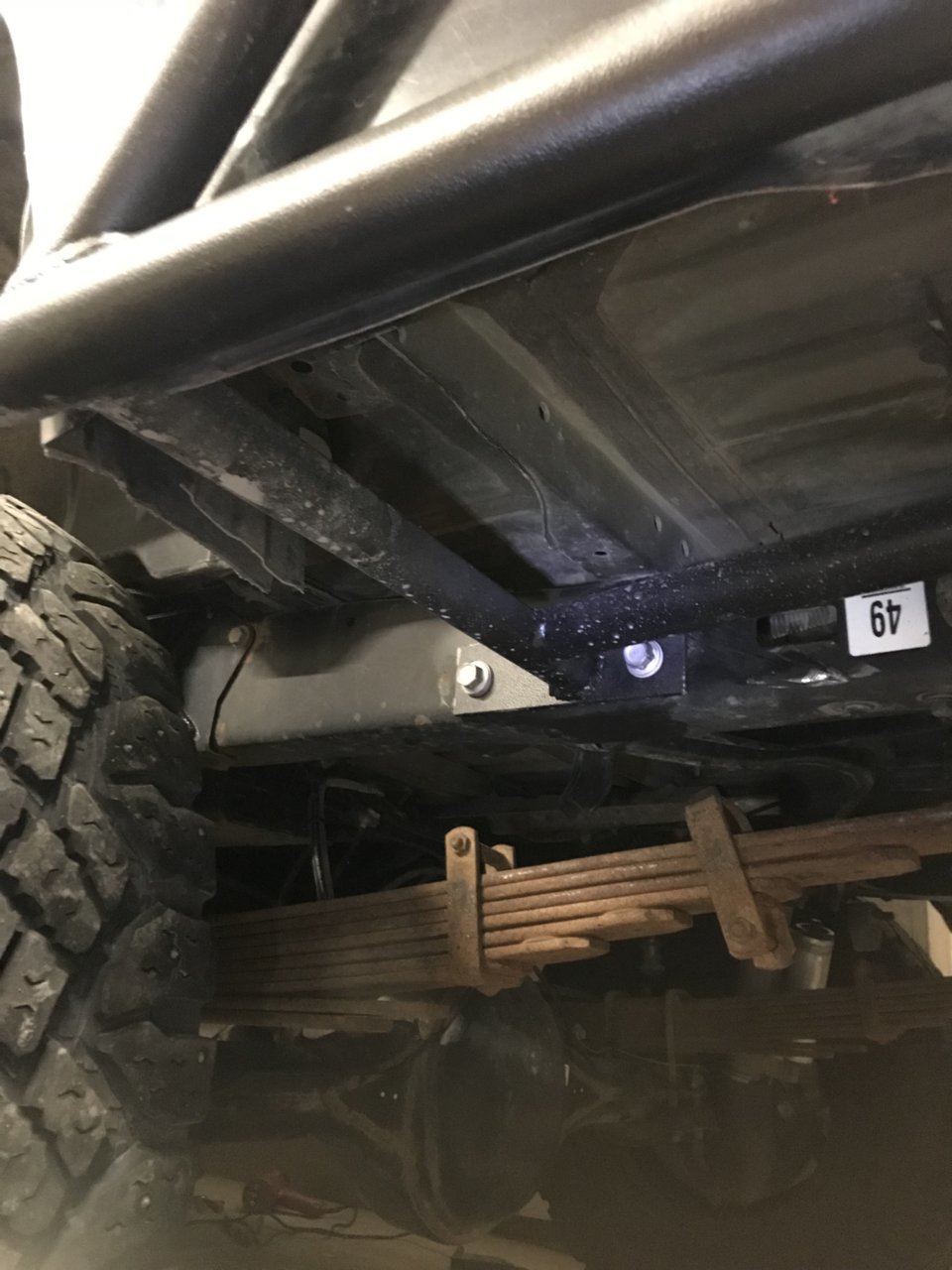

    Here’s some shots from under

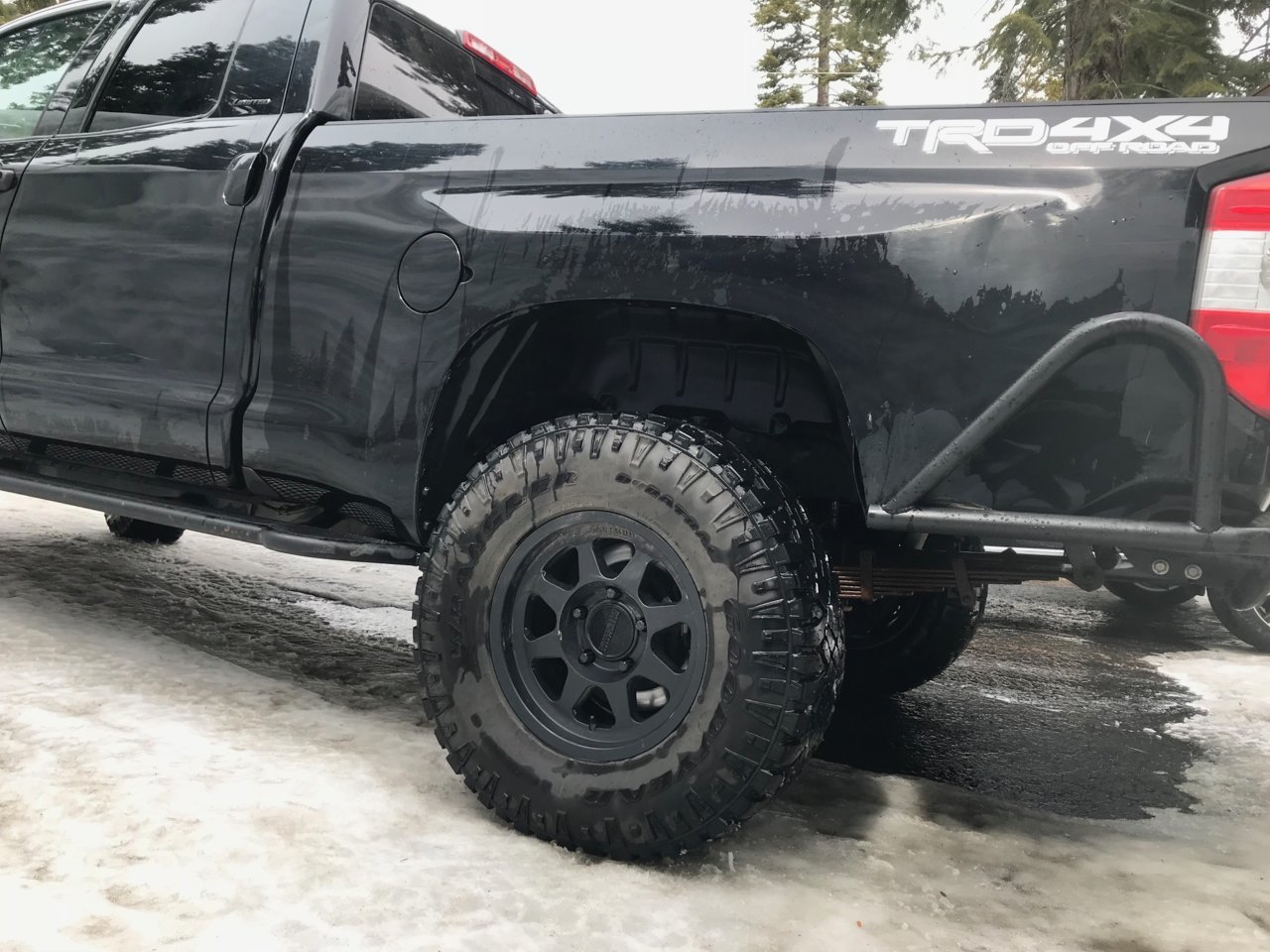

    poor leaf pack...looks like they salt like crazy where you live

    Haha ya, I am debating on taking them off and cleaning them. But it will just rust out again in 8 months. And yep armor, i pulled the trigger on a fuel tank skid. I just finished installing it, damn its a beefy plate. Ive got one more piece of armor coming from victory 4X4.

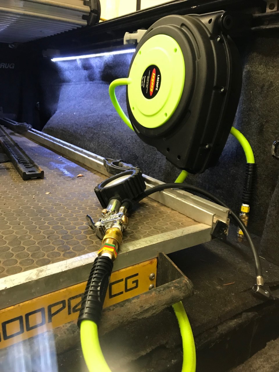

    I had some time this weekend.

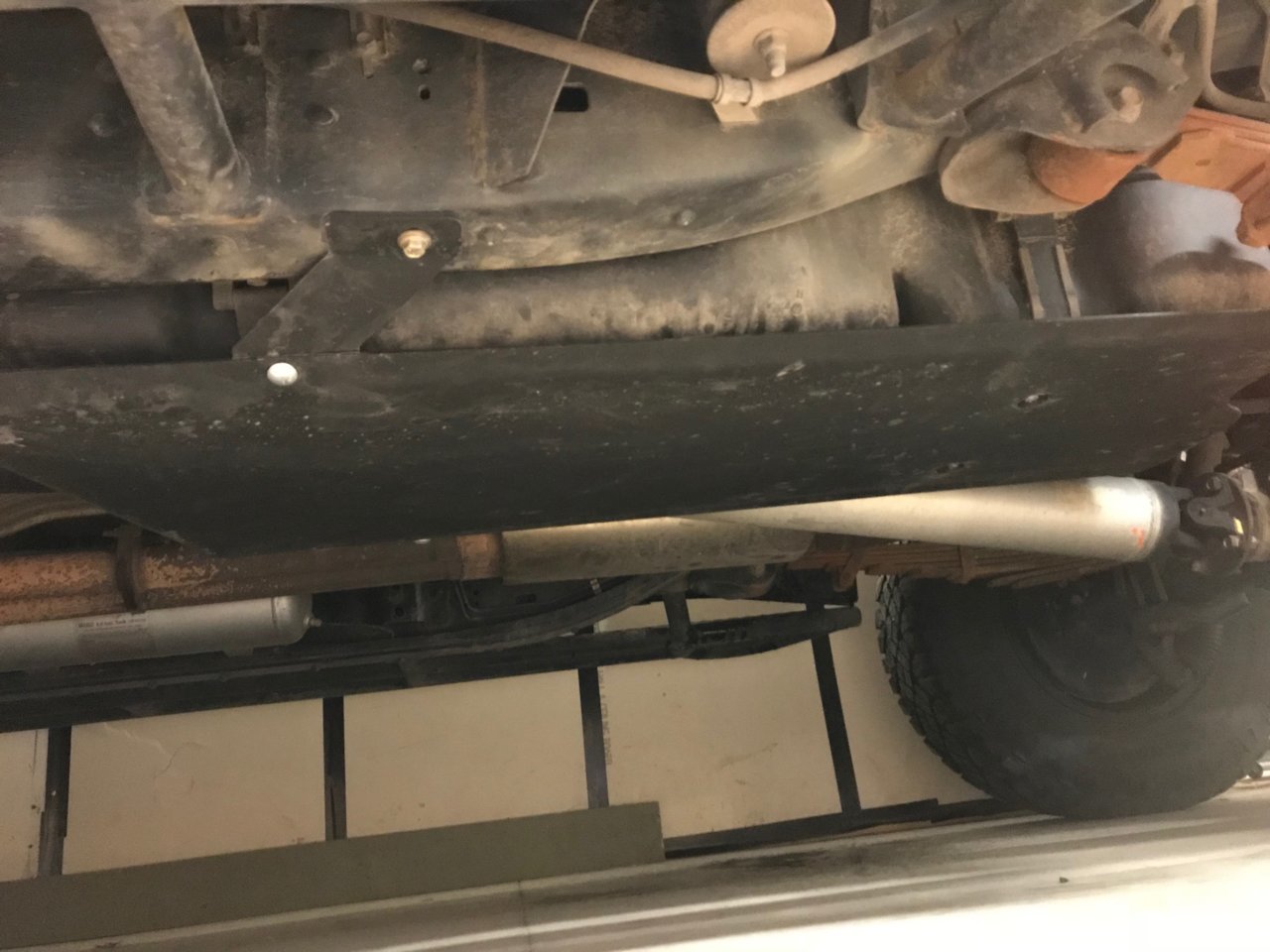

    I installed the RCI fuel tank skid plate as well as the Victory 4x4 Diff skid plate.
    Relocated Air compressor outlet to inside the bed. As well as attached it to a 30' hose reel. I'm not sure how durable its going to be once I put it through a few trips. But for now I like it a hell of a lot more than my yellow expandable line.
