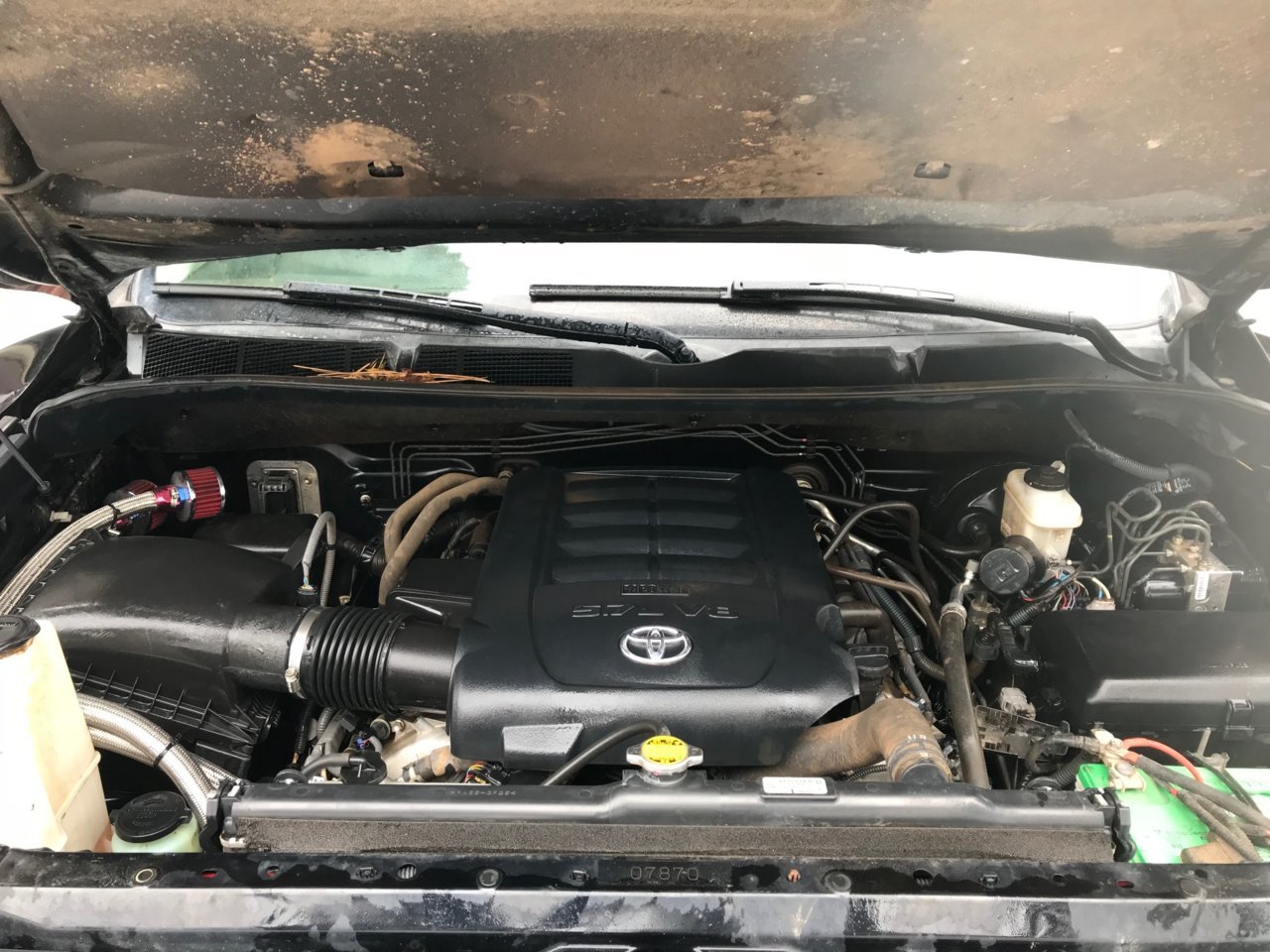

    I like the boots on the ADS bypasses. where did you get them ?

    I had greg from R&R order them through ADS. Its not on their site. I chipped both shock shafts on the bypasses and had to get the replaced. Hence the boot order

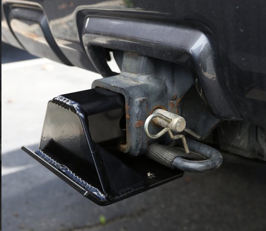

    I built a high clearance Bumper utilizing the factory tow hitch mounts and I’ve pulled a 25ft pontoon boat w no issues!
    I’d be willing to start making them I just need the factory both as a donor for the side plates... I’m the only one who’s done this.

    Can I see a pic of the bumper connection to the frame? Im interested in the lateral tubes to the sides of the bumper. Btw that turned out great! Really similar to what I'm looking to do. I really liked the high clearance bumper someone on here had. I think his truck was the black pearl? but I don't want any weight hanging off the rear bumper. so just the hitch and some pod lights.

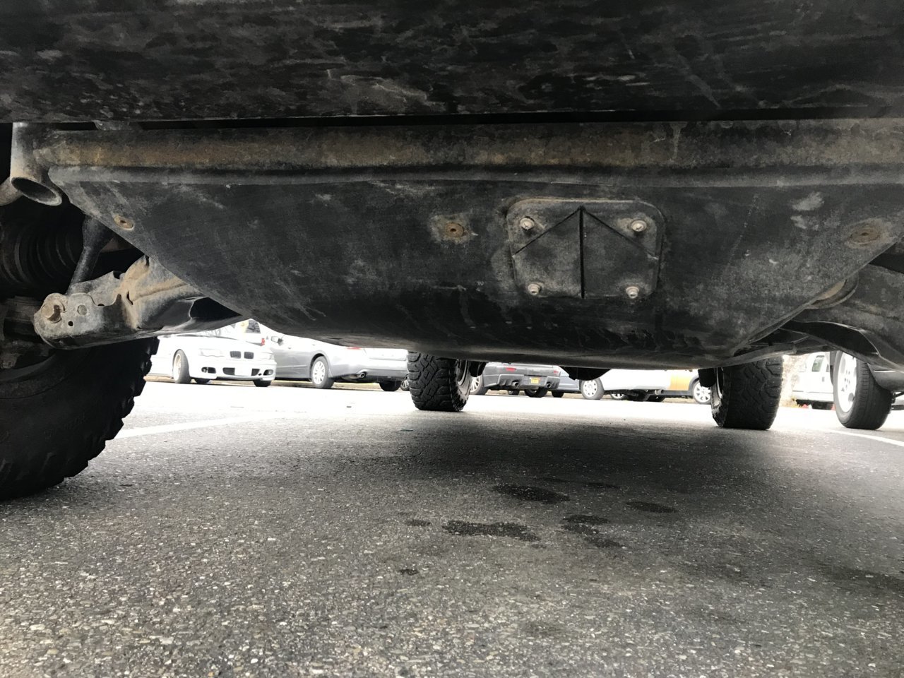

    Here a quick shot of the skid plate underneath.
    Attaches to the transfer case cross member with some grade 5 bolts in the back.

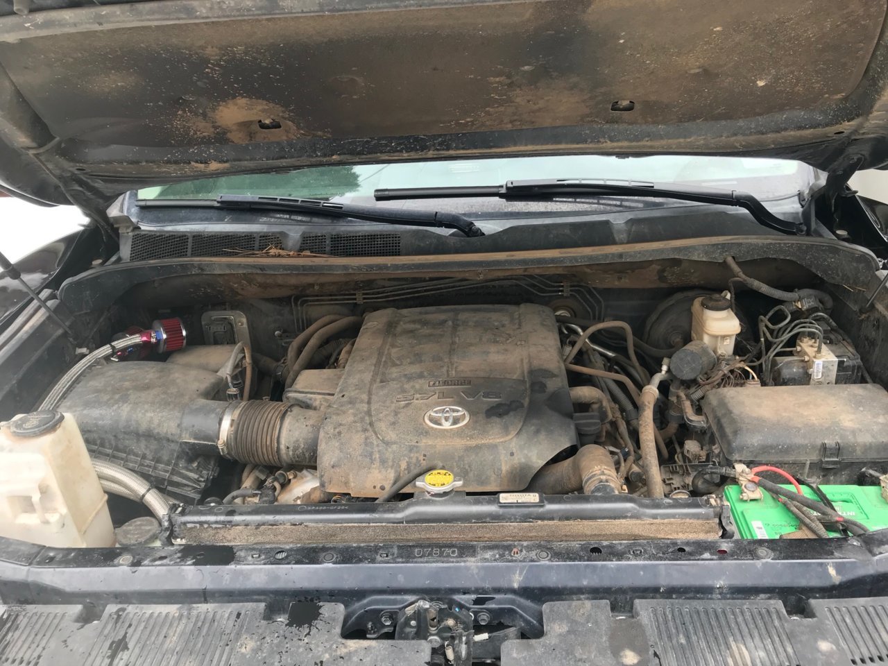

    Little update. it was time to do some maintenance on the Tundra.

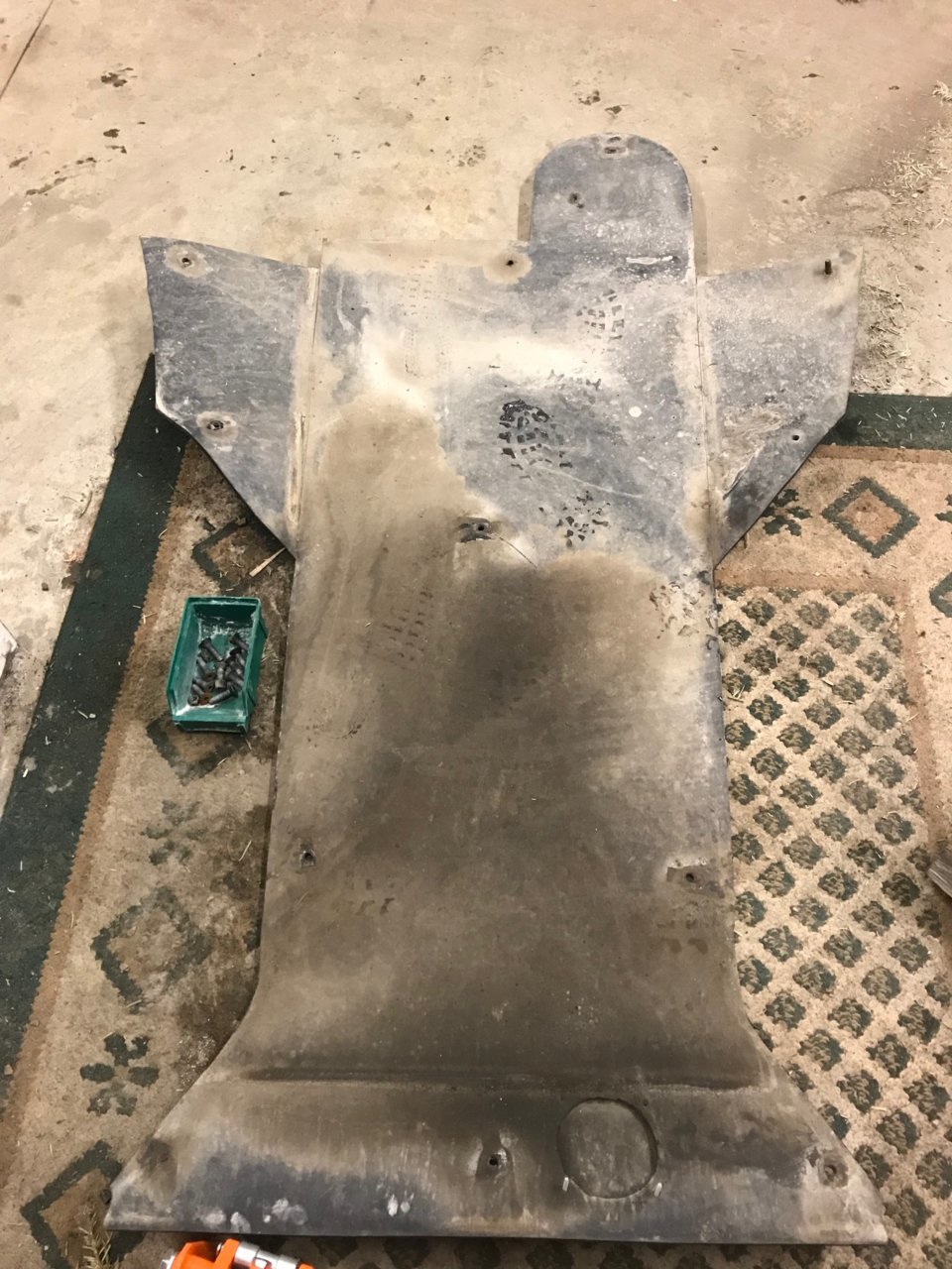

    I'm tackling spark plugs today as well as regressing the T-case driveshafts. But unfortunately to do this I had to remove the skid. So i though id show the skid plate design on here. Also the engine bay got a wash.
    As for the skid. everything attaches to the DOM frame. Minus the wings in the picture which the fabricator welded some tabs to the frame. the wings bend upward to keep a low profile.

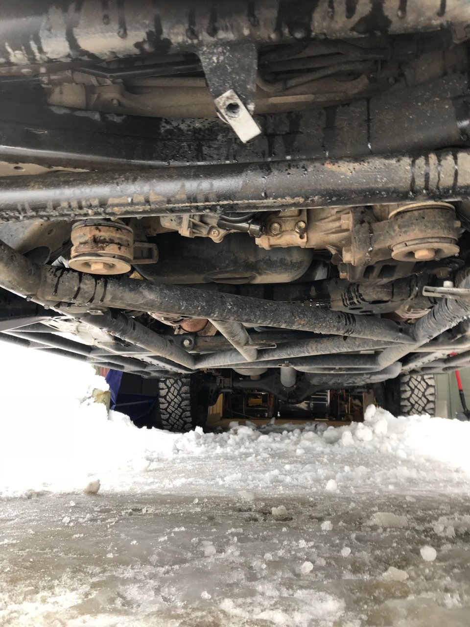

    Also, this wasn't from, this year, but last year went wheeling in about 40" of snow. Truck handled like a champ. heres a pic. the tires were on top of a foot of snow and the snow level still came up almost to the mirrors.
