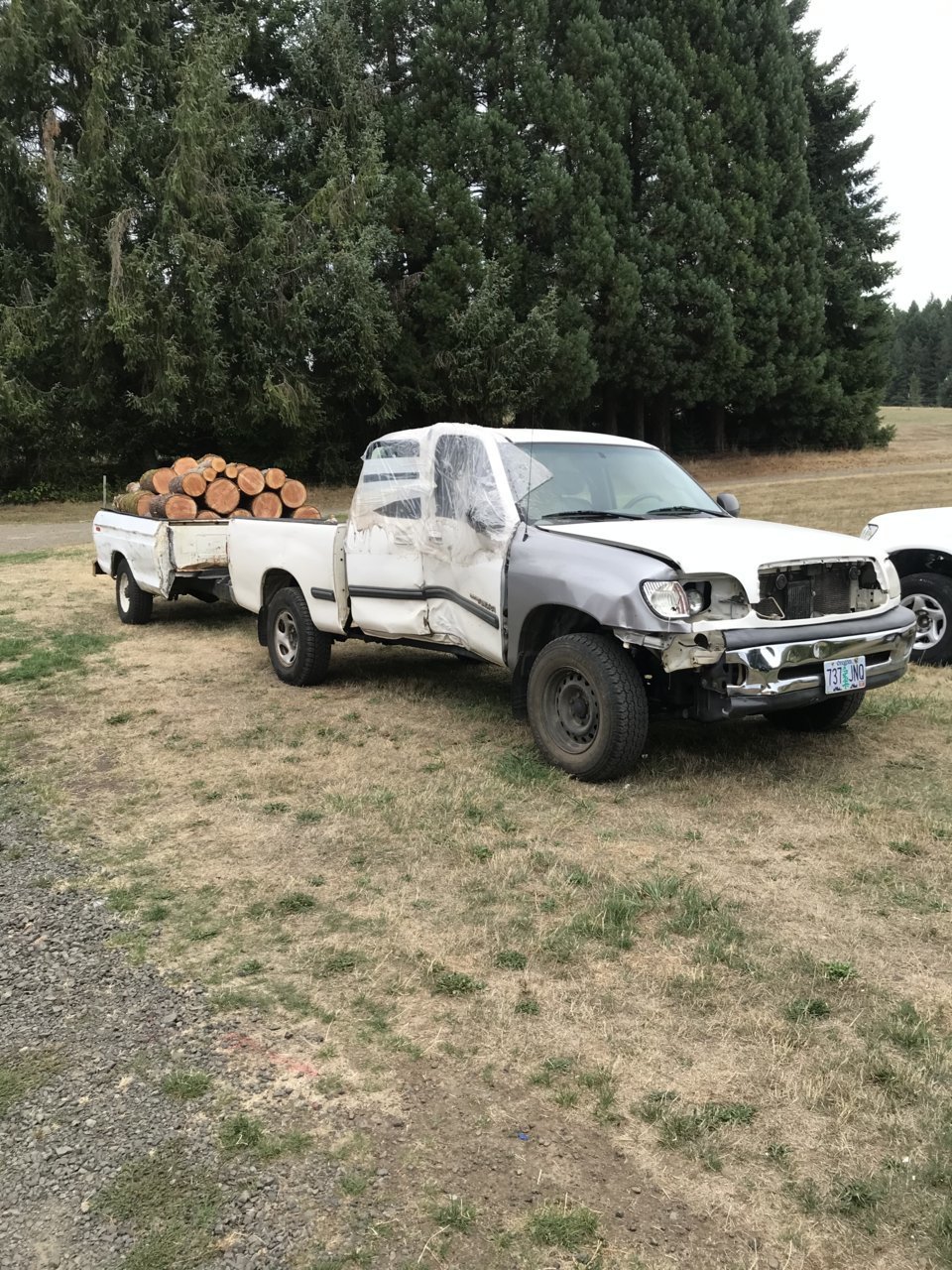

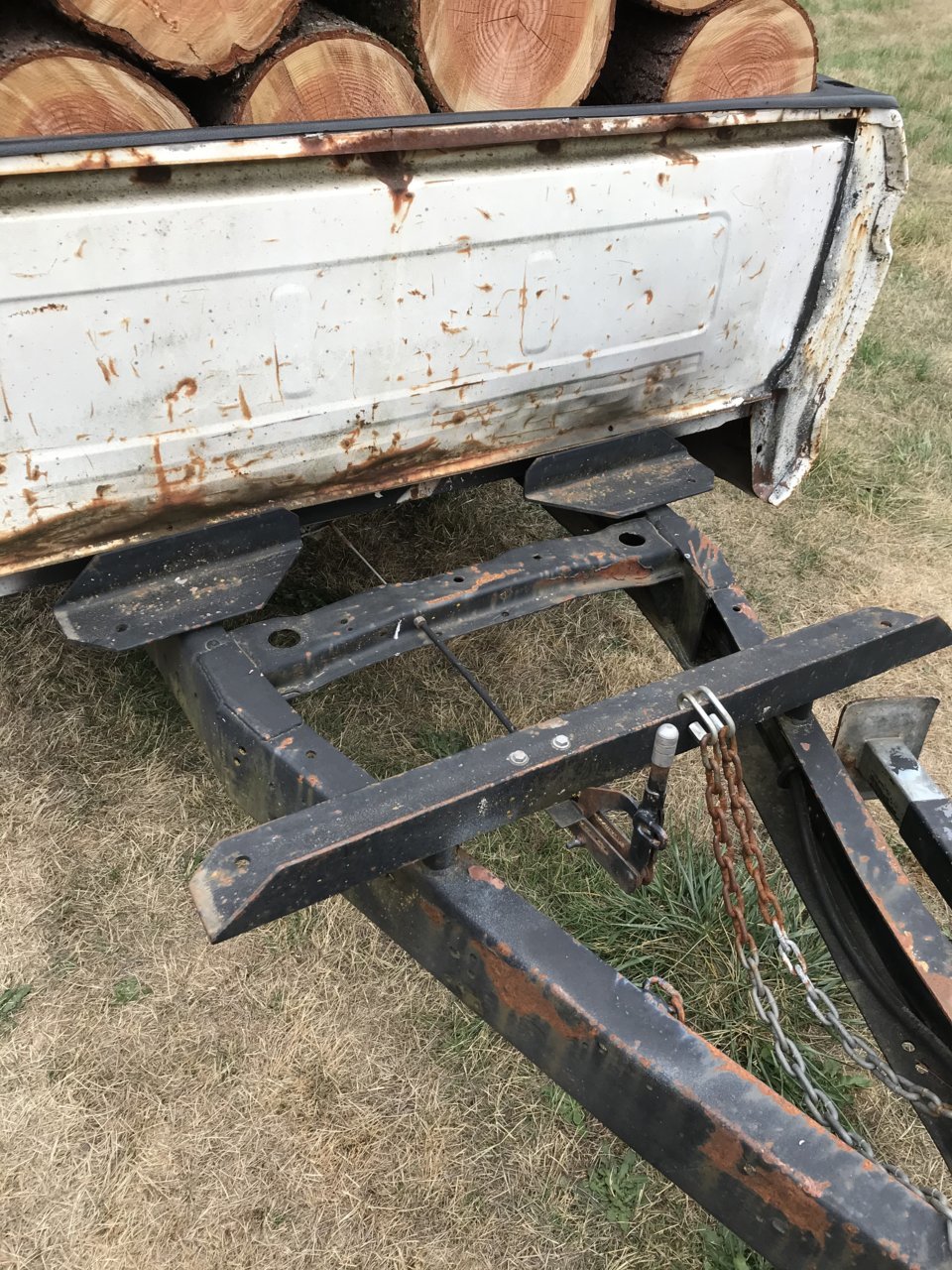

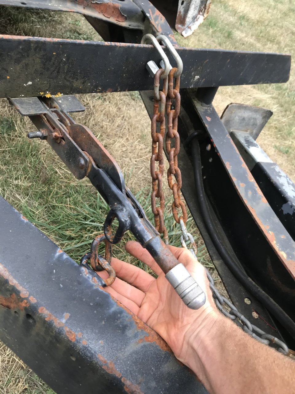

    I needed to grab some 20’ sticks of 1.5” schedule 40 pipe from my friend’s house last night. I currently don’t have the lumber rack on my work/moto van, so i had to improvise a little bit with the Tundra...

    01 Tundra V8 4X4 AC SR5 TRD
    @whodatschrome wild stuff you got here. Neat to see that thing still moving. Would love to see some interior pics of it crunched up like that. Sucks to see that bent ass frame looks pretty rust free. Way she goes I guess. Best of luck with the in depth mechanicals. Gotta get everything to play nice together.

    Hat's off to you. The pics with dem trees loaded in the truck, with a caved in passenger side, is possibly the most manly thing I've seen in a while.
    Nice welds on that hitch, too!
