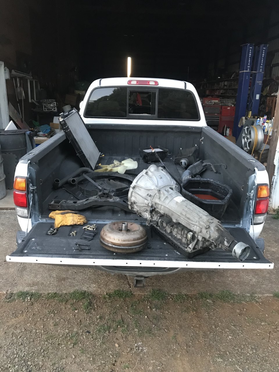

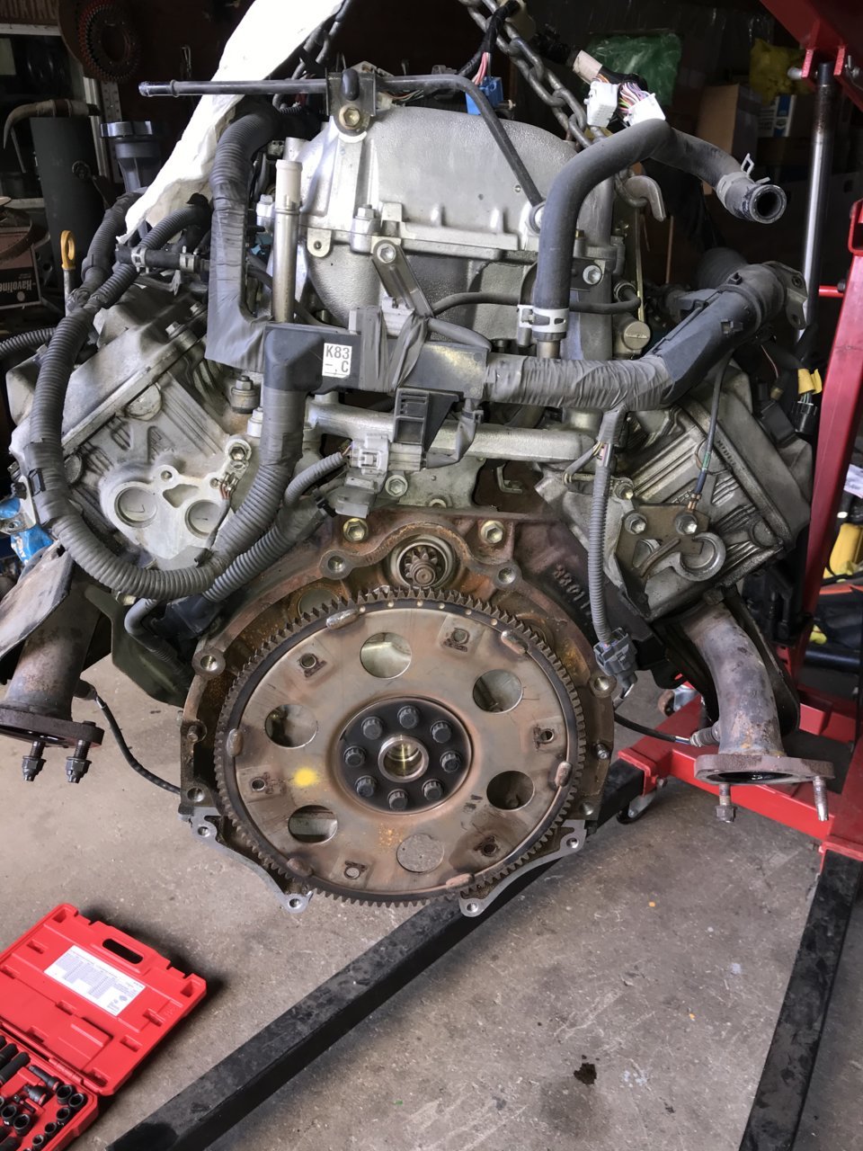

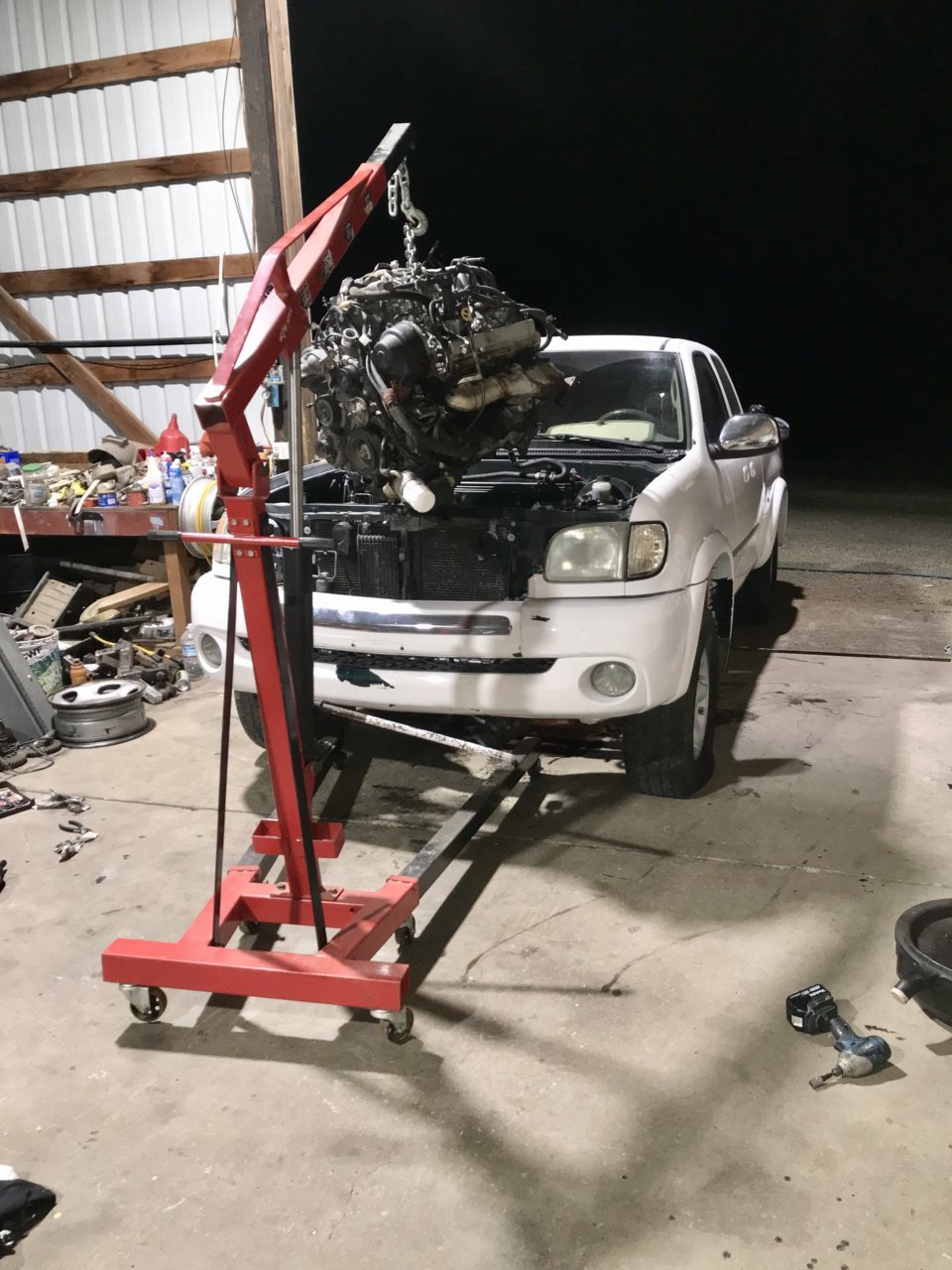

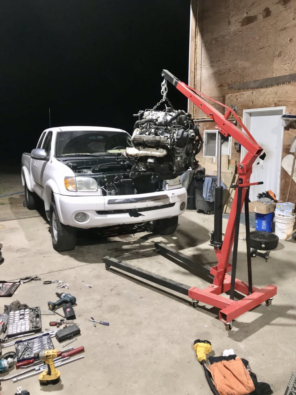

    It took me about 4 hours to remove the transmission. Another 1.5 hours later and the engine was out of the bay. I had to air down my front tires to about 2psi in order for the oil pan to just kinda clear the core support.

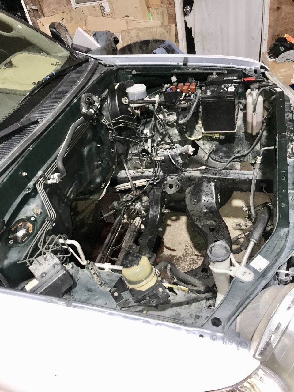

  7. Sep 15, 2023 at 9:28 PM
    #37
    whodatschrome
    whodatschrome [OP] New Member
    Sep 13, 2023
    #103882
    1,847
    North of North Plains, Oregon
    lots of dents

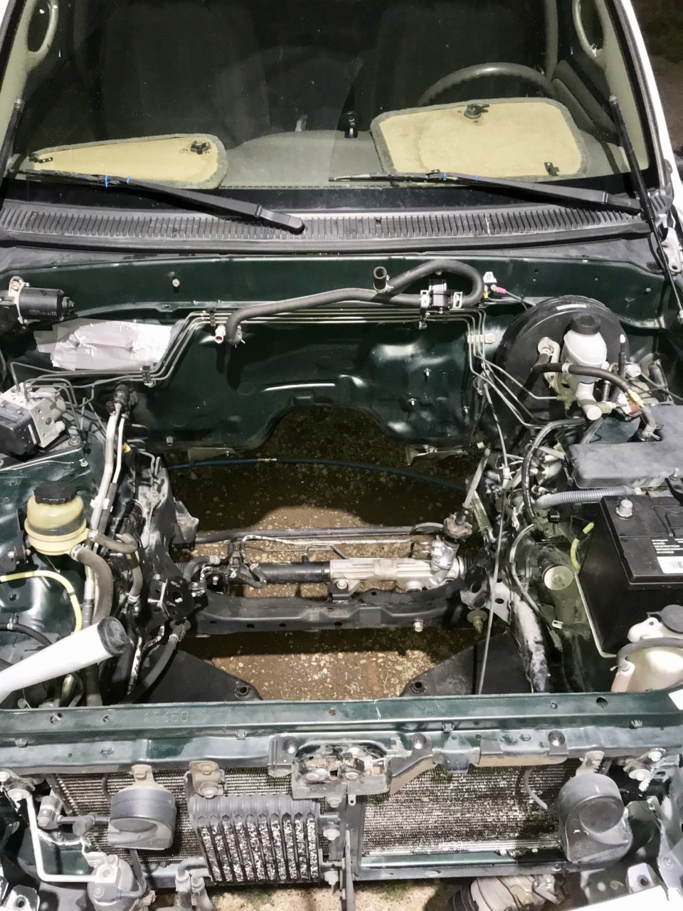

    After i pulled the engine i used more Purple Power to clean the entire engine bay.
    Before
    After

  10. Sep 15, 2023 at 9:35 PM
    #40
    Mr.bee
    Mr.bee King Turdra
    Jun 4, 2022
    #79178
    6,424
    SATX
    '02 AC TRD
    Some of these are amazing reference pics. Like the back of the engine & the trans & empty engine bay & cab without carpet.
    txagg, BroHon, Bmktw2 and 3 others like this.

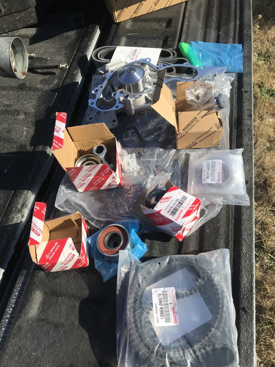

  11. Sep 15, 2023 at 9:39 PM
    #41
    whodatschrome
    Sep 13, 2023
    #103882
    1,847
    lots of dents
    I have no idea how old the currently timing belt that’s in my 2000 tundra. To play it safe, i did some ordering of parts. UPS delivered a timing belt kit today (the Toyota transmission filter arrived yesterday). In my head, the only option was to use genuine Toyota parts. It should be much quicker and easier to replace those parts with the engine out of the truck.
    BroHon, bmf4069, speedtre and 2 others like this.
