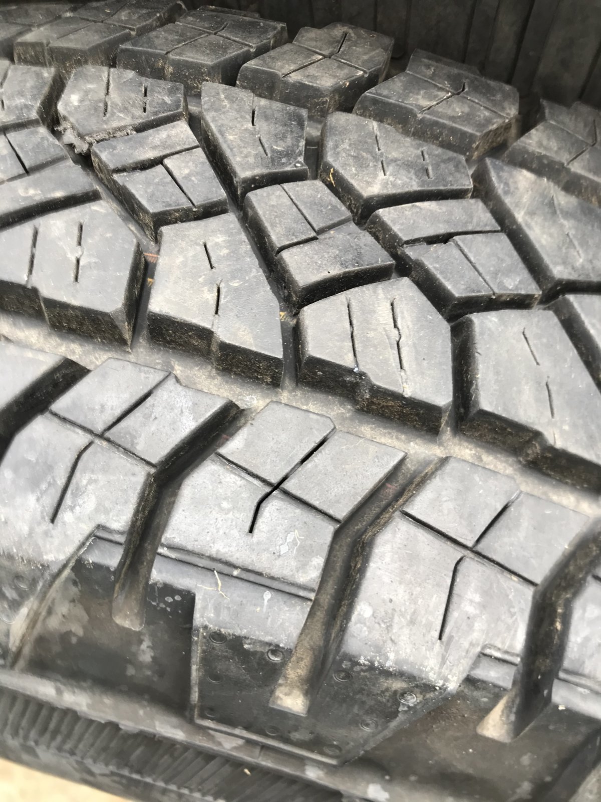

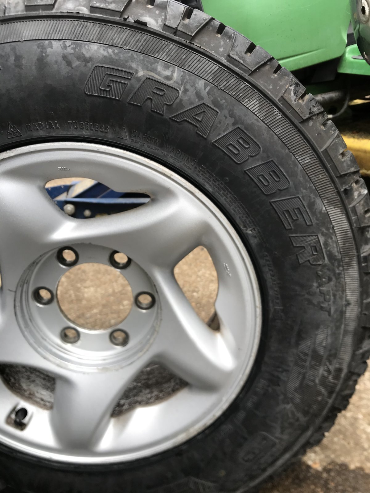

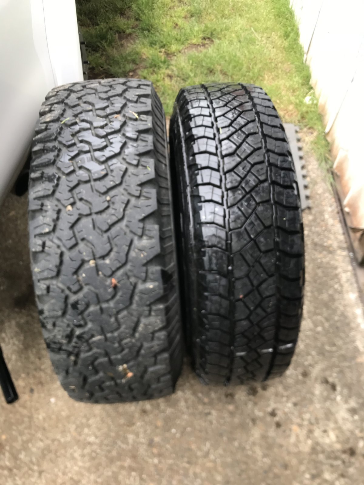

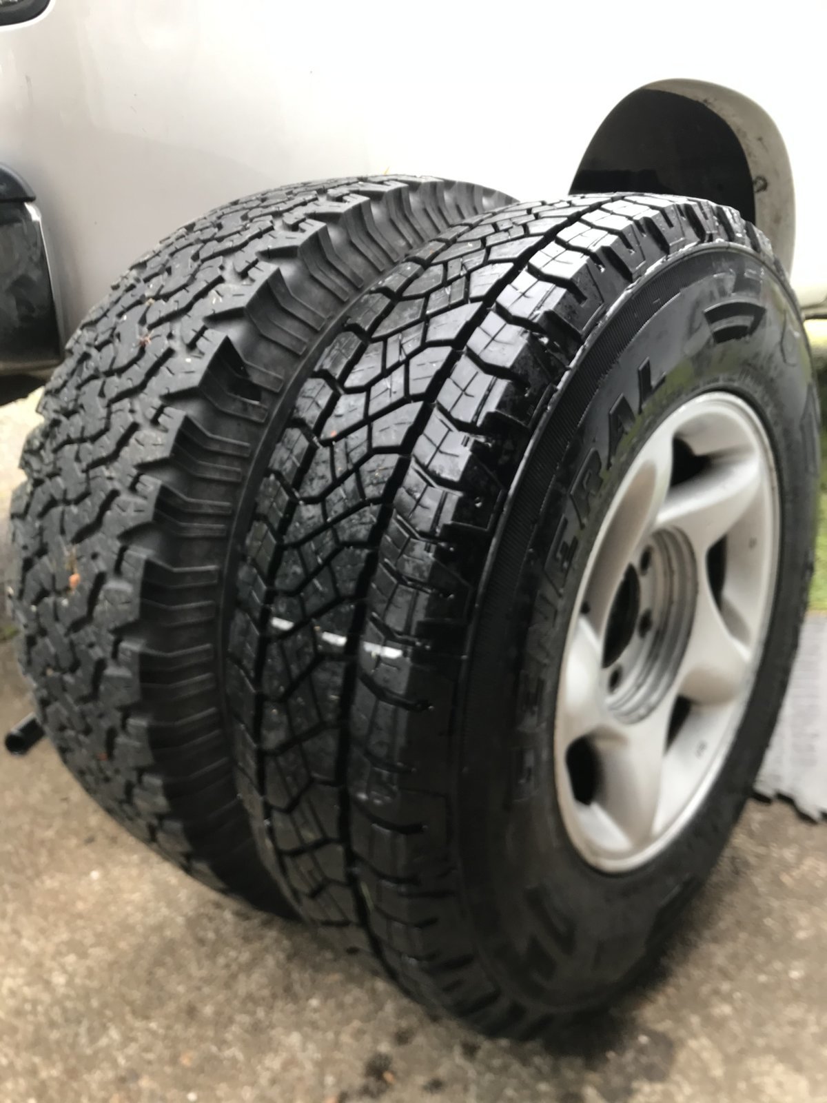

  15. Jun 4, 2024 at 9:25 PM
    #285
    whodatschrome
    whodatschrome [OP] New Member
    Sep 13, 2023
    #103882
    1,972
    North of North Plains, Oregon
    lots of dents

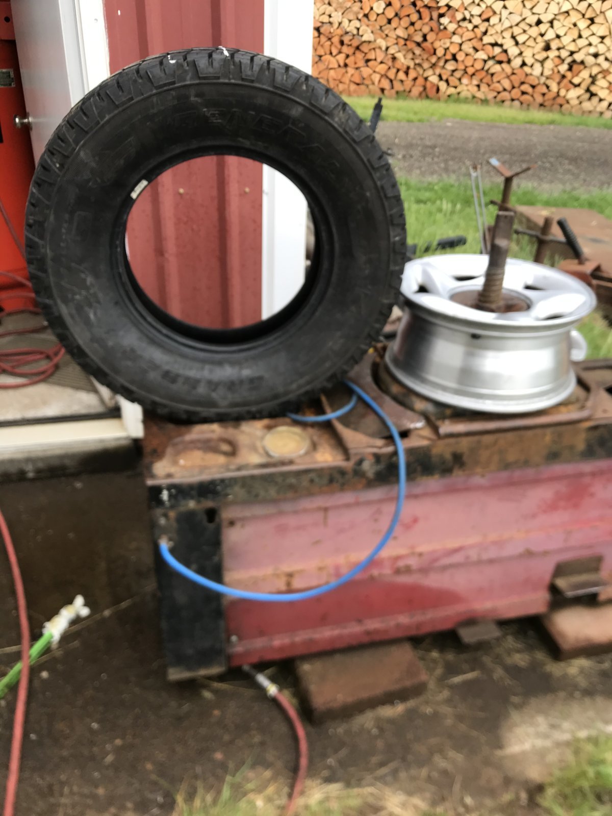

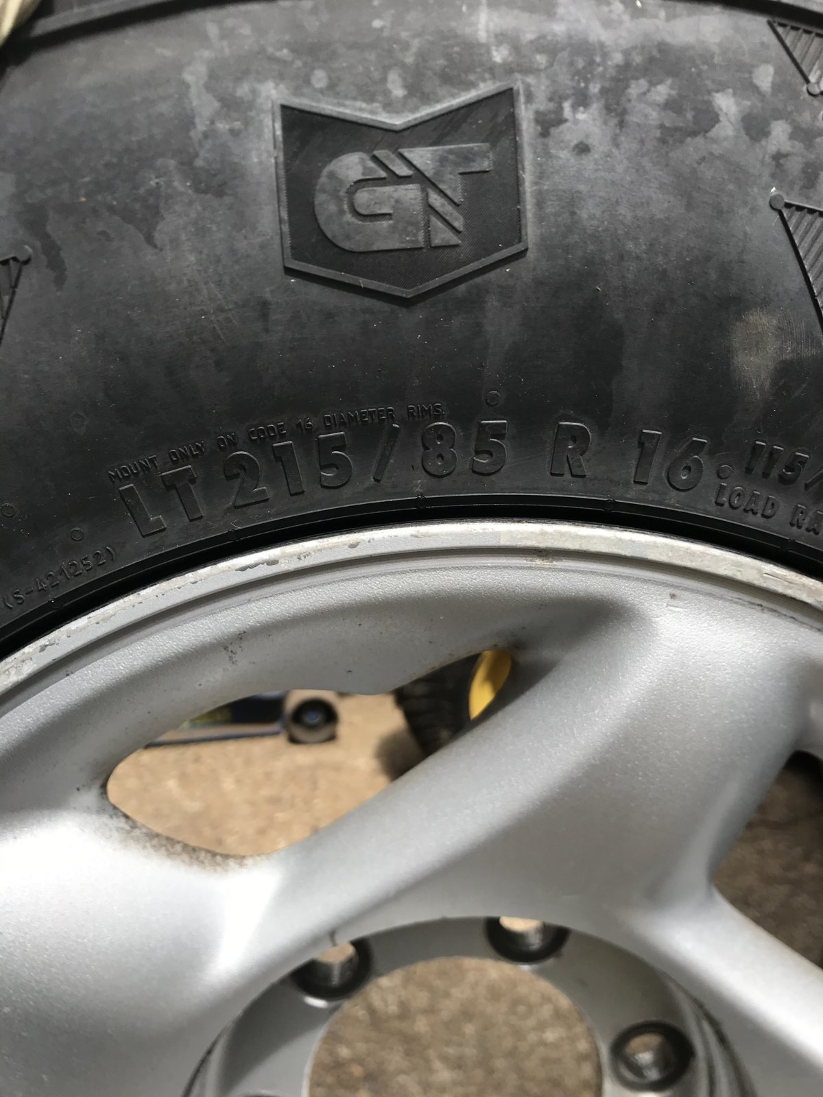

    Thanks to @shifty` for the recommendations on using United Tires https://www.utires.com/ when shopping for used tires. Last summer i had a very large sidewall puncture on one of my General Grabber APT tires. I was driving through the forest (no roads, no trail, just breaking my own trail) while going after firewood when a random branch stabbed the passenger front tire. I’ve been searching around for the past year for a matching 4th tire. Finally a used matching tire popped up at United Tire so i bought it for $112 shipped!
    So while everyone else is going up in size, i’m hoping to wear out my 265/75-16 BFG AT’s (D load) and switch back to my previous 215/85/16 (E load). I should pick up some MPGs and definitely i will pick up some better acceleration and towing capability with my current 4.10 gears.
    There was a break in the rain today so i mounted up the tire onto Patrick. There’s very little wear on the tire, so i feel like i got a great deal.
    B887A5C2-C8FB-45EE-9ED6-2B7EBE7A1EAA.jpg C8308F45-CBA5-48CD-BE3A-0304DD25A6C7.jpg A81DC35A-4DF3-4125-9DEA-73A0DEB39FC2.jpg 6193C2D2-1FC1-4101-BE2D-53740C3CACD9.jpg 48E3FEAA-4433-4672-A6D9-7A4932CAAF00.jpg 71DF6AC2-BE4F-452F-9D6E-2073A172725E.jpg

    Damn that's a skinny tire

  17. Jun 5, 2024 at 6:21 AM
    #287
    whodatschrome
    Sep 13, 2023
    #103882
    1,972
    lots of dents
    yeah, overall the 215/85-16 is a much more svelte of a tire. About 1.25” shorter and 2” more narrow than my current 265/75-16 (as well as both a 245 and 265/70-16). But it is still about 3/4” taller than the 245/70-16, and 1/4” shorter than a 265/70-16. A skinny 30.4” tall tire will still get me to most places i want to go, yet at the same time it will allow all my steering components to last longer, and my brakes to be stronger.

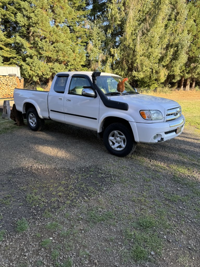

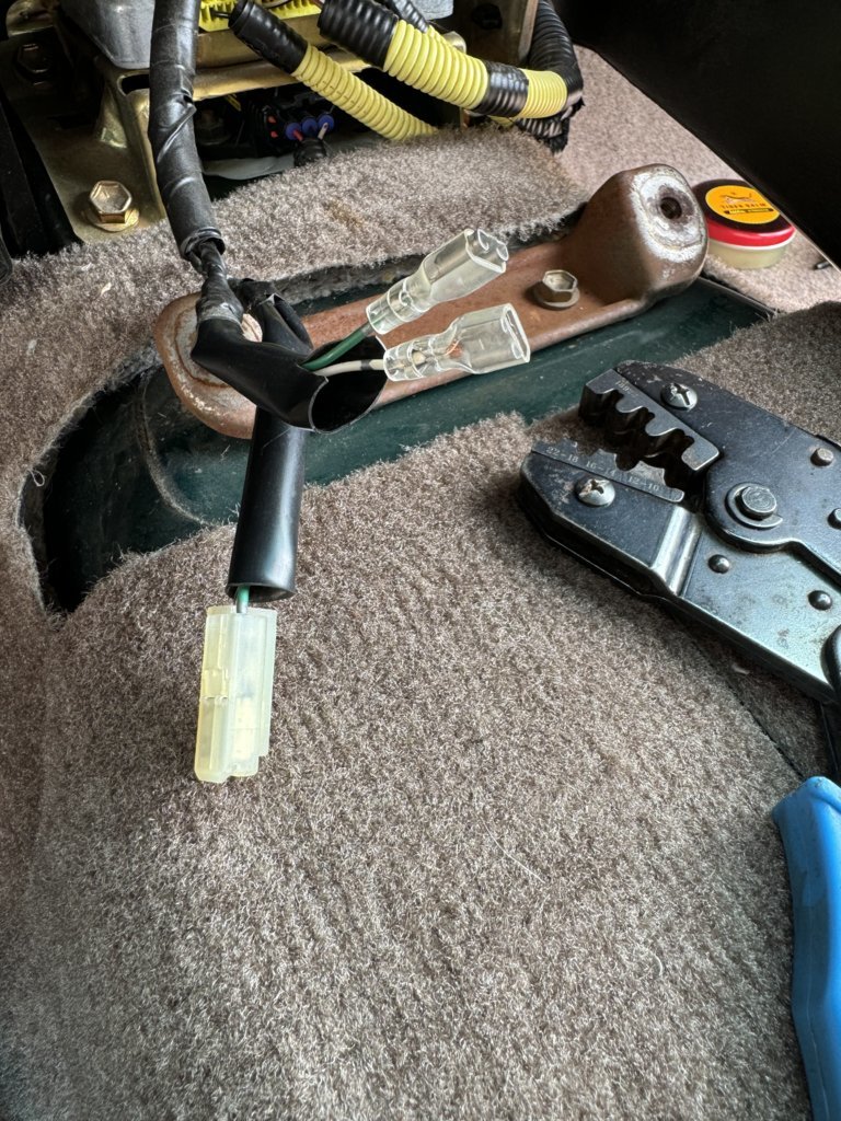

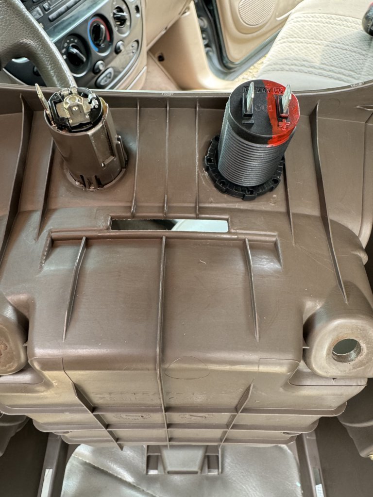

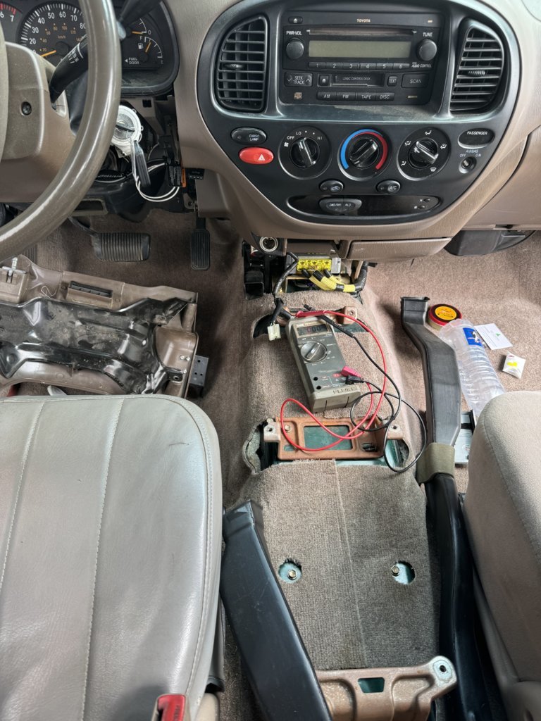

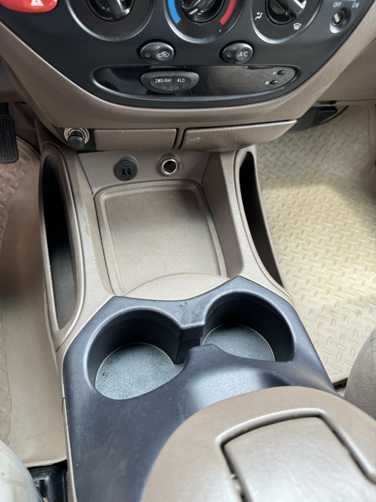

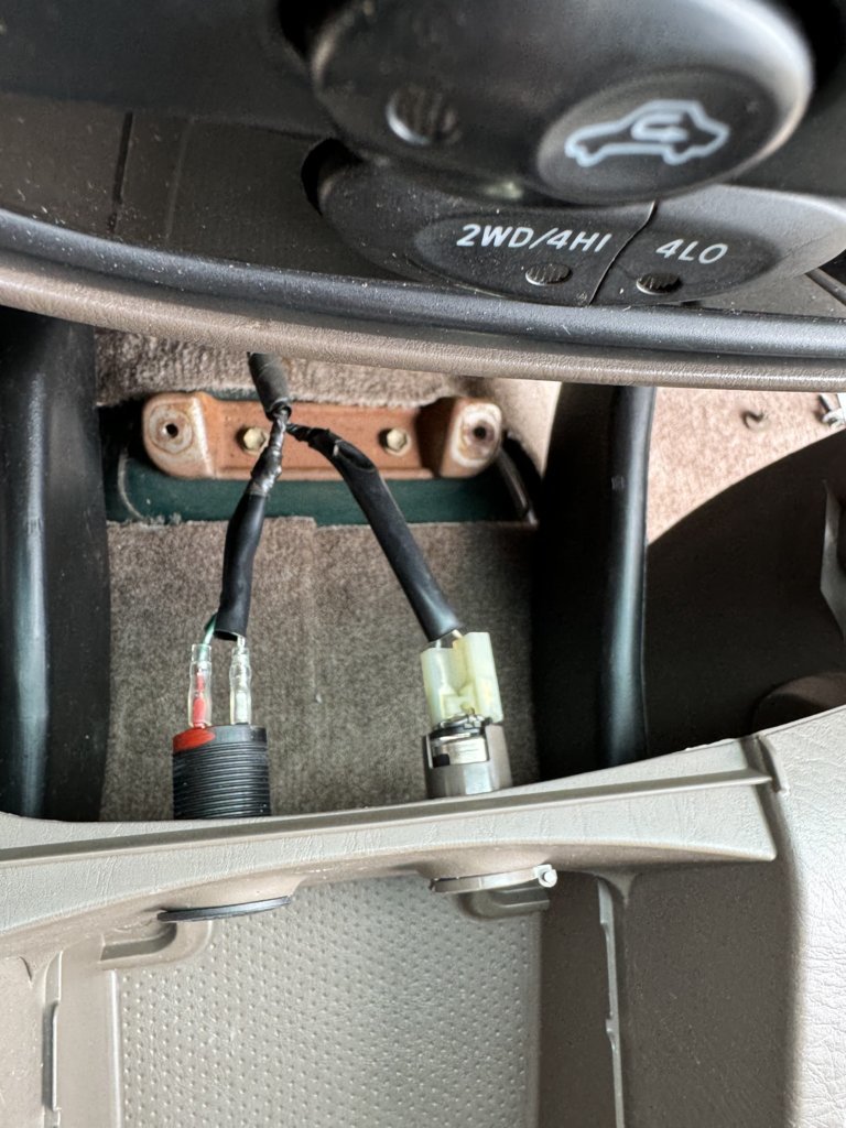

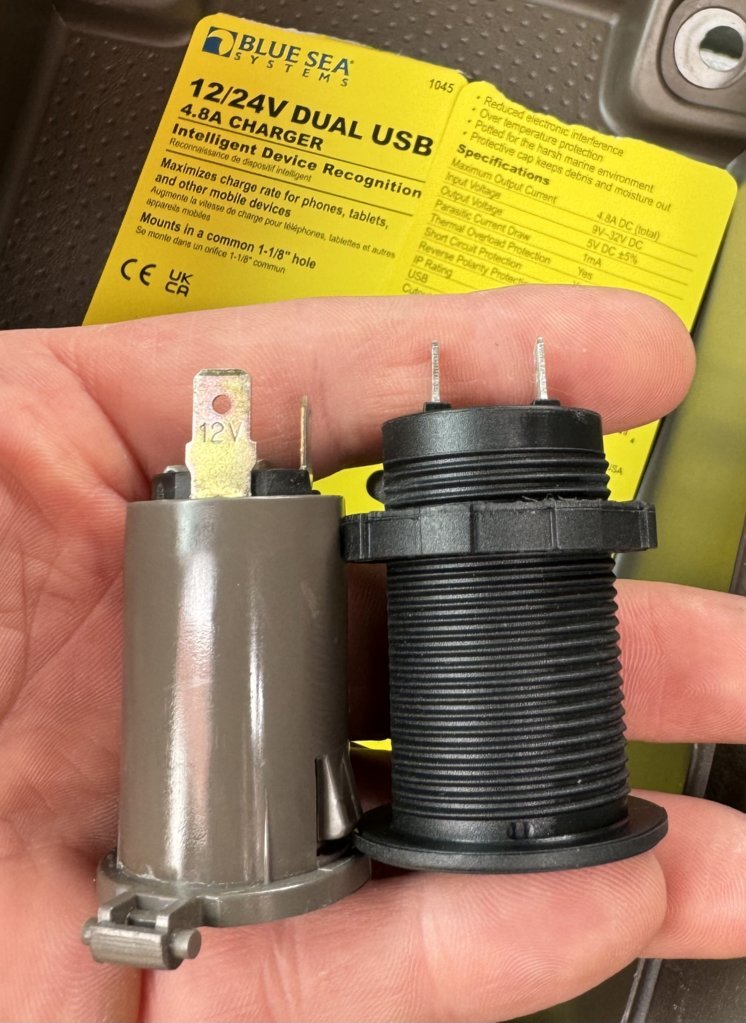

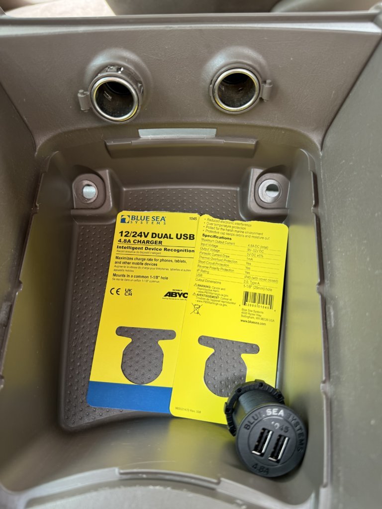

    I figured i’d update my thread here. I have been working on my truck on and off. Nothing major, just little upgrades here and there.

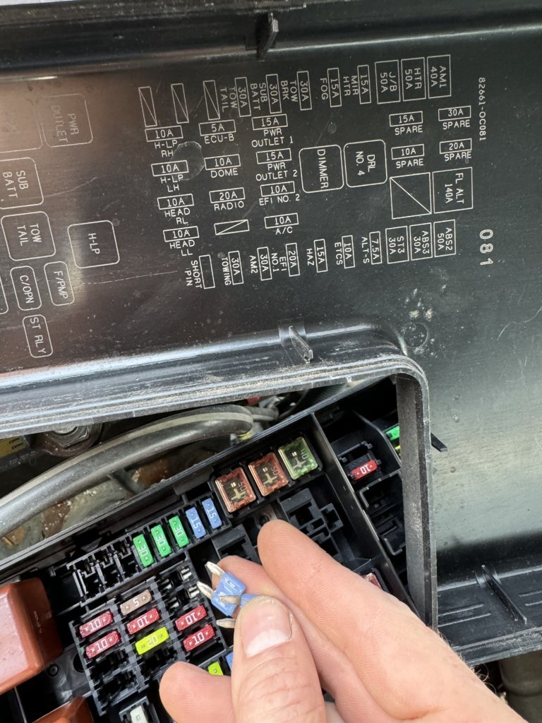

    One thing that has always bugged me was that the center two ciggy accessory plugs never worked. I’ve been wanting to install a USB charger in place of one of the ciggy plugs, so i finally broke out the multimeter so that i could get to the bottom of it…
    Turned out that both plugs are on separate fuses and the fuses are located under the hood…AND both fuses were missing! I have no idea why a previous owner did that. So it was a simple fix that i’ve been wanting to sort out for the past year.
    I swapped out of of the ciggy plugs for a Blue Sea charger. I’ve used them in the past and i’m impressed with their quality.
    The chickens came out to help me. Let me tell you just how helpful they are…

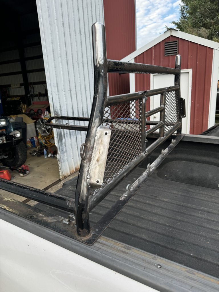

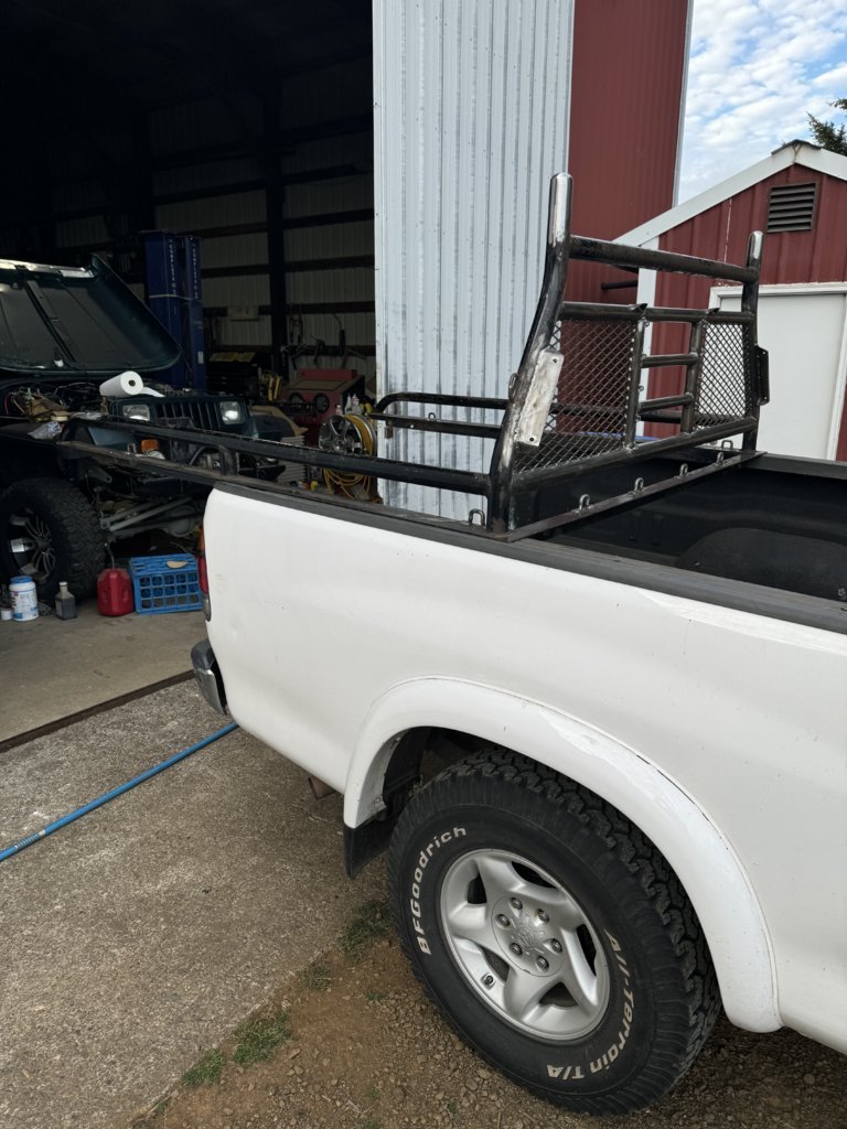

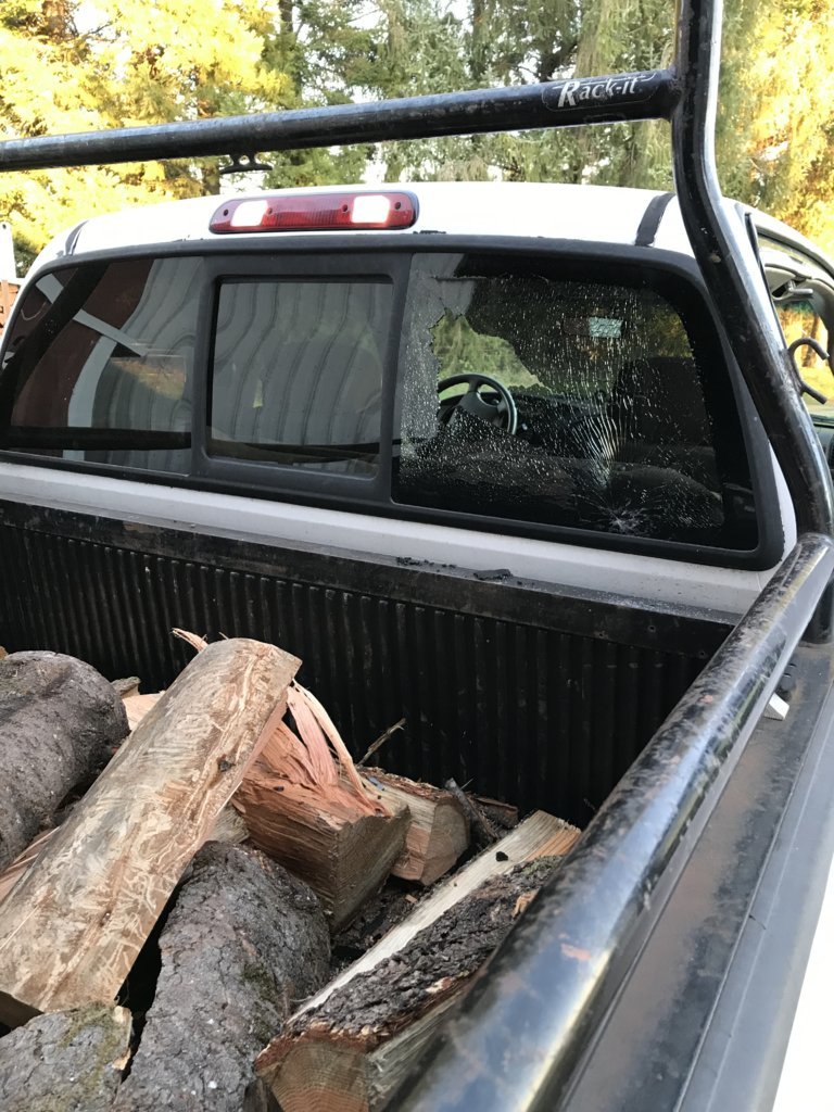

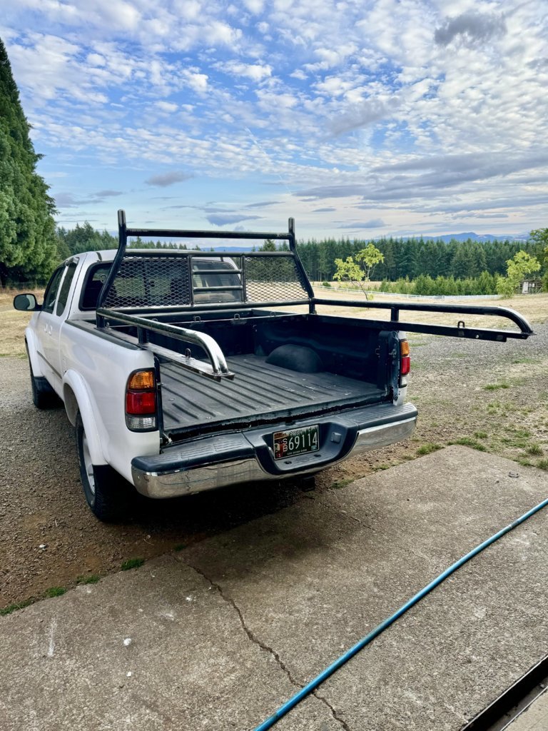

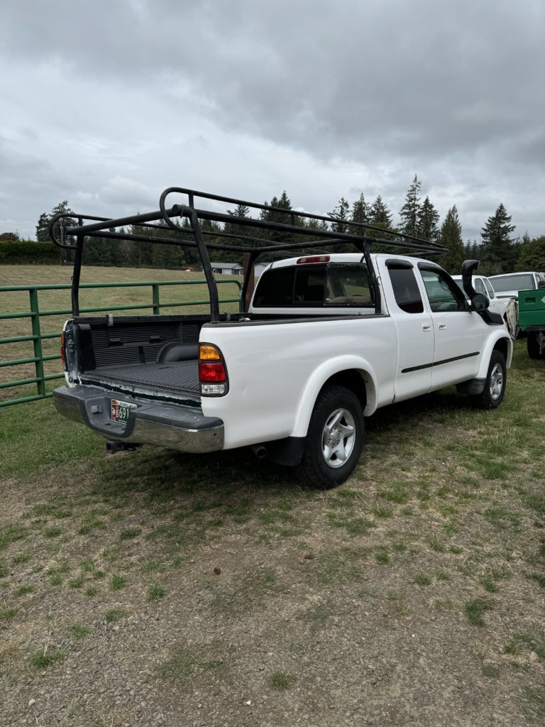

    I also modified my headache rack by adding in a screen and extra bars. I’m currently trying to decide what color to have it powdercoated, white or black.
    This is what the rack looked like before i modified it. Note the busted out glass.
    Wow, i didn’t notice how amazing the sky looked until i posted up this pic!
    Sharp eyes will notice all of the welded on tie down loops are off of a Tundra.

    I also picked up a different lumber rack last weekend. It’s a Rack-It brand, and i really like their racks. This means i’ll have to sell the other lumber rack that i bought last year.
    I do plan to weld in a screen to protect the rear window, but i’ll probably wait until next summer to do that? It just depends upon how much more dry weather we have here in oregon.
  22. Sep 21, 2024 at 5:52 PM

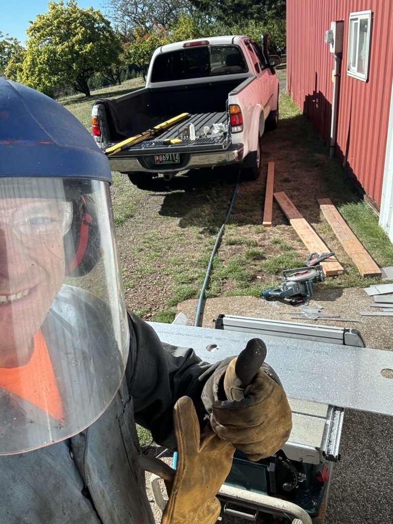

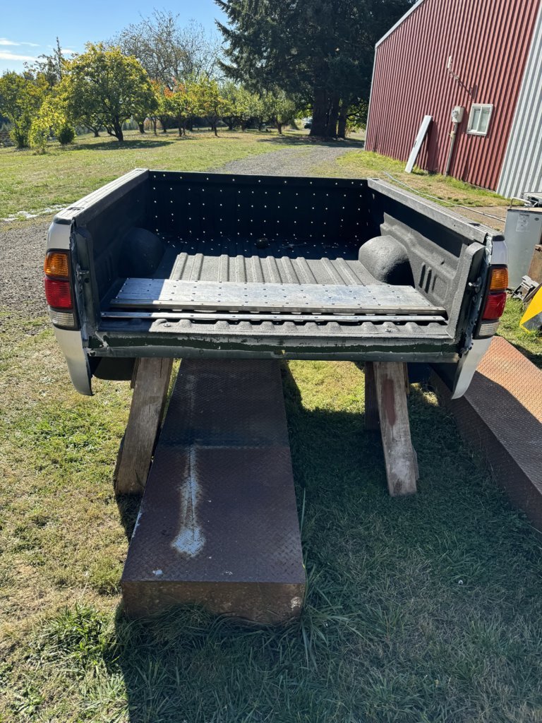

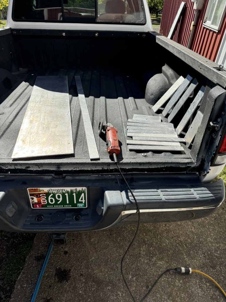

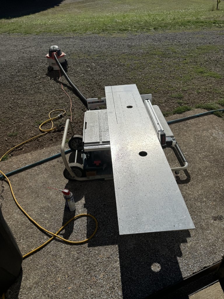

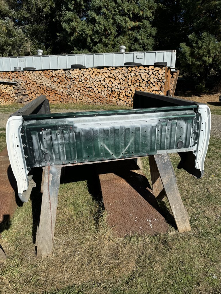

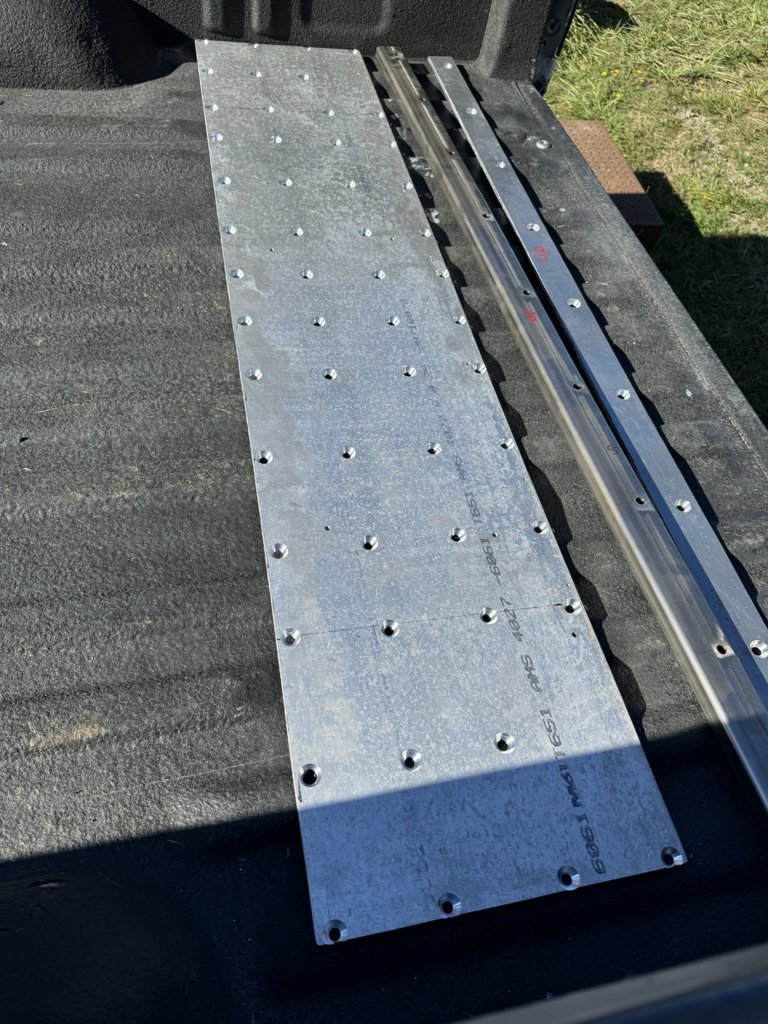

    I made my bed 1/4” shorter yesterday…
    Reinforcing the bulkhead on my bed has been priority one for the past year, but kept getting pushed to the bottom of my list of things to do. What i really wanted was to get a sheet of 3/16” 6061 aluminum, then get it sheared to size and then formed (bent on a brake) to come up and fold up and over the top of the bed rail. I couldn’t find any machine shop to do the work (all the local shops that i know of closed up shop in the past 5 yeast).
    Plan B was implemented. My buddy had a remnant sheet of 1/4” 6061 aluminum. I strong armed him into giving it up to me. He kept telling me he knows a guy who can shear the aluminum to the size i wanted. After months of my buddy telling me that and not following through, i gave up on them and used my tablesaw and skill saw to cut the sheet. I double upped on the safety gear…ear muffs over the top of ear plugs, and face shield over the top of safety glasses. I used WD-40 as my lubricant. I used a shop vac to clean up 95% of all the aluminum bits. The chickens ate the last 5%. Hopefully they survive. Instead of laying eggs, they might lay some pop cans.
    I had 3 friends come over and help me lift the bed off the truck and onto sawhorses. It took a loooong time to drill all the 5/16” holes through the bed and the aluminum. I’ll also be using flat head screws, so that meant i had to countersink all the holes as well. I might have overdone it a little bit with the amount of bolts, but at least i will know the panels will be more likely to be tight to the sheetmetal bed.
    The upper bed rail is going to be reinforced with .120” wall 1”x2” stainless rectangle tube. Then another 1/4”x2” aluminum strip will sandwich the sheetmetal bed rail. All the smaller 1/4” aluminum plate pieces will be used as backer supports on the outside of the bed’s sheetmetal bulkhead.
    I placed my order today with McMaster for all of the stainless hardwood. It should show up later in the week. The only downside is that it will all be covered 200% by the plastic drop in bed liner…and hopefully the bedliner will still fit with the additional 1/4” aluminum installed. Hopefully i’ll be able to update this thread before the weekend with the final product.
    Of course once again the chickens wanted to help…
    IMG_0754.jpg IMG_0749.jpg IMG_0750.jpg IMG_0751.jpg IMG_0758.jpg IMG_0756.jpg IMG_0759.jpg
  24. Oct 7, 2024 at 11:15 PM
    #294
    455h0le_dachshund
    Nov 21, 2023
    #107257
    8,530
    Rev. Hotdog
    TX...big surprise
    This is to reinforce the bed for your lumberjacking?

    Impressive hahaha, she ain't going nowhere! When your slaming logs like you do that will be great.
    I suspect mental shortcomings with the aluminum poisoning... but it may be hard to tell! :rofl::rofl:

    Yup, this is to protect the bed from all of the firewood rounds. The toyota bulkhead is super weak. I was super careful to go really easy when i was stacking rounds in the bed, and it was still pretty darn deformed.

    When I got my truck the back rail was nearly touching the cab. I was surprised how easily I corrected/bent it back... like a soup can :eek:

    Yeah the PO of my 03 hauled motorcycles with it, and the tailgate and front of the bed were both caved in. The tailgate caving actually caused the handle to work all wonky. Once I hammered the tailgate panel flat, the handle was totally normal again.

    There is a support structure panel that is spot welded to the backside of the front bulkhead. Since my bulkhead was bent in enough, it also bent in the support panel. I used a spot weld cutter to remove it. From there i spent about 30 minutes with a hammer and dolly trying to straighten out the bulkhead a bit. You can see the 1x2” .120” wall stainless rectangular tube that slips up under the lip of the railing. It provides a ton of structure in that area. I’m leaving out the support panel that i removed. In its place, 1/4” aluminum backer supports will be added.
