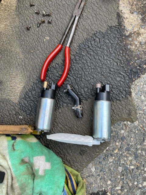

    Waiting for the new fuel pump to come in, decided to drop the tank early and get it ready, anyways, I found my problem.

    How the hell does that happen? :rofl:

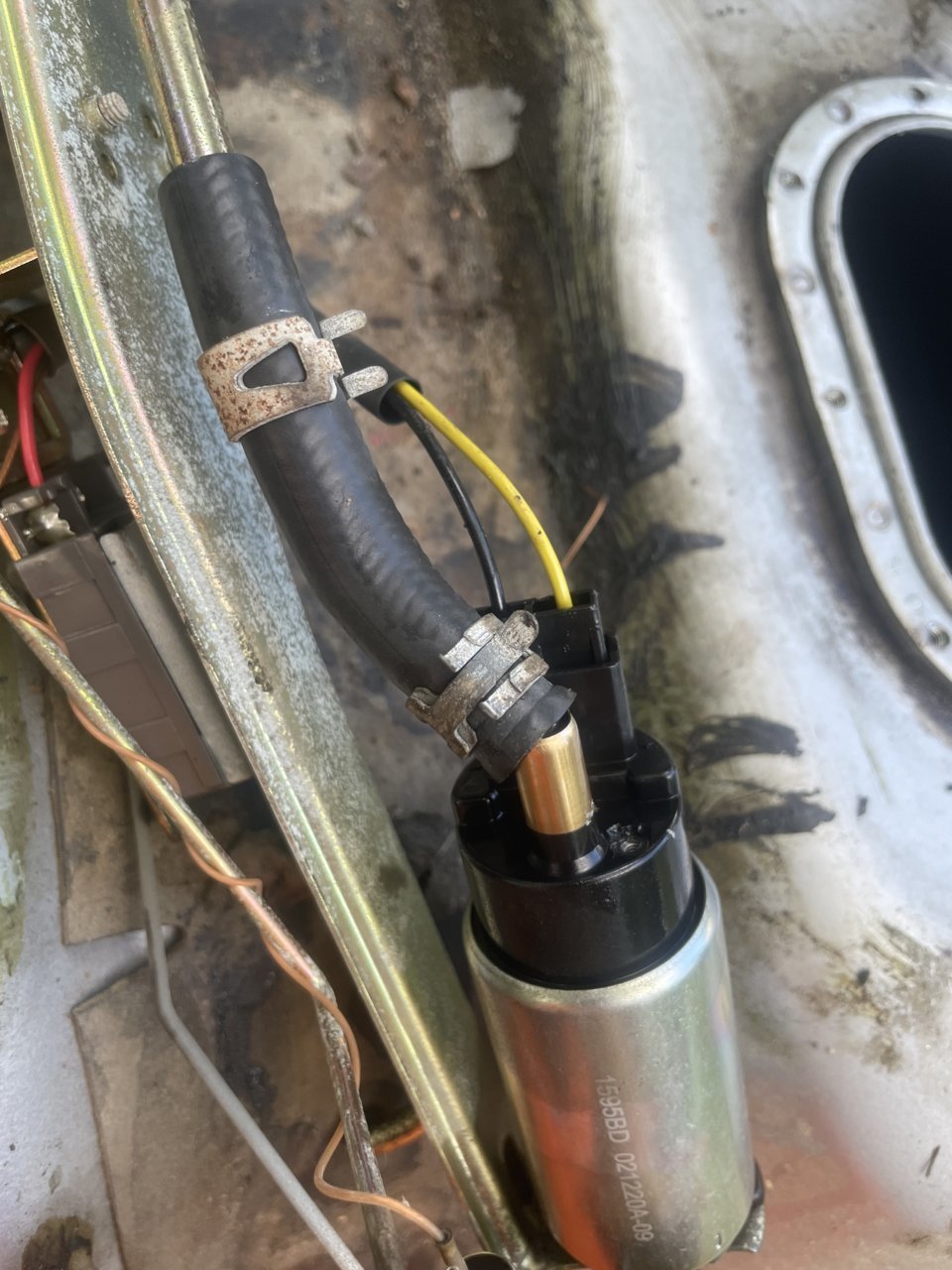

    P0171 code came back. Dropped the tank and the hose had worked itself off the fuel pump again. Decided to replace with a Delphi 0410 I had ordered a while ago but never installed and waited too long to return. There’s a difference in length and the short section of hose is much better quality and seems to be a tighter fit. Also the clamps feel like they hold better too.

    Damn, I have no idea how I missed this. I probably would've guessed fuel pump issue, but I would've never expected what was found! Appreciate sharing on this one.
