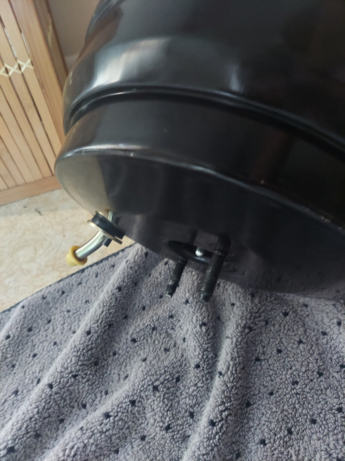

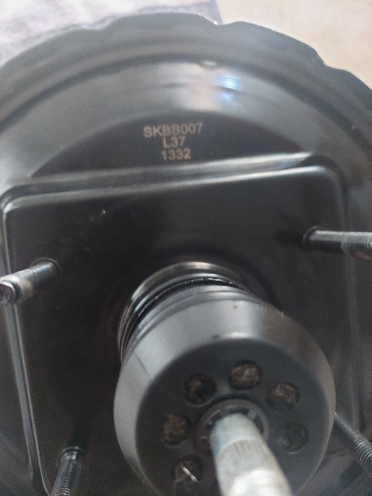

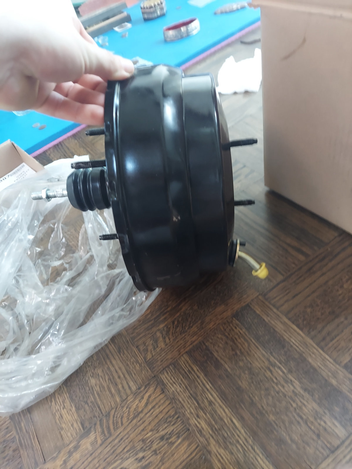

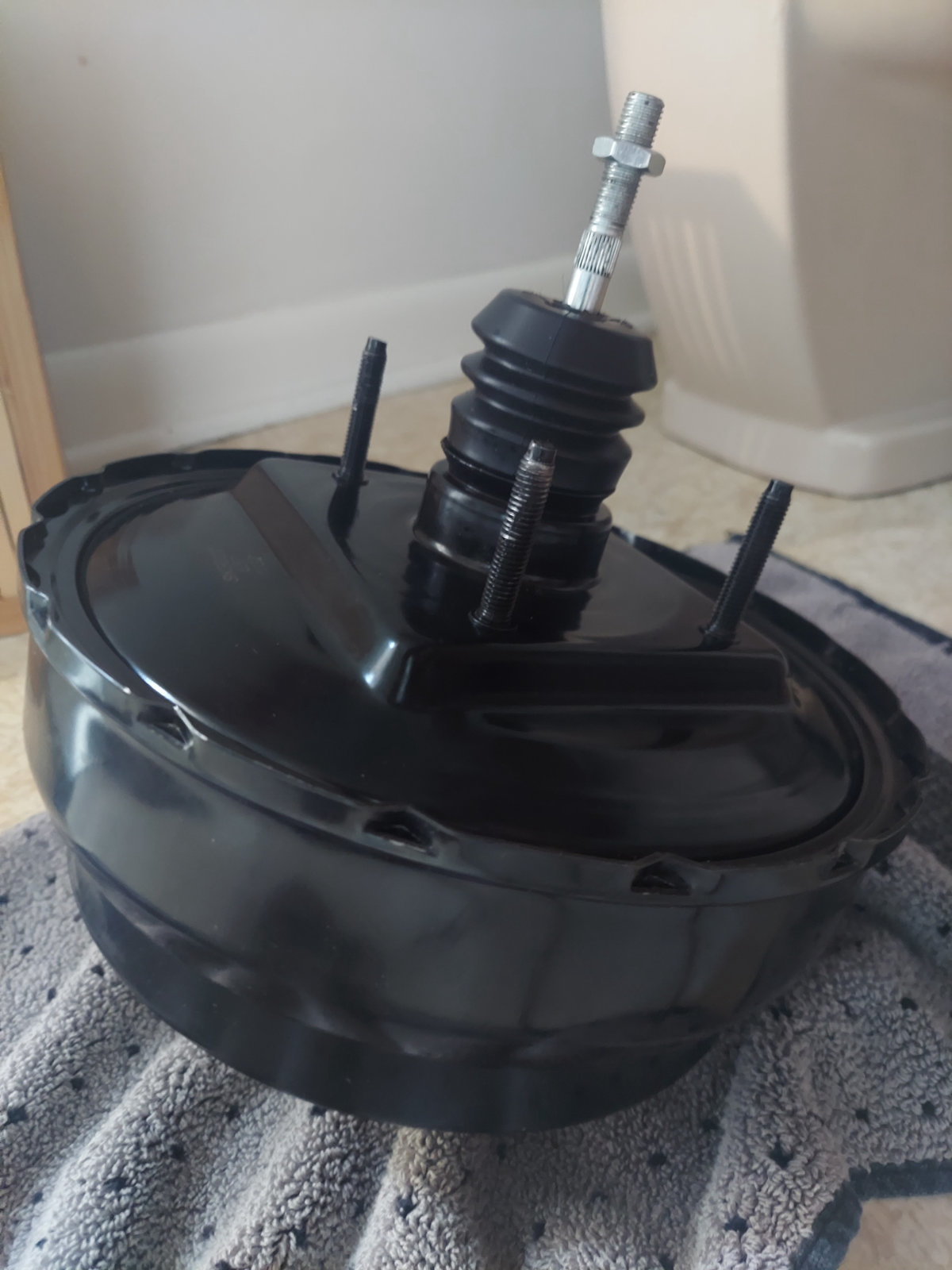

    jumping into this older thread here...
    i hear alot about there being two versions of the booster one with short and one with longer studs. the longer allegedly allowing you to use the aluminum spacer. does anyone have any info on this? do we not need the spacer? i saw the OP here didnt use it but in some other threads they did. just curiuous before pulling the trigger for my 2005 ac 4x4 with abs. thanks!

    I was told this was a good upgrade for our trucks. Others might know more. P/n on it is SK 007 L37 1332
    I have no incentive to sell , it was given to me, just trying to help u out. U pay for shipping you can have it. If it works just send me whatever i was asking for it and if not return is totally cool. Its new. If too much hassle no worries. I was told it was for a gx480 or t100 or something. Some guys on here can chime in im sure. 20240629_162347.jpg 20240629_162318.jpg 20240629_162339.jpg
