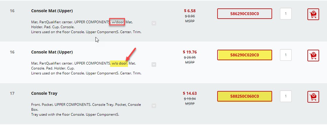

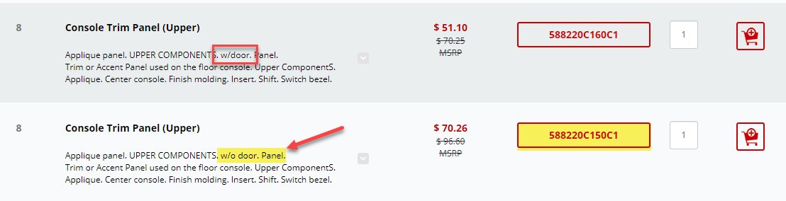

    I have found this - so order the 588220C150C1 which is for the no door cup holder conversion:

    and these items as well:
  25. Jan 9, 2024 at 8:56 AM
    #55
    jedi008
    jedi008 New Member
    Jan 9, 2024
    #109924
    8
    Pete
    Supersonic Red Tundra
    I am somewhat sure you only need those parts - I was using this store's site:upload_2024-1-9_11-56-2.png

    I successfully changed the over/under cup holder on my 1794 2024 Tundra to the side by side configuration! I bought the OEM parts from https://parts.lakelandtoyota.com/ All what needs to be ordered are 2 parts:
    Console Trim Panel (Upper) 588220C150C1 for $70.26
    Console Mat (Upper) 586290C020C0 for $19.76
    As for the cup holders themselves, I bought it from Michigan-base AJT Designs https://www.ajtdesign-llc.com/ They make a nice upgraded, oversized cupholder that is plastic injected molding (not cheap 3d printed!) and is only $52.00. They also have a video on how to take apart the console so to install the cupholders (also you can find it on YouTube: https://www.youtube.com/watch?v=0p0-j9Ea1OU )
    Total cost: under $150.00
