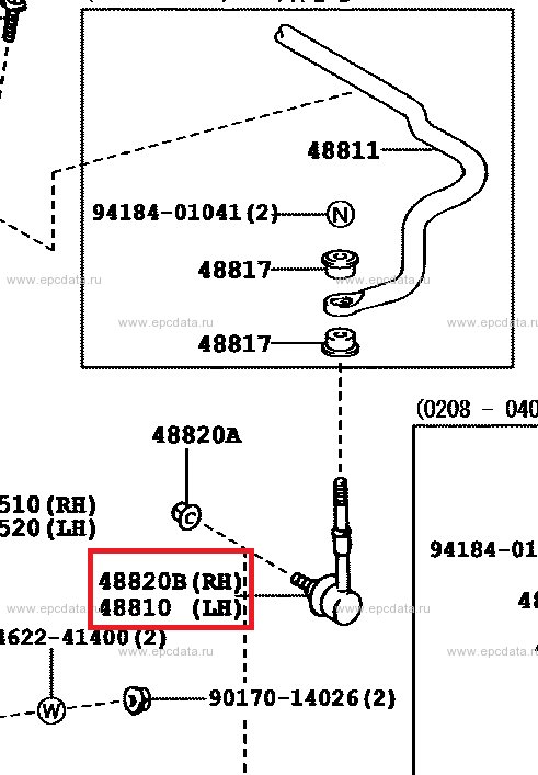

    Hey all, I'm looking to replace both of my front sway bar links on my 2002 Tundra 4x4 Limited AC. I've searched a lot of parts stores, and none of them say anything about a left or right one being different, but I looked on a toyota site that listed a different part number for the left and right fronts. Does anyone know if the same part be used for both sides?

    My 2006 Limited AC shows two different part numbers. When I pulled the OEM pieces though, they looked damn near identical so dunno.
    Look up your parts using the bullets here. Be careful what brand you order.

    They're the same on our trucks. The parts diagram isn't the part number, but an identifier in case there is a difference.
    For my 05:
    48810 LINK ASSY, FRONT, LH = 48820-34010
    48820B LINK ASSY, FRONT, RH = 48820-34010
