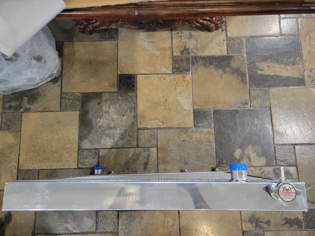

    Swapping my cracked / leaking OEM radiator with an aluminum aftermarket one made by Champion. Gonna flush and replace coolant as well obviously. How much coolant does a 4.7 take? Any advice on the swap would be much appreciated. Thanks.

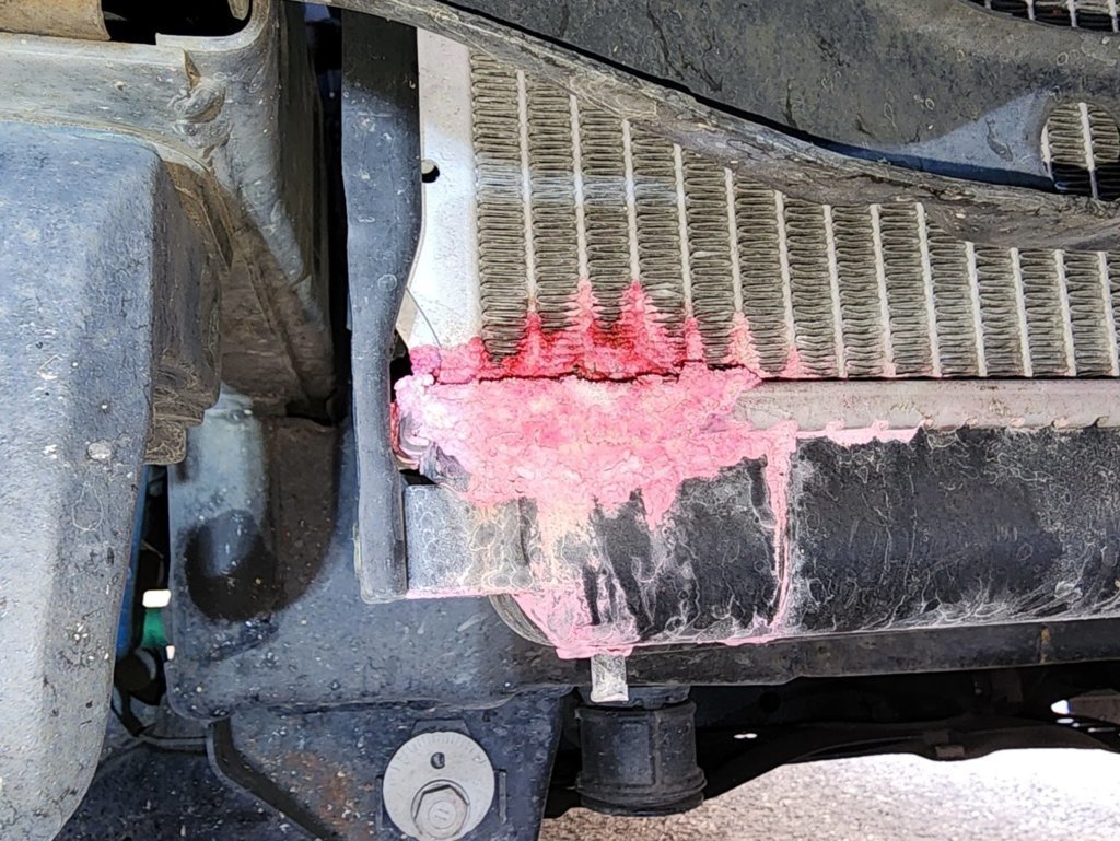

    I'm not the OP, but after my my second OEM radiator crimp failure (second one lasted me less than 2 years, see note below...)
    https://youtu.be/PnLXET6GBGw?si=TOviZQ8pXuaCahWc
    I ordered a Champion all aluminum radiator. Hopefully I'll get it shipped and installed within the next two weeks and I'll update then.
    Note: when I spoke to the Toyota dealership where I bought the second OEM radiator, they told me the radiator they sold me was an "OEM replacement" and not actually a genuine OEM. A genuine OEM radiator would have cost me $500, whereas the Denso OEM replacement was only about $160. Something to think about when buying OEM...

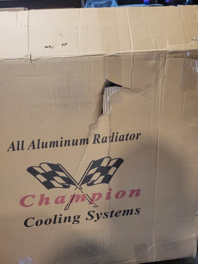

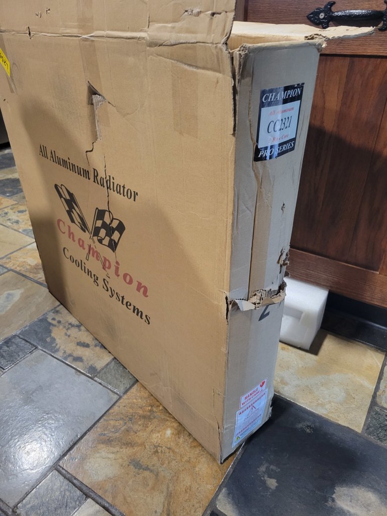

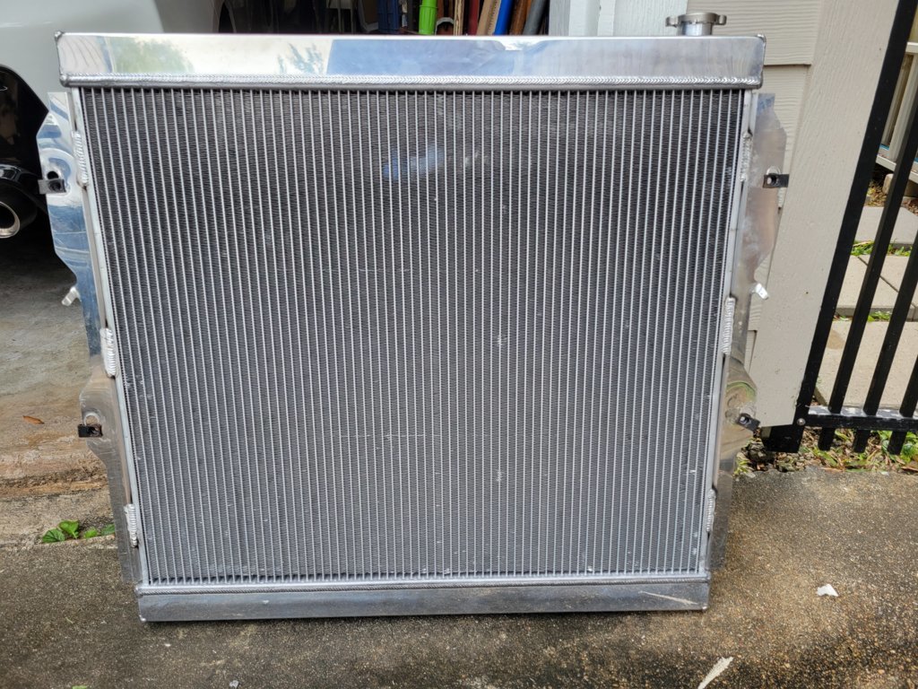

    Whelp, quick update:
    Good news - radiator arrived earlier than expected.
    Bad news - Ace Ventura works for Fed Ex.

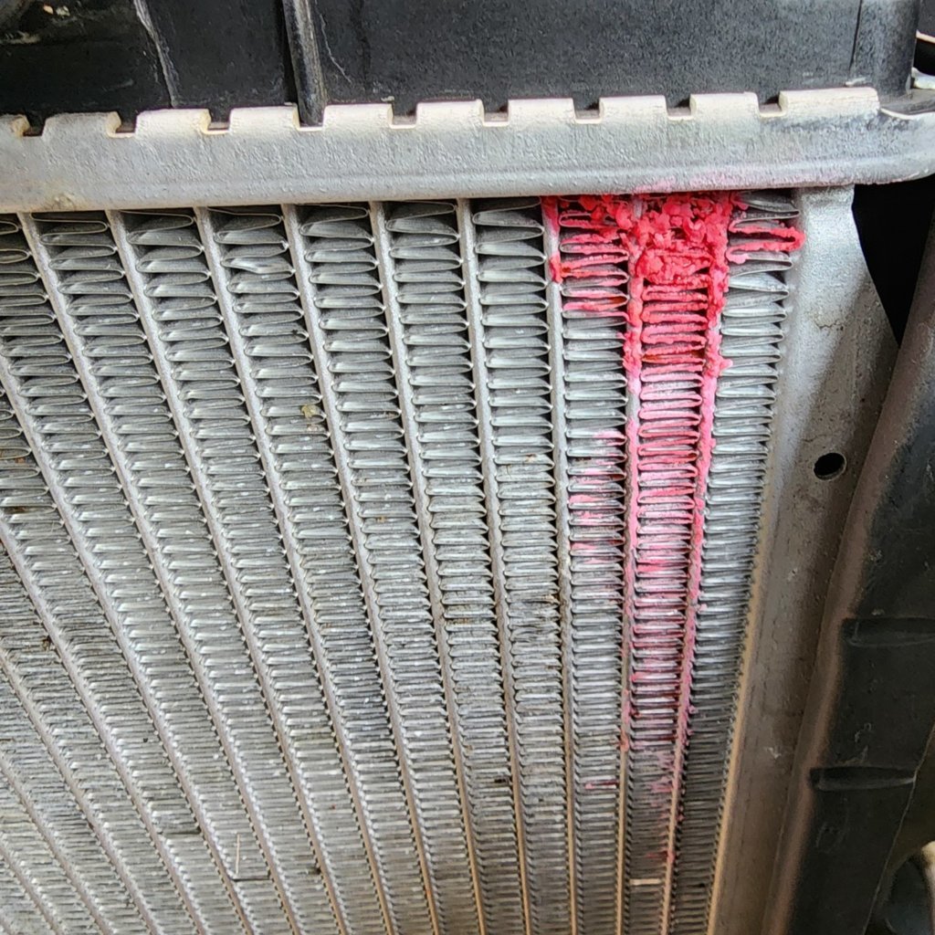

    Called up Champion and spoke with Jeff and George to ask them if the damage was bad enough to warrant an exchange. They said it didn't look bad enough to leak but they'd send another one just in case. So much for slapping it in over the weekend, but definitely appreciate their help.
    Side note 1 - The box has a sticker that says "CAUTION, use only ethylene glycol antifreeze/coolant and distilled water for this aluminum radiator (Use the Green stuff!)" So I asked about using Toyota "Red stuff" (see last pic) instead of the green stuff and they said it was fine.
    Side note 2 - I also didn't realize Champion has a lifetime warranty on this radiator, maybe because it's all aluminum? For trucks that last 400-500k, that alone makes this a very worthwhile upgrade.
    If Houston has some dry weather this weekend I may still pull out the oem radiator and take some pics/measurements next to the new one (aka the paperweight) and check fitment just for fun.
    I'll keep you guys updated.

    Glas they are sending you a new one.
    I've owned radiators with worse damage than this not leak, and I don't believe it would leak but you might as well install a pristine one if they send it to you. That's what you paid for after all, right?

    And before these two, I had another one fail at the crimp on my '07 Sequoia.

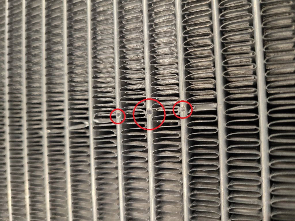

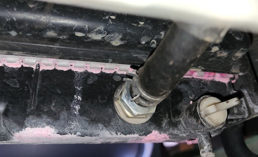

    These are the damage points I'd be concerned about. Specifically the middle circled one. If this gets bolted up instead of the replacement, I'd ensure you don't see a leak in that spot with the pedal at 3k-4k RPM. Each of those vertical tubes is carrying coolant.

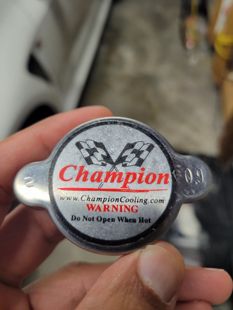

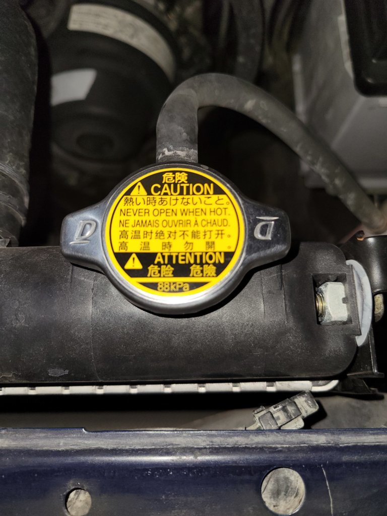

    What PSI is the Champion radiator cap rated for?
    My truck builds a lot of pressure in the cooling system. I replaced the cap with a new one but it made no difference. It does not seem to flow back and forth between the radiator and overflow. I think the aftermarket radiator I have has something funked up with the water neck that doesn't allow the plunger on the cap to function properly
    Weagle likes this.

    Stock radiator cap says 88kPa, which is 12.76psi. The Champion radiator cap has 0.9 on it, which I'm assuming is in Bar, or 13ish psi. Simple question, so much math...
    Also, Champion said for me not to bother returning the damaged radiator. Tracking on the new one shows it should arrive Thursday the 7th.

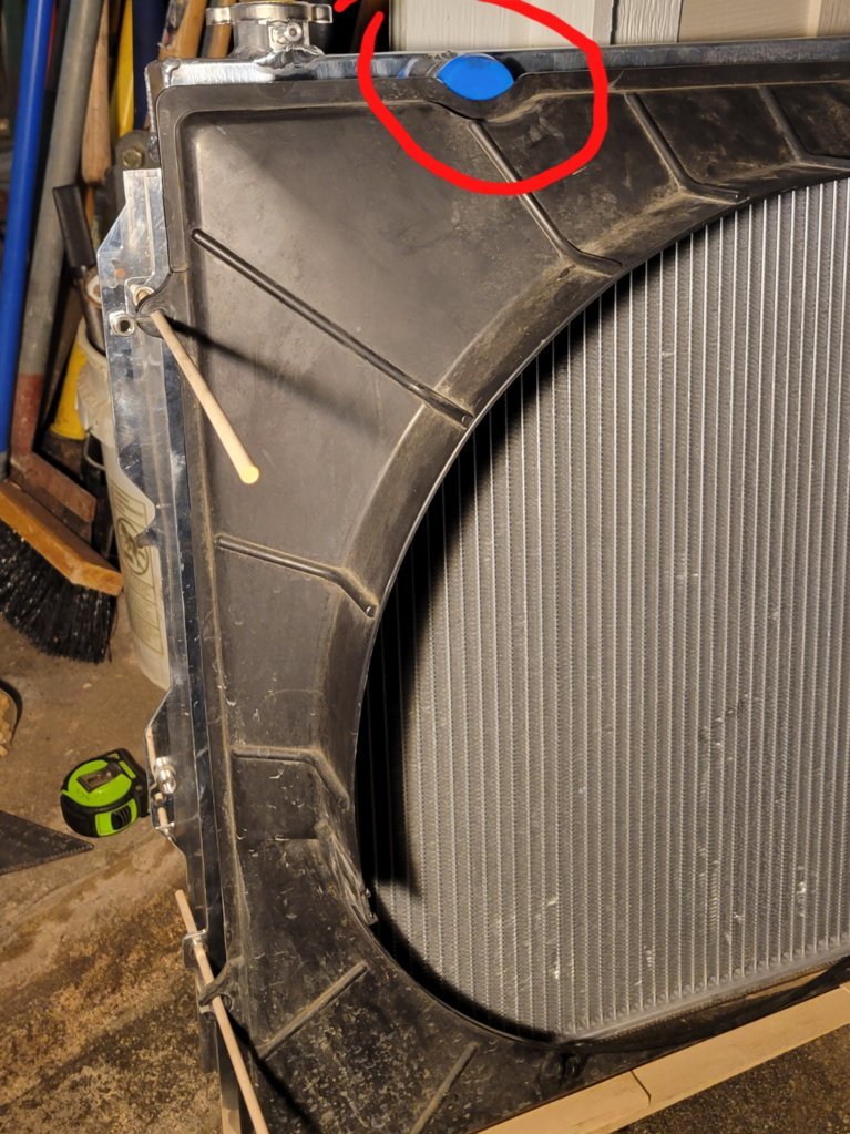

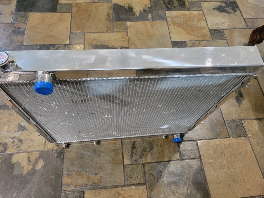

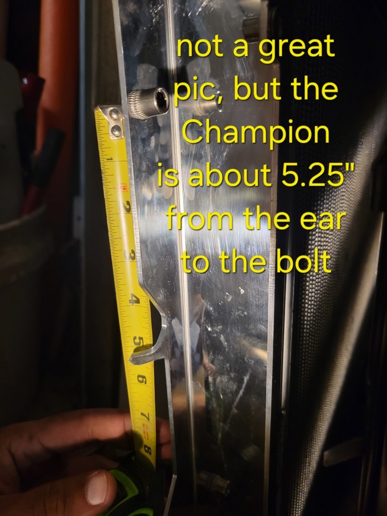

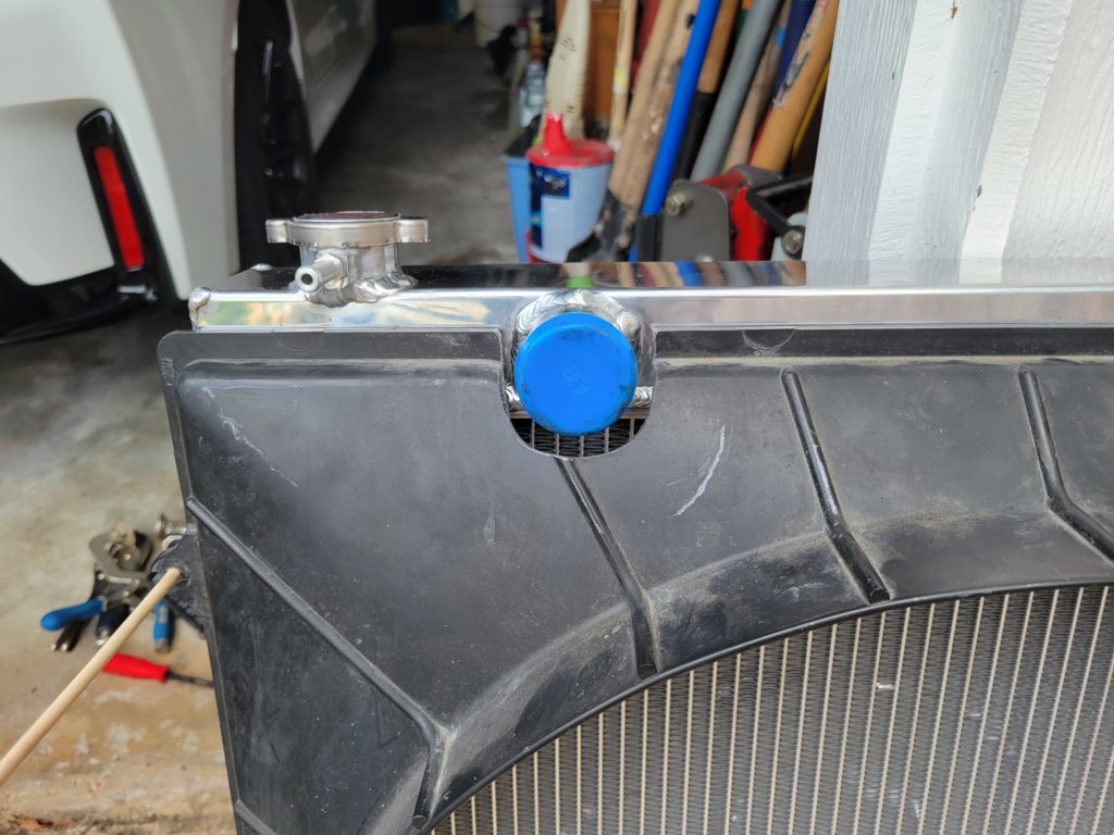

    *Spoiler alert* If you have a DC, DO NOT GET A CC2321 CHAMPION RADIATOR!!! I don't know how different RC and AC radiators are, but I guarantee the CC2321 is definitely not correct for DCs no matter what Champion CS tells you.
    That being said, it's too late for me, so the remainder of this post will be one nearly continuous rant...
    Replacement radiator arrived from Champion today. Much better packed this time.

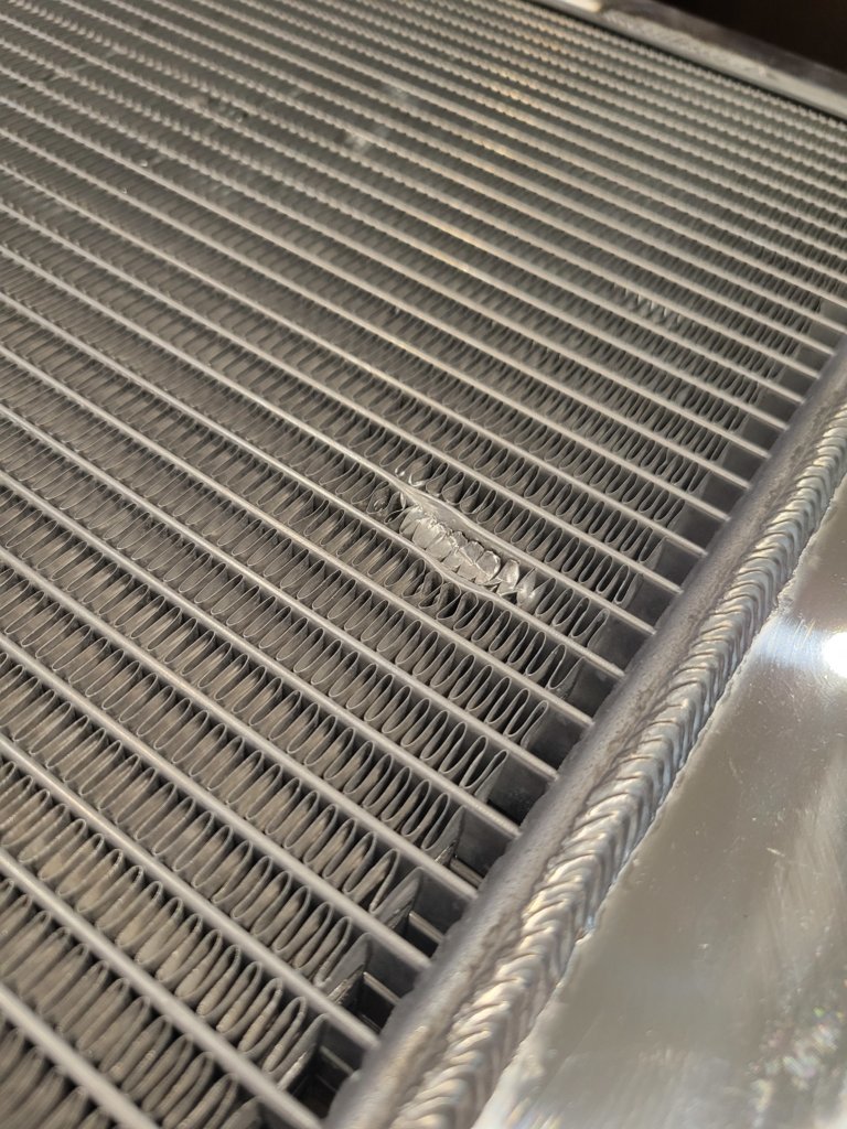

    Somehow, though, still some minor damage...
    The minor dings weren't a big deal but yes, that is some serious warpage going on. Was able to get it straightened back out with some precision stomping from the better half.

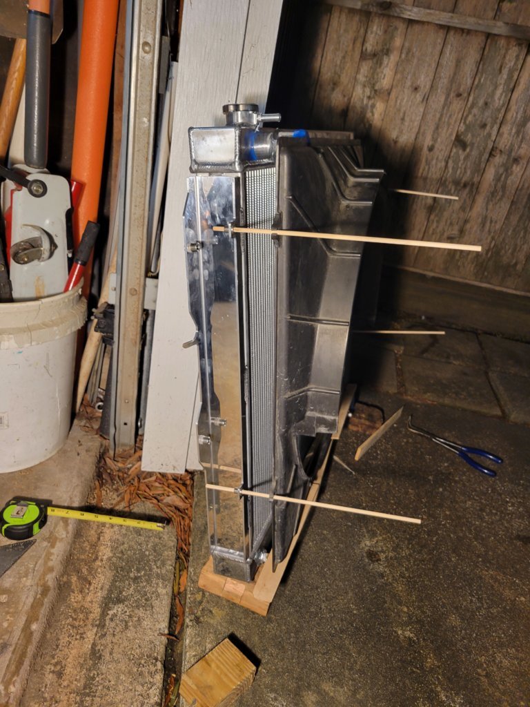

    Great... drain coolant (just over a gallon if anyone is curious) disconnect hoses, pull the bad OEM radiator, drop in the shiny new Champion radiator, and find out the ears hold it too high for the bolt holes to line up properly. Hmm...

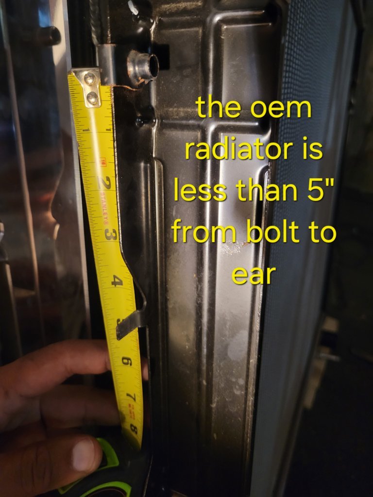

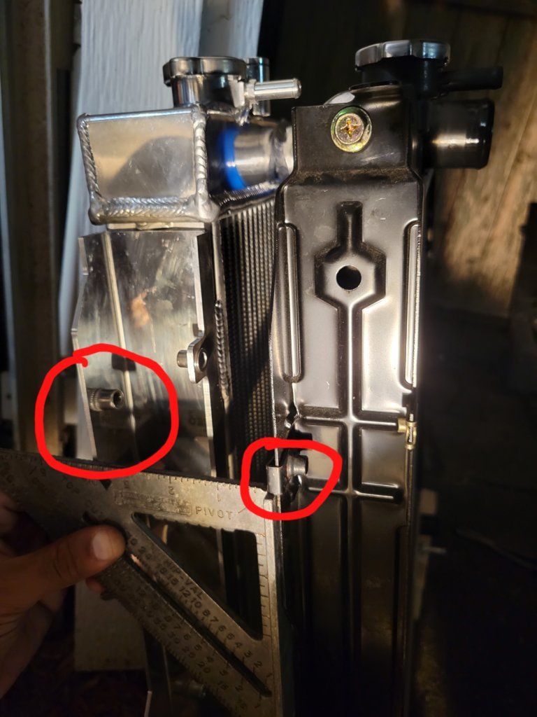

    Pull out the shiny new radiator, line it up next to the old one, and start measuring. Here's where the fun starts...
    Looks like the mounting hole locations on the Champion are about 1" higher than stock so the radiator will sit a little lower. Fine... let's keep measuring...
    OK, looks like I'm slotting holes and retrofitting the oem nut clips. Fine... now let's check the fan shroud...
    Looks like we're trimming the upper hose opening too...
    So a 1-2 hour job has just become a half a day job, yep, done for tonight, I'll get back to it and you guys tomorrow.

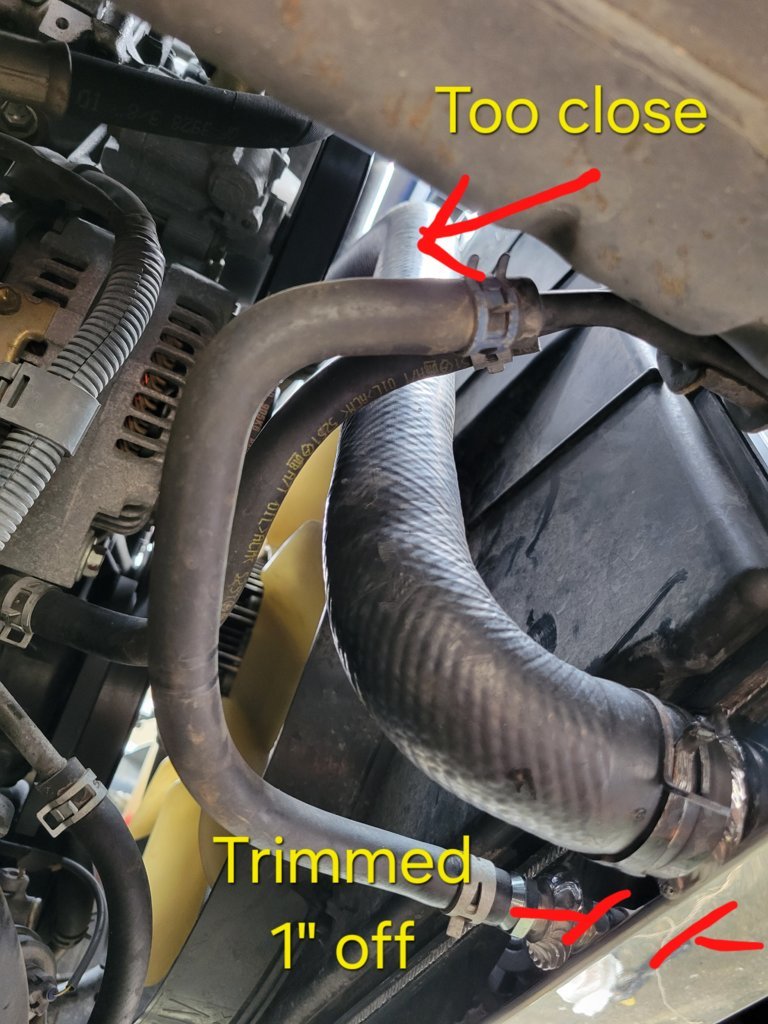

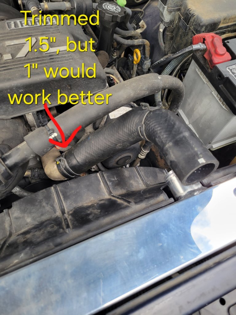

    Finished the install and I'm fairly happy with the results. Total time invested on just the install, about 4 hours. Holes slotted, oem radiator nut clips in.
    Fan shroud trimmed and fit checked.
    Radiator sits a bit lower, so I trimmed upper and lower hoses. Also because I'm ocd...
    Top:
    Bottom:
    Refilled with the old coolant because 1. Had new coolant in it from a few months ago, and 2. Finding a place to dispose of old coolant is a pain. After that, added another 3/4 gallon to top it off, assuming that's due to the extra row of the new rad.
    End result: Radiator looks great and fits great (now...). Tundra running good, although the trans seems to shift just a tiny bit harder than before but that could just be my brain looking for another issue. Best guess, between what came out of the two trans cooler lines and what was left in the old unit I lost less than a cup of trans fluid, but I'll check it tomorrow.
    Next time I lose a radiator, Denso and now Champion are definitely crossed off my list (or moved to the bottom as absolute LAST resorts)
    It would be nice for readers in the future to have a list of some good replacement options. Anyone have good experience with aftermarket radiators, oem+, that just work?

    Curious about the Denso failures. What exactly failed? External leak? Or internal leak as in the cooling loop for the trans?

    Aluminum to plastic tank crimp failures:
