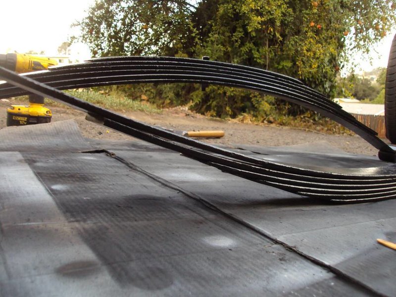

    What you see pictured is a set I put together for a 2nd gen Tacoma that tows relatively heavy & often, I've rebuilt springs for about 200 Tacomas on another site...

    So what would you build? Use current spring pack and add what?

    Sure no worries.... When I build a set of springs for towing , I look for springs that are slightly thicker & have very little ARC to them, these are what I'd use for donor springs to add to stock leafs (usually off early Chevy/Ford trucks) I get these at the local wrecking yard. Since towing a trailer puts a lot of down force on the shackle end of the springs, I'll cut & configure my donors accordingly to reinforce & stiffen up the shackle end, this stops a lot of pitching & diving ("swimming" of rear end) while turning at speed & stops the wandering of trailer whilst maintaining a straight trajectory down the road/freeway/expressway/etc;..
    Here's a link to my spring thread on another forum, it may help clarify what I'm talking about....
