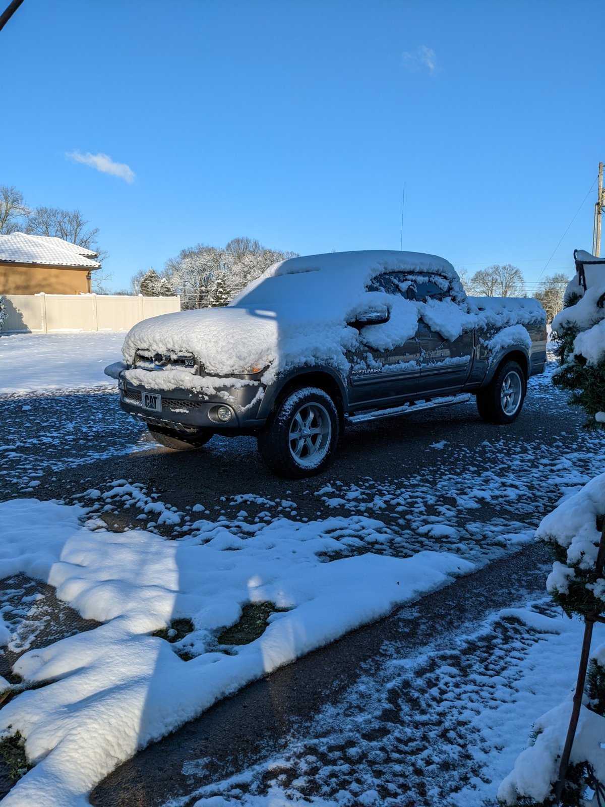

  10. Dec 25, 2023 at 10:36 AM
    sflips
    sflips New Member
    Jan 2, 2019
    #23839
    95
    Middle Tn.
    2006 DC XSP
    PXL_20220103_143604008.MP.jpg It's a XSP package so it came with 20" wheels. 5100s front and back original springs and nothing done to rear springs. Don't have many pics of the truck, this is about the best I could do showing the stance.
    KTM_AJ421[OP] likes this.
  11. Dec 25, 2023 at 10:46 AM
    KTM_AJ421
    KTM_AJ421 [OP] New Member
    Sep 1, 2023
    #103221
    602
    AJ
    2006 SR5 DC 2WD 4.7
    265/75r17 M/T Baja Boss AT 17x8.5 -10mm SCS Ray 10’s Bilstein 5100’s 2nd notch
    That looks great I may just go this way for now. I really didn’t want to have to go with new tires yet my 265’s only have about 1000 miles on them

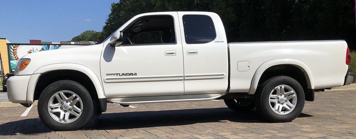

  13. Dec 25, 2023 at 11:26 AM
    ATBAV8
    ATBAV8 Mr. Bentley-He builds fast trucks.~Ettore Bugatti
    Dec 1, 2023
    #107779
    1,071
    Tempe, AZ
    2003 V8 SR5, Access Cab, 4x4, White
    Bilstein 5100s with OME 2884 springs, Firestone RideRite airbags.
    Here's mine with 5100s on the 3rd circlip. Nothing but 5100s out back. 265 70 R16. Tires have about 300 miles on them.49D7940D-0890-44B5-8E2B-2B3FF167D88D.jpg
    shifty` likes this.
  14. Dec 25, 2023 at 11:29 AM
    shifty`
    shifty` Doris the Finkasaurus
    Jun 20, 2020
    #48239
    34,394
    ATL
    '06 AC Limited V8/4WD
    And putting that in perspective, my last pic is about what you'll probably get on the 4th or top circlip on 5100s. Here is a quick Photoshop lowering roughly -1.5" in the front, so basically 0.5" lift in front alone, which is roughly what you'll get from 2nd circlip on stock springs - and that's what you'll probably see using the 3rd circlip @ATBAV8 just posted while I was tossing this together:
    KTM_AJ421[OP] and ATBAV8 like this.
