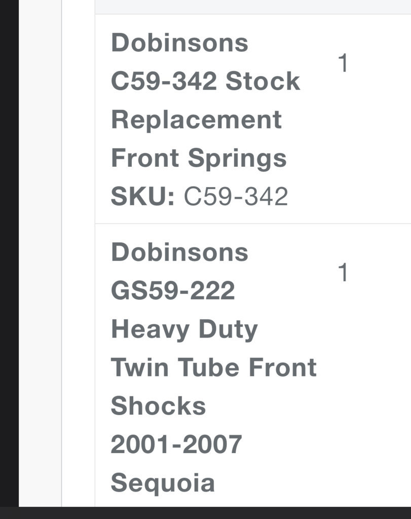

    attached is what I ordered. There were also 1/4” shims Josh from 1stgenoffeoad said I needed. I had them mess with the coils so I could just plug and play.

    from what I can tell, these aren’t adjustable, at least according to their description on 1stgenoffroad.

    Adding spacers will not achieve the desired effect. They will raise the front end so it doesn't look like your springs are sagging, but your springs will not be supporting the added weight and your ride will not be good. Additionally, if you add weight to the front and use a coil spacer, you definitely need to add spacers to your bumpstops otherwise you will bottom out the shocks and destroy them. Spacing out your bumpstops will reduce your available wheel travel which is a negative. Spacers can also cause issues with clearing your UCAs, depending on whether they are stock or aftermarket.
    Your best option here is to swap the springs that came with your Dobinsons for ones that are longer. The C59-342 springs you have are meant to maintain stock height with no weight added. Switching to Dobinson C59-344 would be the best way to maintain your current shocks. C59-344s are meant for 1.75" lift with no weight. With your added weight, they will provide less lift.
