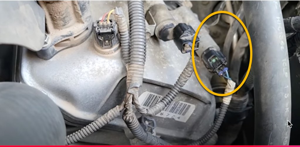

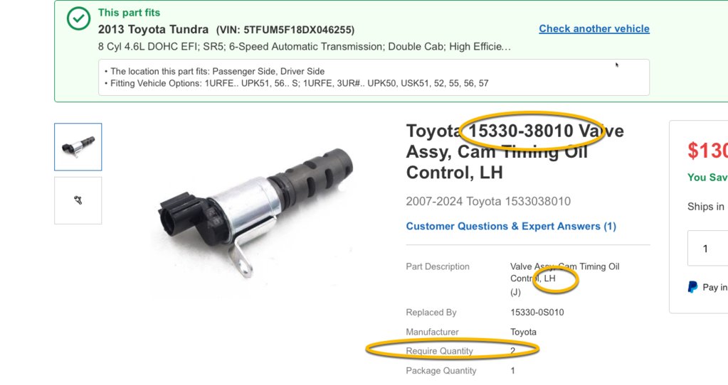

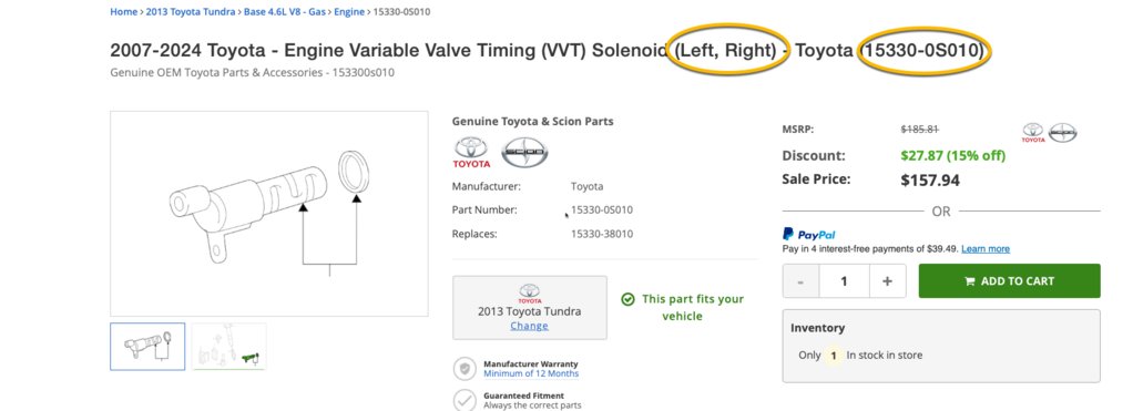

    I have a 2008 TRD with 100,000 miles. I have owned it since new. I recently experienced this problem and looked to this site for help. I replaced the fuel pump, cleaned the throttle body, replaced the torque converter and a couple other items. Still the same annoying surging. No codes or engine lights. Finally got a check engine and was able to figure out the problem. My Bank 1 VVT solenoid. Replaced this and it fixed the problem. I assume they were going out which was causing the problem but not bad enough to throw a code. I wanted to post this in case someone else is still chasing the ghost.
