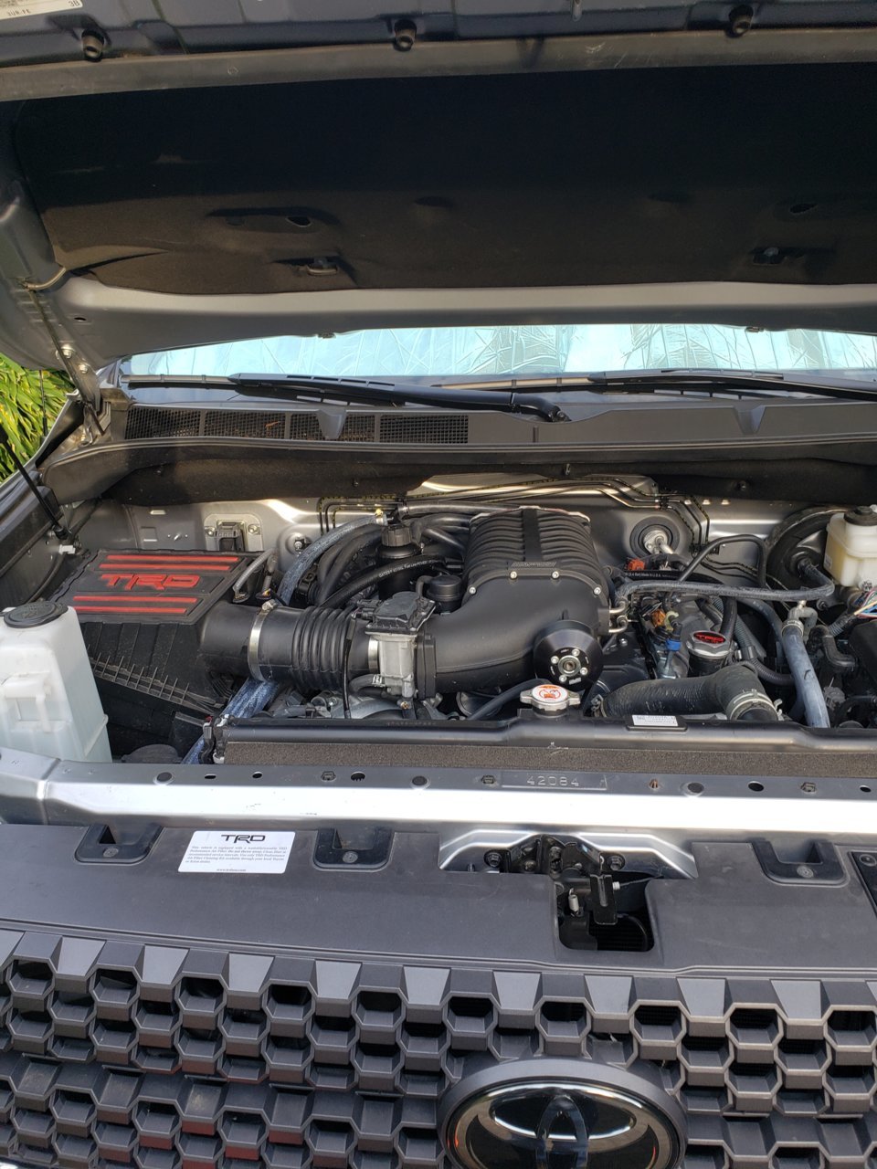

    20200203_162744.jpg 20190427_192651.jpg 20200117_153624.jpg IMG_20191231_131911_318.jpg Harrop installed!
    Some interesting things to know about this kit if you have a 2018+ Tundra.
    With the "Stage 1" setup, you do not need larger fuel injectors. Also, Harrop states "No calibration required" if the kit is installed completely, without any added modifications (Headers/smaller pulley).
    There is a modification made during the installation to the fuel regulator to increase fuel pressure.
    Stage 2, you'll get a 80mm pulley, replacement fuel injectors, and you'll need custom tuning.
    I just drove it home from the performance shop, man, it runs like butter, and effortless power!
    I am doing custom remote Dyno tuning with OV, to get all the features and optimized performance.
    Anyway, more videos

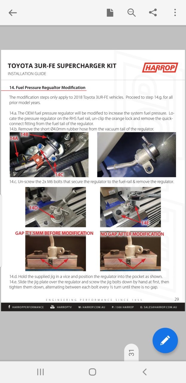

    6 to 7lbs. I'm data logging with OV. I'm currently at stage 1, which includes the replacement fuel pump. The fuel regulator for 2018, 2019 and 2020 is "modified" during installation for higher pressure. When I move up to stage 2, I'll install the larger injectors(I already have in my garage) and 80mm pulley, including a OV remote Dyno tune (93 octane).
    The truck runs really strong with the stock tune, but this week, I loaded my base tune from OV, now logging for revisions.
    I tow my Airstream quite a bit, so the tuning will be focused towards that.

    Are you talking about the fuel pump? As in you replaced the fuel pump? Im assuming you are non flex fuel. The Flex Fuel installation manual does not recommend replacing the fuel pump for the Magnuson, so mine was not replaced.
    Question to anyone and everyone, is this something yall are doing routinely. Specifically, if you are supercharging your Flex Fuel Tundra with the Magnuson, are you upgrading the fuel pump?

    I'm not supercharged yet, but will be very soon. I'm also flex fuel. Everything I've heard says we don't need to change the fuel pump or injectors with the magnuson. Non flex fuel will require them to be swapped when installing though.

    Correct, I'm not flex fuel. I also got a used supercharger and it didn't come with the pump, so I got the largest "bolt in" option which was the Aeromotive 340 to have some "extra" margin for fuel delivery.

    I'm not flex-fuel. My replacement fuel pump was installed.

    Right about the fuel pump. But our injectors and spark plugs are replaced. Here's the table of contents for the 2010+ Flex Fuel Magnuson Supercharger Tundra install instructions.

    Right. I've had a look at the differences in install between Flex Fuel and Non FF. The non FF install includes a fuel pump replacement, whereas the FF install does not. Just wanted to be sure I wasnt missing something and the FF guys were gettin' gains from a fuel pump replacement
