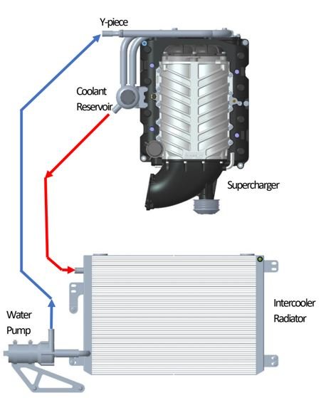

    I think this should be the whole picture. (hose shown in blue is the only hose described in the instructions. Hoses shown in red are my guesses)

    This makes sense. These instructions are definitely not as Thorough as the Magnuson kits. I'll have to have Harrop answer a few of my questions before the installation.

    I would think the lines you drew in the pump would be flipped. Center being the inlet and outer port being the outlet.

    You are right, here is the correct picture. I got it from Harrop

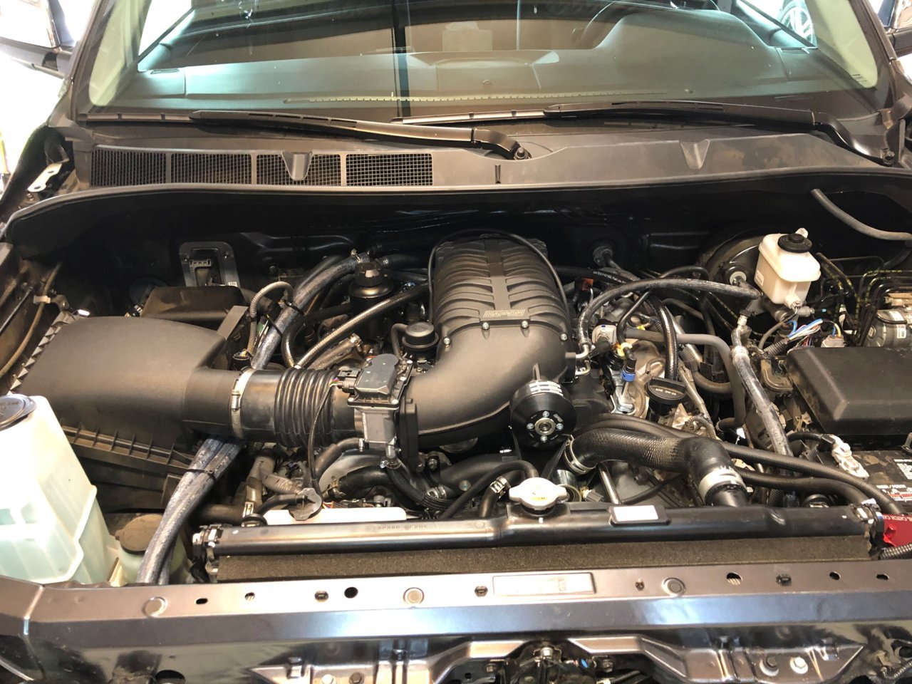

    Harrop installation complete. There were a few missing instructions but Harrop contact was very helpful in resolving them.harrop1.jpg

    Pretty sexy!
