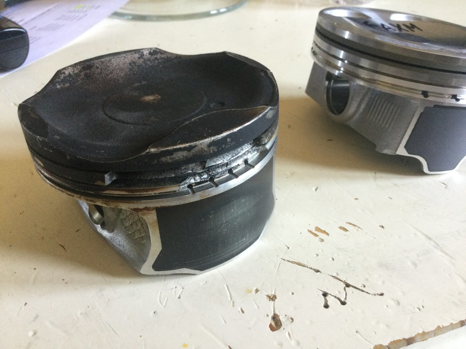

    Here’s the piston from a friend’s 2.5 gen TVS1900 FFV with Bullydog. In all fairness, it did make it to 99k miles… the extended warranty company wasn’t happy shelling out for a short block so close to the 100k limit, but they did.

    In my opinion, based on my somewhat limited experience (I only spun bearings on one engine, blew a piston ring land on another and broke a couple of rods on the third one :) ), the stock Magnuson/Toyota TRD tune sucked, and the BullyDog made the engine even more likely to grenade.

    @ViktorG I fully concur with your assessment! Bullydog is total crap...

    All I’ve read in regards to bullydog since following the boosted tundra scene is that the bullydog SC tune is an engine grenader special.

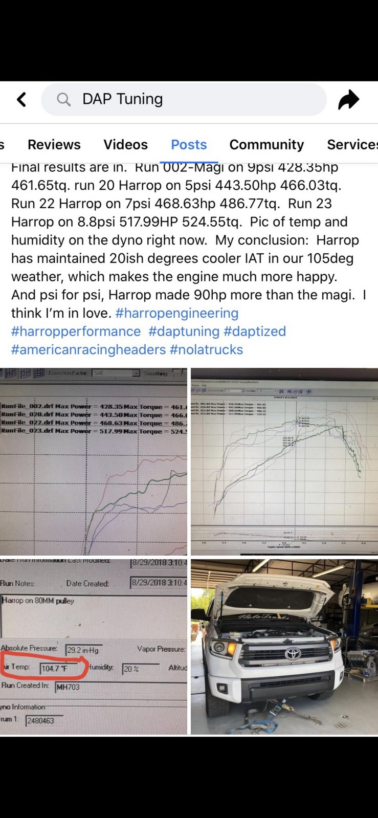

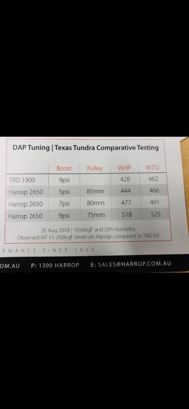

    Magnuson, Harrop and Whipple have all partnered with OEMs. Harrop has also partnered with Toyota on cars for different markets, as well as Lotus, Ford, GM and more. All that really counts from one blower to the next is the rotor pack, and as far as Magnuson and Harrop go they both share the same Eaton rotor packs. There isn’t much for moving parts to the rest of it to be afraid of. The Whipple makes boost an entirely different way, compressing the air between the rotors as opposed to the Eaton compressing it against the case. There is no denying there have been large strides especially in the Eaton TVS designs of the past to the present. These 2650s are more efficient and run cooler, while also having much larger heat exchangers to absorb and reject the heat which is a huge contributor to these engines failing with the blowers. They make more power with less heat for cooler IATs.

    do you think the new 2650 blower from magnuson puts up better numbers then this ?

    I don’t think there’s any reason to believe it would be better. They should be very comparable using the same 2650 rotor pack and both having nicely sized intercoolers.
