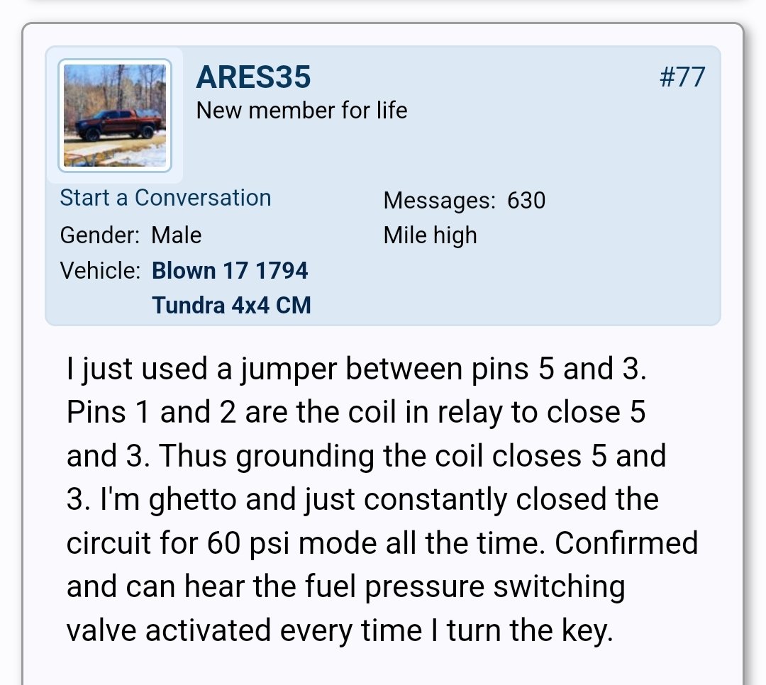

    Not sure where it says that. Just going by those that had permanent 60psi mod.
    Post a pic of what it says in Toyota manual to remove relay?
    Edit: I see the confusion from the previous post!

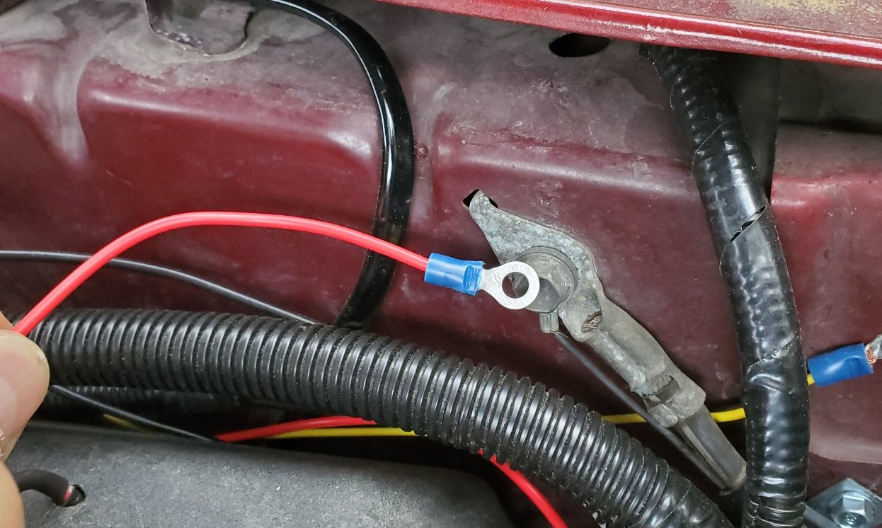

    Also going off this, the prong that needs to be grounded is facing the front of the truck right? Not towards the rear

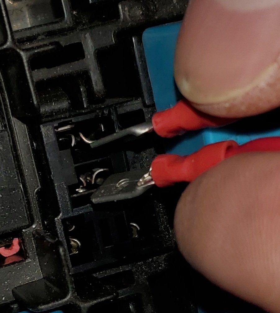

    Just to clear things up.
    If you remove the relay you will need to jumper wire pin 3 and 5.
    Or keep the relay and wrap a grounding wire on the leg shown. This will ground it out at key on. Both do the same thing. You have to attach the other end to the body so it grounds out.
    Then test to see if it stays at 60 psi and better, richer afr's at wot or shifting. Whichever gave you lean condition.

    Gonna try it. So is the grounded wire on the tab that’s facing the front of the truck or the rear? Just so I don’t mess anything up

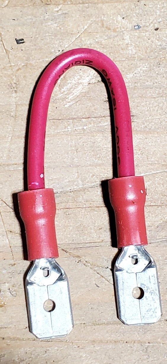

    Make a jumper wire for vsv fuel pump relay.
    Plug it in the where the 2 copper colored prongs go.
    Turn key on and you should hear your pump on. Start and verify pressure and test drive.

    And if I were to keep the relay and ground the prong, is it the prong facing towards the front of the truck?

    Yes.
    Then ground the other end to ground point.

    Last thing before suggesting a different pump would be to make the jumper wire without using relay.

    Is it technically the same as grounding the relay or does this do something else?

    It does...but removes relay so it's a direct ground. No chance of any outside interference.
