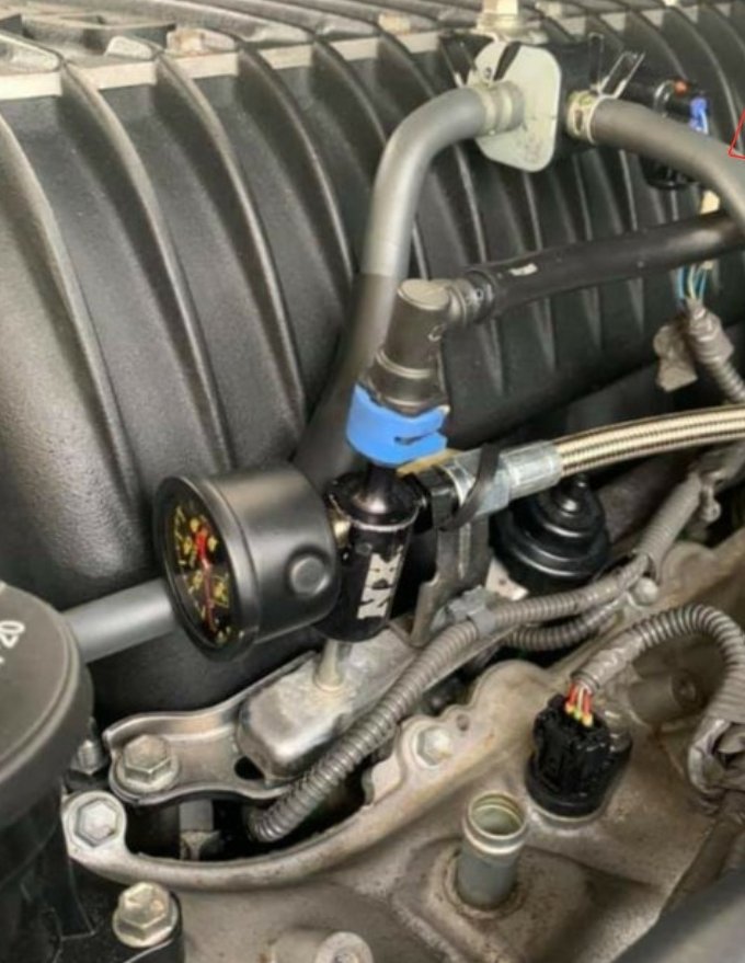

    @mralanle yes and just set them up inline drivers side.
    Like this. Disregard the extra braided fuel line.

    For test purposes you could run a fuel line with gauge to your driver side wiper. It's been done before. Using AN hose and fittings or a dedicated 1/8npt line. I run both mechanical fuel psi guage under hood and a electric digital in cab.

    What’s the extra braided fuel line for? And would you know what size fuel line to get to mount it by my windshield? I’m not that mechanically inclined so I’m trying to learn how to do it. Already lost $350 to get the truck diagnosed sadly wasn’t helpful at all

    In post #36 I put a link to a member who has a setup similar to yours to see if anything in there could help. The braided line just tee's into the other rail. Supposed to keep pressure equal between the two. It's not needed and didn't want any confusion.
    Cheapest and easiest way you can pick up some 1/8npt male female fittings, hose clamp and fuel line. I think one member even put his phone camera in there to film the psi at wot.

    Any tips/tricks or special tools needed to release the connection? I just ordered the adapter and gauge also. I imagine all that is needed for install is to disconnect the line, wrap some teflon tape on the gauge threads and reconnect the line.

    No special tools, BUT fuel line pliers make quick work of the quick connect. For the gauge I use sealant and tape, but tape alone should be good. Throw a rag over the connection prior to releasing for any splashes and it pulls right off.
    https://www.amazon.com/gp/product/B082SF6DK6?ie=UTF8
