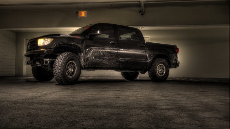

    I can't find any photos of a tundra on 39's with long travel! AND I'VE LOOKED @sdhq_offroad got any photos of a tundra running 39's or 40's?

    Holy hell man. That thing is a beast.

    We don't have any with 39's. Our shop Tundra with 37's and the Camburg LT, we cut the whole core support and moved it up 4" so that we have absolutely zero rub at full compression even at full turn lock.
    I'm foreseeing some fitment issues with 39's, but if you do it, definitely document it. We would love to see what you do.

    I've got zero rub currently on the 37's also. So far what I'm seeing to make this work is; new offset wheels. Fiberglass needs to be 1 inch wider and 2.5inches taller. And the firewall needs to be moved back. I'll document this every step of the way.

    So if you take your kit to full bump and go from full lock left to full lock right (while still full bumped), no rubbing at any point? We cleared 37's no problem with the tires pointed straight ahead, but at turn is where the rub problems were.
    What offset wheel would you be moving to?

    Correct, no rubbing at any point. Chris did a seriously great job on this kit. Why it took 4 months to make. lol
    Offset wise i'm not sure yet. I need to go pick up a roller tomorrow and mount it to one of the spare wheels to start really getting a better idea at what can and can't be done.

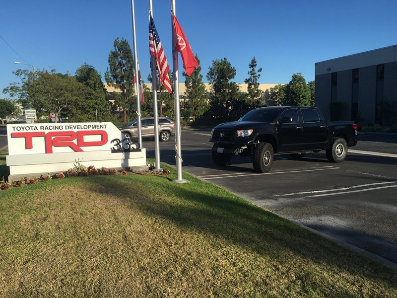

  17. Oct 6, 2016 at 5:37 AM

    mean looking :benchpress::muscleflexing:

    A little late, but it looks like they went half mast cause you took all the TRD out of your RW lol.

    I've got the TRD supercharger..... lol

    Ahhhhhhh, I've been reading a bunch of threads about the Magnesun and forgot you had the TRD. My bad.

    I have trd r/w wheels too! Lol. I think that's the only thing left on my truck with any type of branding aside from the door panel stickers.
