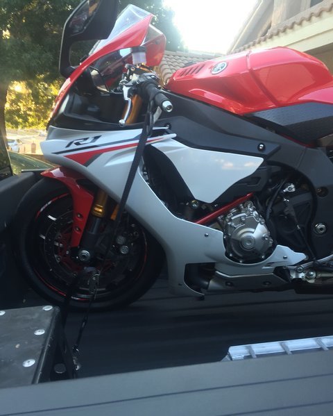

    She's inbound!!! Few more hours to go!

    2016 R1?
    New front end right?
    bandit[OP] likes this.
  27. Aug 3, 2016 at 8:25 AM
    #297
    bandit
    bandit [OP] New Member
    Mar 6, 2016
    #2855
    1,124
    2011 Supercharged Mazzulla Long Travel Rock Warrior
    Duh Tundra
    Yessir!
    2015-16 R1 are the same. The entire bike including the motor has been redesigned. And the electronics package is mind boggling.
