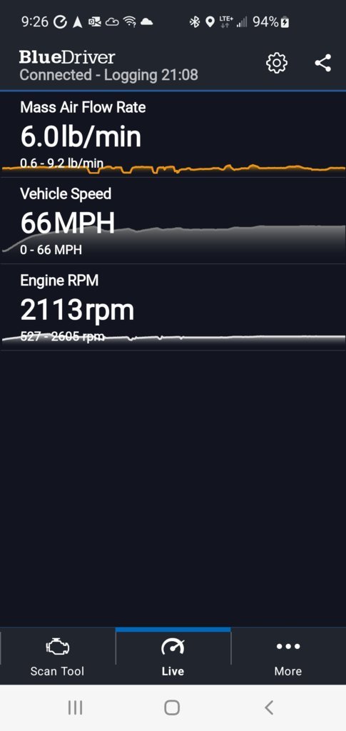

    Hey Bubba
    Thanks for the help. Cruise control is working great. I added a screen shot of live data with mass air flow rate. Just curious if this is normal. Truck runs and rides phenomenal. It was a long road and couple years in the making. Shifty and you were instrumental. I know I ask alot of questions. Thanks again. Screenshot_20250503-092645_BlueDriver.jpg

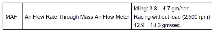

    If we are to go by the FSM, it's not within their tolerance when ENG RPM is ≈ 2K. The FSM deals in gram/sec(g/s) instead of lb/min. Your reading of 6 lb/min = 45.63 g/s (multiply lb/min value by 7.56 equals g/s).
    That does not mean your MAF has an issue, I simply don't know. I personally like to check most all my engine readings after reaching operating temp and in idle.
