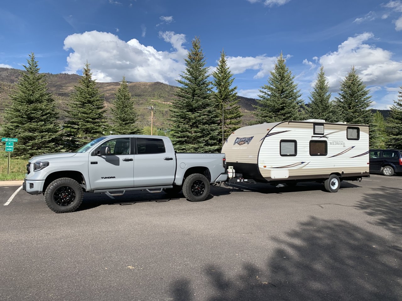

    I installed the airlift bags and the wireless one compressor helped a lot with heavy loads. Only problem the truck rode much stiffer in the rear installed the daystar cradles which helped a bunch.

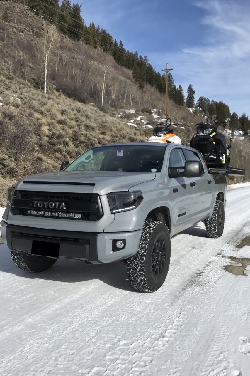

    As many other have said, get the Firestone’s over the airlift’s.
    I’ve tried both, Firestone is superior in ride quality.
    I use them religiously for both trailering and for hauling my snowmobiles. I run the airlift wireless one compressor, it’s fairly cheap and gets the job done for me.

    I love your stance. What tire size are you running? Obviously spacers, what size? And what additional lift?

    Thanks man. Running 285/75/18 Duratracs with 2" spacers. Lift wise just running two CB shims on either side up front, and CB +2" shackles in the rear.
