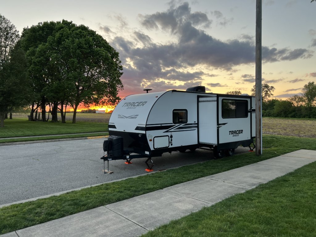

    Best of luck on repairs OP, my last one earlier this year got totaled out from some tree damage.
    Picked this up last weekend, 2019 superb shape. Discovered after I got it home the rear axle is bent flat (no curve as designed) and the tires are canted inward. Noticed the interior tires were fairly worn compared to the front set, initially thought the bearings needed adjusted as they were loose but the problem was bigger than that. Got a new axle on order and need to replace asap and set of 4 new tires. Looks to be an easy swap so I'll do it myself, shops are busy and crazy expensive. Right now I'm getting 8ply trailer tires, would like to get 10ply though for the added stability. Thought I'd share, check axles when looking at trailers/campers!

    Also the last owner did not have the WDH setup right, riding too high in the front. He had a Tundra DC too, ironically. But when I hooked it up to my truck and it was riding heavy on the rear axle. Has two 3500 axles, but one set was taking majority of the weight. That and if they overloaded the trailer probably factors as well for the rear axle bending.

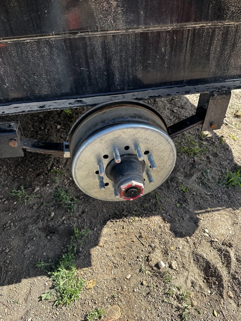

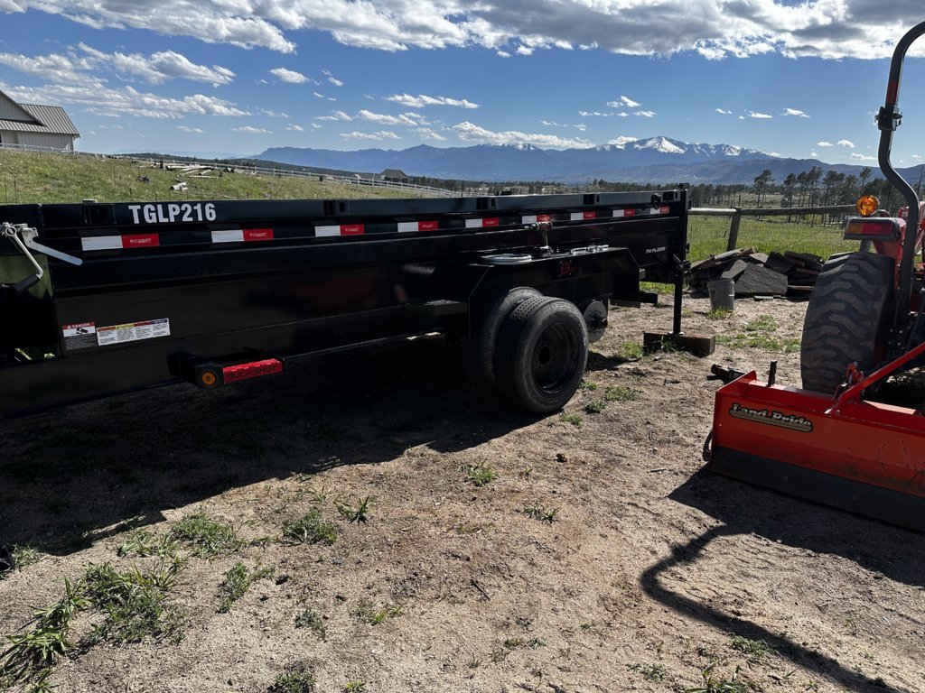

    Installed Centramatics on my newest trailer yesterday.

    250.00 dollars to never balance again? sold.
    Getting those 17.5 wheels off the studs yesterday was something else. You probably heard me cussing from your house.

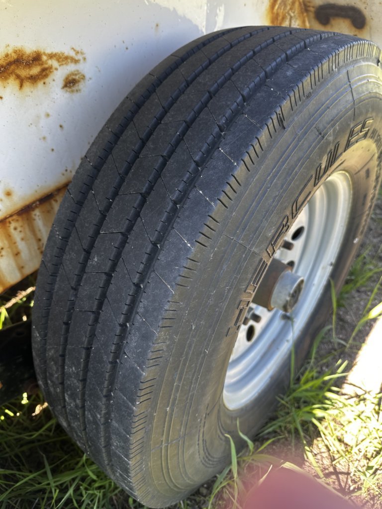

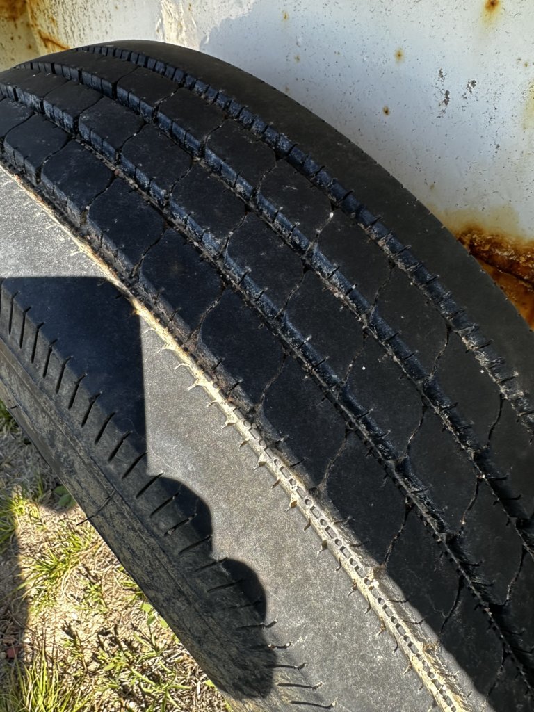

    I pulled these tires off my old 20' buggy hauler and installed them on this trailer. These have over 30k miles on them.
    You all see the weight I have in these trailers. If I have a vehicle/trailer that can run these balancers...done.

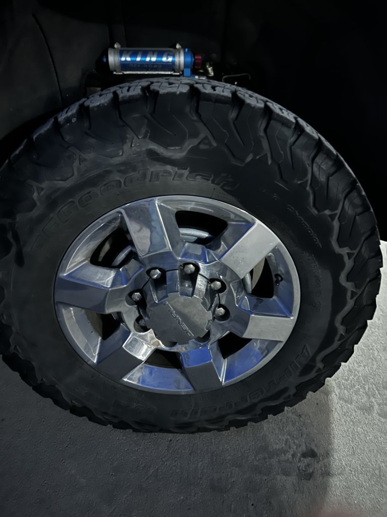

    Set. Some are just over 200.00 for a set.
    I have them in my truck too.
    Just checked. Fronts (newest set) have 30k miles at 10/32nds.
    Rears have 40k and 7/32nds.
