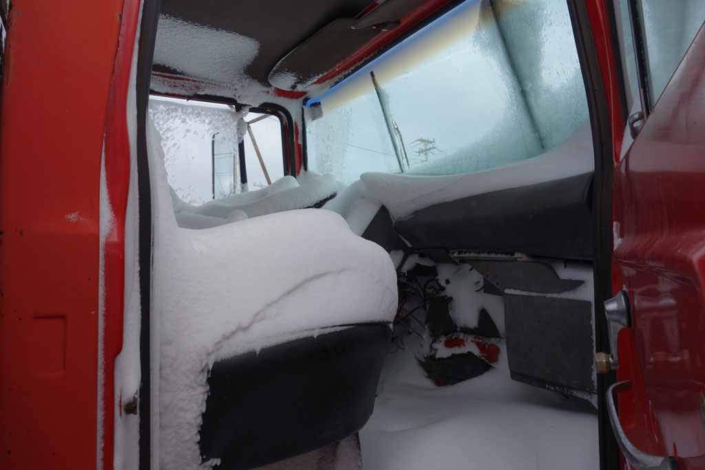

  15. Feb 12, 2017 at 9:57 AM
    42,945
    Was it this bad????[​IMG]
