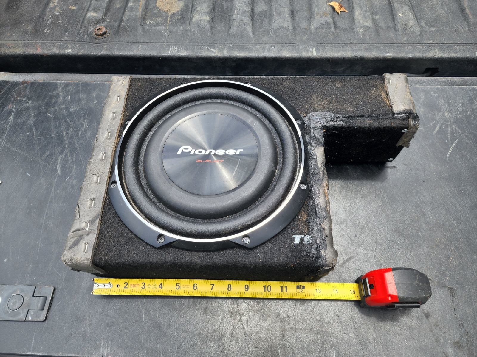

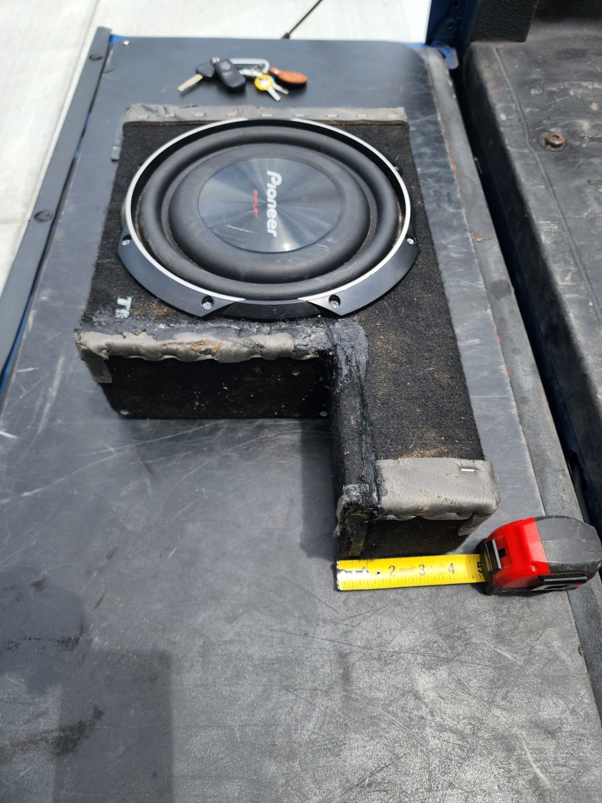

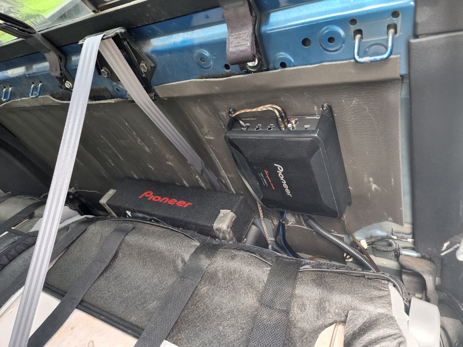

    I fit this behind the seats of my '07 DC. It took some trimming of the subwoofer box. It's not pretty, but it worked. I added polyfill to help make up for loss of airspace volume.
