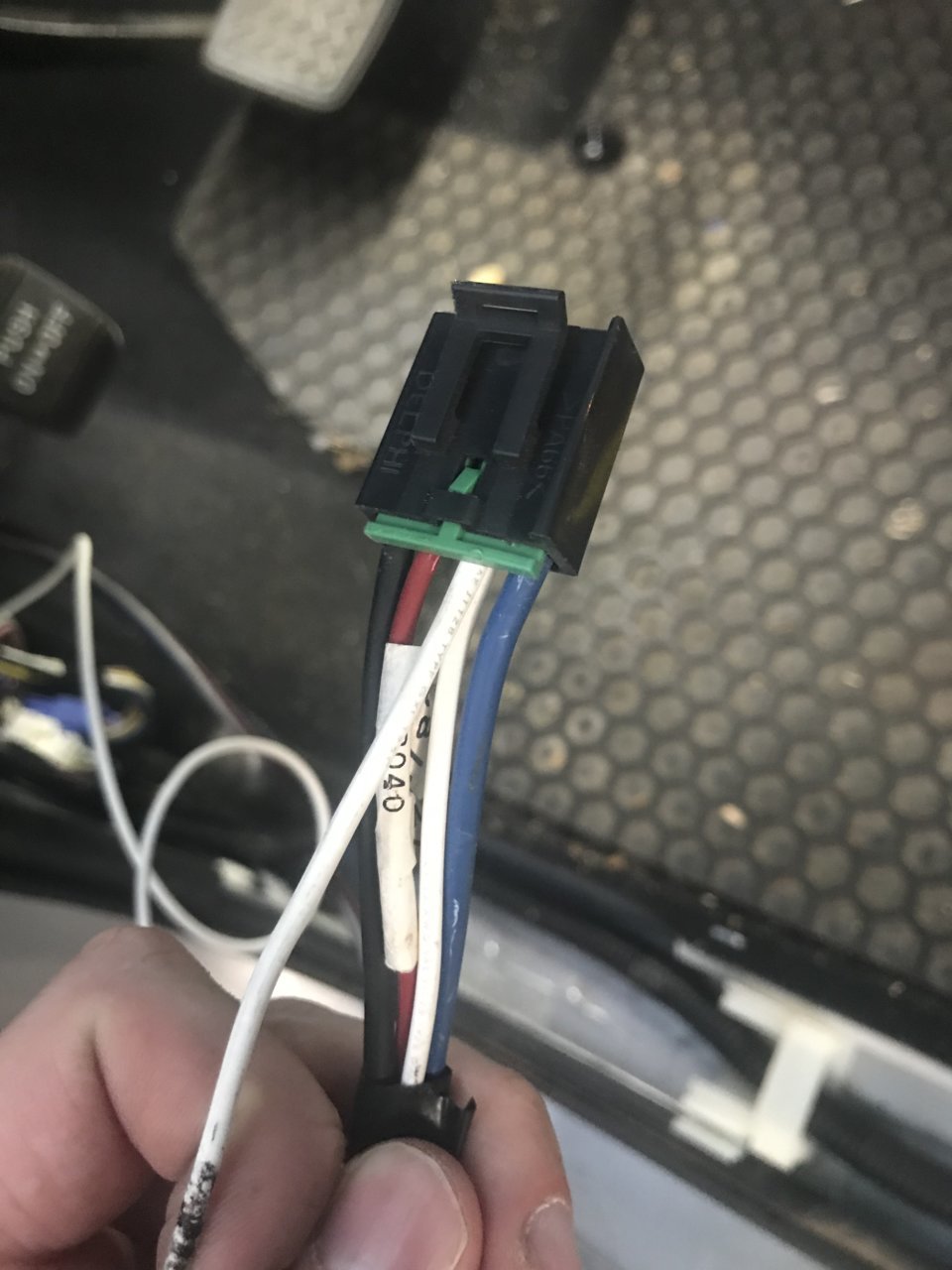

    Had the trim panel out and this was flapping around. What does it go to?
  2. Sep 27, 2018 at 8:18 PM
    35,279
    Looks aftermarket, bought your truck new or used?

    Isnt it the harness for trailer brake controller

    Trailer brake harness?

    Doesnt look OEM. what's the warning sticker on it say?

    Looks aftermarket to me also

    Trailer brake was my guess too.

    I’ll pull it back apart tomorrow and check labels and see where it goes.

    Do u currently have a trailer brake controller?
    If not. Its probably the harness. U just need to buy the unit.

    Nope, don’t have one. Don’t foresee needing one, but that’s good to know it’s in there if I ever did.

    That’s the trailer brake harness for a tekonsha brand trailer brake. In the 2014’s they connect in the drivers side kick panel.
