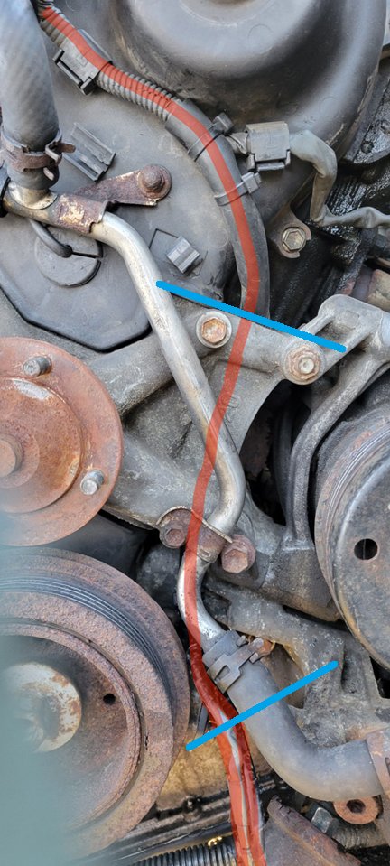

    Did you check all your fuses, including the EFI1/EFI2 fuses under the hood?
    Did you check for power at the Fuel Pump Relay socket?
    Have you tried spraying starting fluid into the intake manifold to see if it turns over, so you know if it's a fuel delivery problem or not?
    Did you try slapping the gas tank a few times to see if it'll catch and turn over? (percussion on the gas tank will often jolt a failing fuel pump to work another time, similar to tappign a starter solenoid)
    Did you look for rodents nesting on top of the tank, potentially chewing wires up?
    Timing belt must be changed every 100k miles or 10yr, whichever comes first, did you verify it's still intact and your engine isn't fucked?
    Either way ... startup problems is kinda covered in the hey, you should read this first megathread. Specifically these two points:
    • Starting problems: If your truck won't start, or stutters, it's VIRTUALLY NEVER the fuel filter, as mentioned above. It's also typically NOT the starter, and also typically NOT the fuel pump. There's a wild array of other potential causes. If you recently had the timing belt done, check your crankshaft position sensor wiring harness - it's common for the loom to be reinstalled wrong, so it flops out and gets cut by the serpentine belt. Don't use aftermarket or "universal" relays. Make a new thread, honestly. We see 'no start' issues often. If the truck won't turn over, start by checking your cables for tightness and corrosion, check the starter relay (jumper power to the starter at the socket!), look for an aftermarket alarm, and if you have a double cab or sequoia, make sure there are no immobilizer codes. If the truck does turn over, best next-step is to figure out if it's an ignition/spark problem or a fuel delivery/electrical problem. You can do that by getting a can of starter fluid ("ether") from the parts store and shooting it into the throttle body. If the truck starts, you have either an electrical problem or a fuel delivery problem - and it's important to say: It's rarely the fuel pump!! (unless you previously installed a store brand pump) Instead, it's more likely an issue with the crank position sensor, fuel resistor, ECU, or similar. Start a new thread on the 1st gen forum and someone will try to help you narrow it down.
    • These trucks usually don't have a ton of other electrical issues. Hidden corrosion inside the battery/alt cables happens. Sometimes, a couple thousand miles after timing belt changes, people will have startup issues because the crank position sensor wasn't properly tucked away and gets rubbed by a belt (pic), correct routing info here. There's also a similar problem with camshaft position sensor under the cam cover, where the belt will rub through (pics). There's the rodent issues mentioned earlier. Occasionally, water leaks can send water down into the ECM behind the glovebox (pics), or into the fusebox inside the cab/dash (pics & pics & pics, it happens a LOT). Many drain/vampire issues trace back to aftermarket add-ons whether the owner knows they exist or not - alarms as mentioned earlier, brake controllers, poorly installed trailer receptacles, those are some big ones.
    Pay special attention to that "CRANK POSITION SENSOR ROUTING" in the 2nd bullet point.
    If the timing belt has been changed recently, you need to verify that. The ECU shuts down the fuel pump if the crank position sensor isn't sending feedback. If the engine isn't running, for safety's sake, you don't want the fuel pump to continue dumping fuel.

    I would try starting fluid to see if it'll fire without gas.
    And you are 100% sure you routed the crank position sensor wire correctly when you did the timing belt? Specifically, the span between the blue lines here is critical it be mounted behind the A/C and fan pulley brackets, else it'll get clipped by those pulleys and *poof* no more gas delivery.
