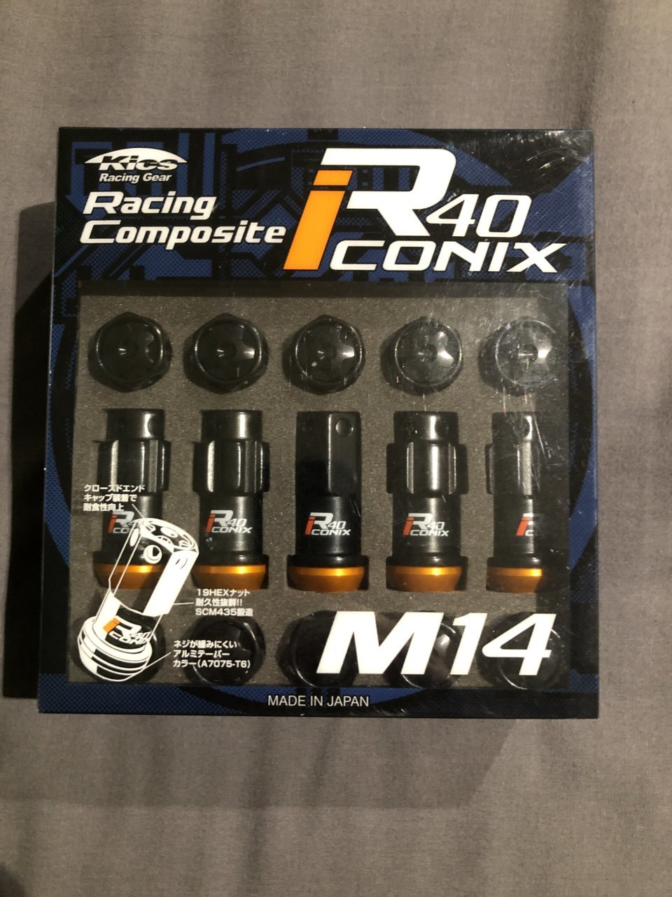

    Iconix come in M14?
  4. Oct 24, 2020 at 9:46 PM
    #34

    Sure do. I bought them when I bought my gram lights wheels. Wanted to keep them from getting all messed up from the lug nuts. Now that I’m getting those studs I can finally use these guys. 1B00BB59-4DF7-4926-BD99-95B8BA24C08E.jpg

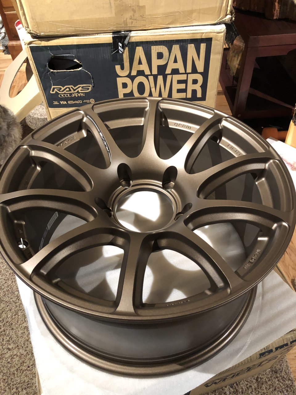

    Pictures don’t do them justice, but they make them for our trucks. 57 trans x is what they are called. Come in 18x9 with either 0 or +25 offset. Also come in black or bronze. Weigh about 23 lbs. this is what they look like on my truck. 90A07C7E-BE3F-48F8-B131-C6815CE2D871.jpgCDA45425-5E72-4906-901D-20C09B94FACE.jpg35FDF21F-EF79-4433-80B1-760D6A85DE66.jpg

    I considered getting Rays, but my wheels end up haggard from off-roading. I would feel so bad wrecking nice wheels.

    So far they only got some pinstripes from wheeling. I don’t drive fast when Offroad especially when driving over rocky terrain. Once they get damaged enough I’m going to get them powder coated in hyper blue which I think will be awesome. Unfortunately yellow stuff brake pads keep my wheels mostly black. I got them for their strength, weight and looks. Since I’m on 37s the extra 10lbs made a difference compared to my method grids that were 33lbs.

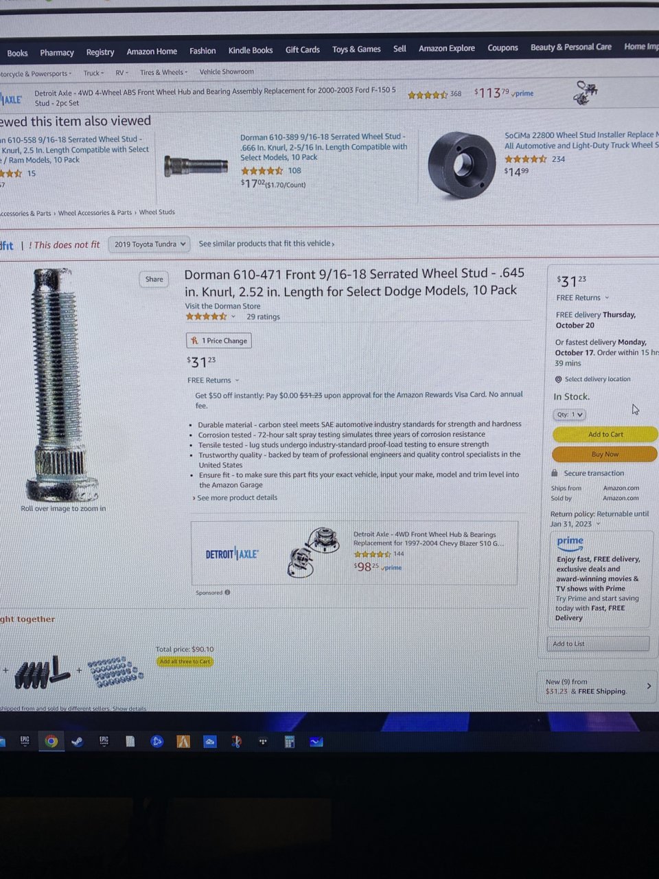

    I looked up the part number clicked on the link from Amazon and Walmart it’s saying it don’t fit tundra.. also shows that part number is for a dodge? Ignore it? If you say those worked I’d believe you more.

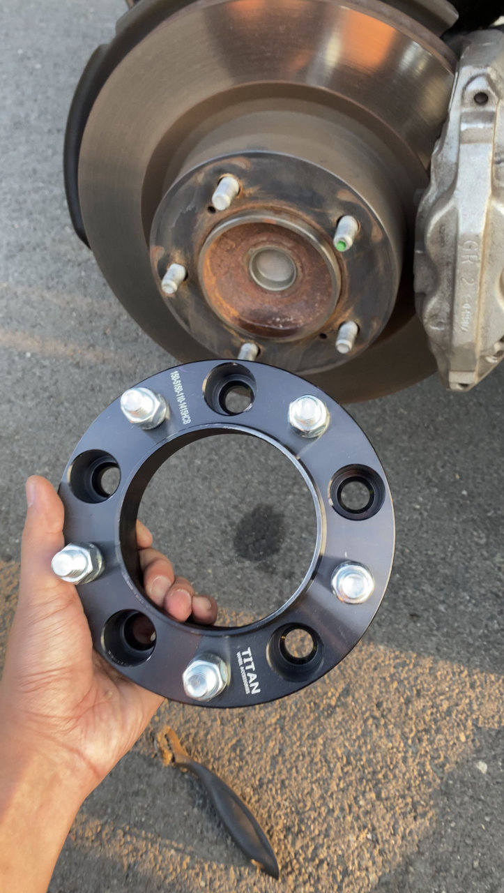

    Ran into the same problem. Attempted to install 1.5 spacer . And the nuts to secure the spacer only go half way into the oem studs. They look shorter than ones on my Camry.

    I've used Dorman 610-471 wheel studs for a few years now without issue. Just make sure service techs understand the studs are different up front if you ever take it in.

    Whatever you do... do not over torque them. Just watch the backside as you are seating them. Once the underside of the head contacts the hub it's good to go. Tightening it further than that you'll risk snapping them - while you are driving. I made that mistake.

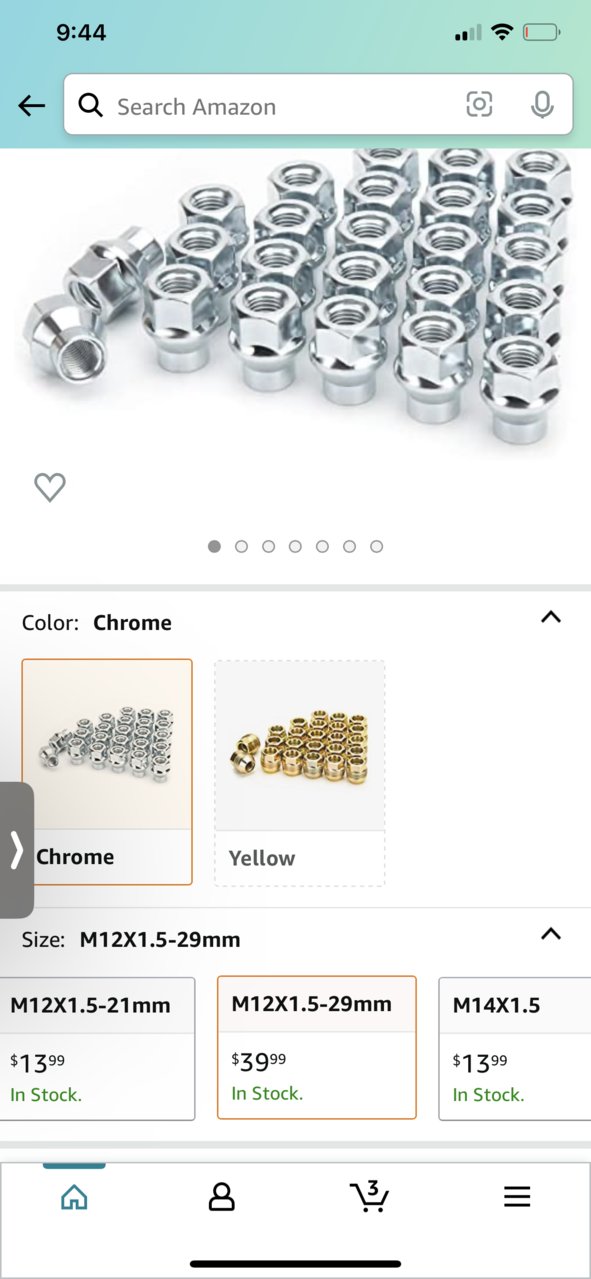

    Got the extended wheel studs in the mail yesterday. Curious to know will extended nuts for the spacers do just fine on the stock wheel studs since it’s 8mm thread longer here’s what I’m looking at. Standard nuts for spacers is 21mm long as you see in the other options, the extended ones 29mm. Assuming the extended studs are the best if had to choose one but I’m trying to do the bare minimum not having to replace the studs. I know having both is the best and safest but would like to hear some opinions.
