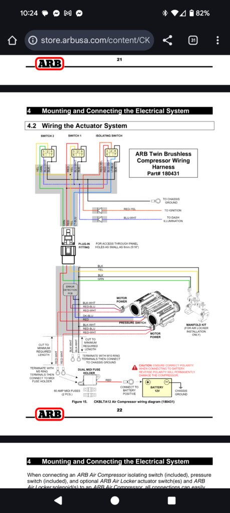

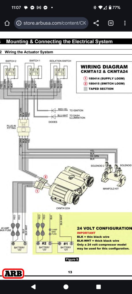

    Here is a screenshot of the wire diagram.

    Is it the red/yellow? I hate wiring...

    I think the red/yellow is for ignition power when using their provided switch. I think you can bypass the entire harness and switch and run to a spod/switch pro style controller with just a signal wire. Looking at it now I think it's the lt blue wire.

    That's the old style twin and old harness. But looking at the old wire diagram and new diagram the Gen 1 harness goes from purple to red and then ties into the isolator switch at terminal 3 and the Gen two stays red and all the way to terminal 3. I think the red wire is what I need.

    Red is the main trigger for the pressure switch, which if it is under the maximum pressure will power dark blue and turn on the compressor, but, I have no idea what light blue is contributing to the detection pcb. Can you put a multimeter on the main isolation switch and figure out which other pin on the switch has continuity with the light blue wire pin 7? Is it a ground? A power? A switched power? That is the only gap for me right now.
