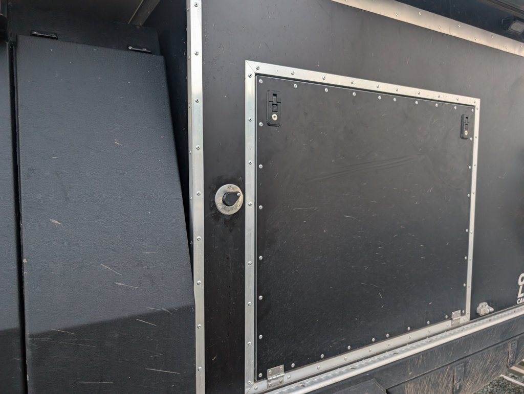

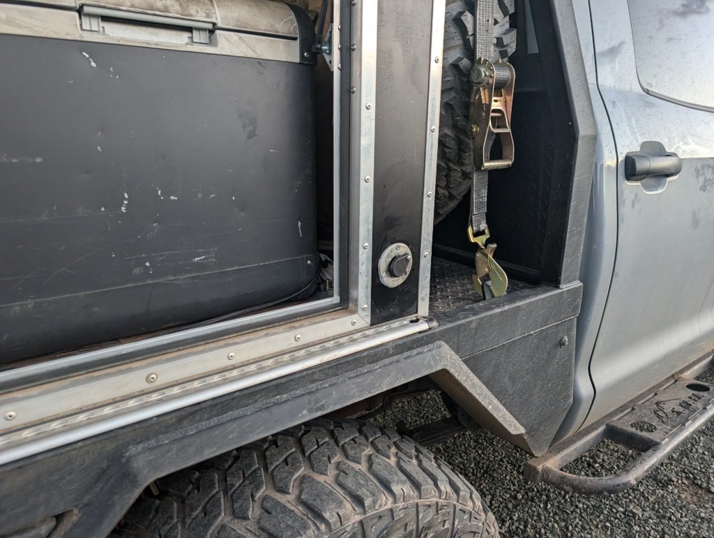

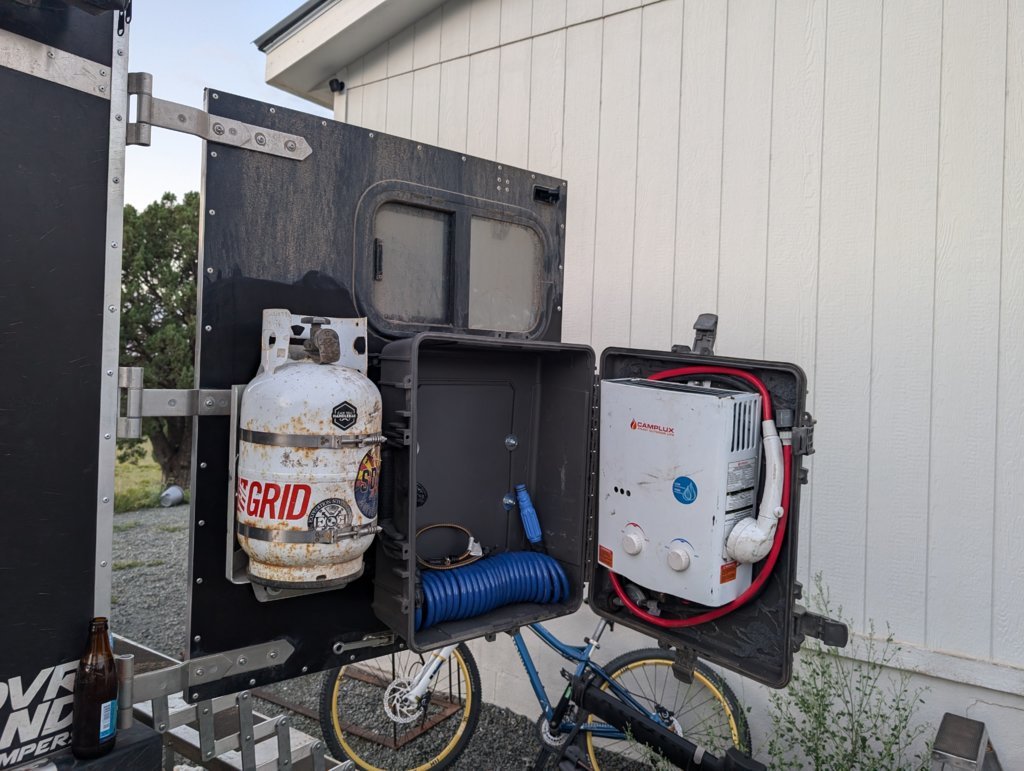

    We got some more stuff done to the truck this last week. We got the aquor water quick connects installed and got the shower box and both propane tanks mounted up.
    PXL_20240830_012754754.jpg PXL_20240830_013047914.jpg PXL_20240830_013058551.jpg PXL_20240830_013134892.jpg
    Then we made it out Friday and Saturday night to camp.
    Next up on the list is the propex heater. I'll hopefully have some time this week to get it installed.

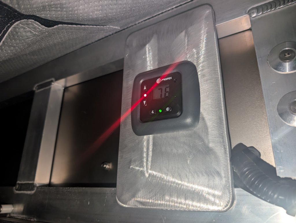

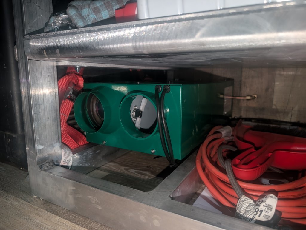

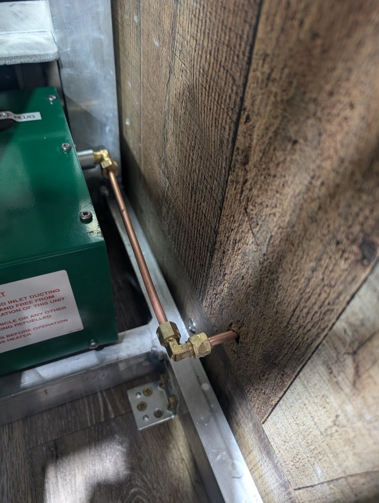

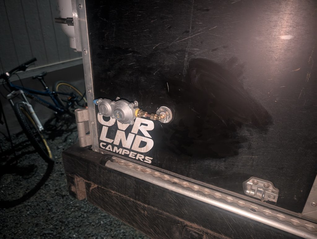

    I've had a couple afternoons to work on the propex heater setup finally. My wife is worried the kids are going to freeze to death in our 50* low nights :rofl: but it needed to get done sooner than later because we have some cold nights on the way. I ended up changing everything about my plans once I started laying everything out. I ended up building a shelf at the passenger rear for the heater and some other storage. The regulator is hard mounted to the outside of the camper and the intake and exhaust run out through the floor of the camper. All the internal gas line is hard copper and I have a rubber "whip" hose with quick disconnects for the external stuff.
    PXL_20240912_021709987.jpg PXL_20240912_021656457.jpg PXL_20240911_172410151.jpg PXL_20240912_021327023.jpg PXL_20240912_022016363.jpg

    Have you used that kind of heater before? I ened up doing the diesel heater route to prevent moisture buildup

    I had a diesel heater in the past and it worked well, but I hated having to carry diesel and we had ours mounted in our old build out so we always had a hint of diesel smell if it spilled getting to camp.
    I've heard these are a dry heat because the combustion process is external and exhausted out. We'll usually run the fan anyways to keep air moving because we oversized the heater. Hopefully we stay dry and warm.

    Oh awesome, so it probably has a legitimate heat exchanger instead of just an open flame providing the heat.

    Correct, it's a heat exchanger vs. the traditional Mr buddy style heater. Should be plenty dry with the fan pulling air out as well, we will see though.

    Propex is the manufacturer? I’ll have to look one up

    Yes sir. This one is the propex hs2800.

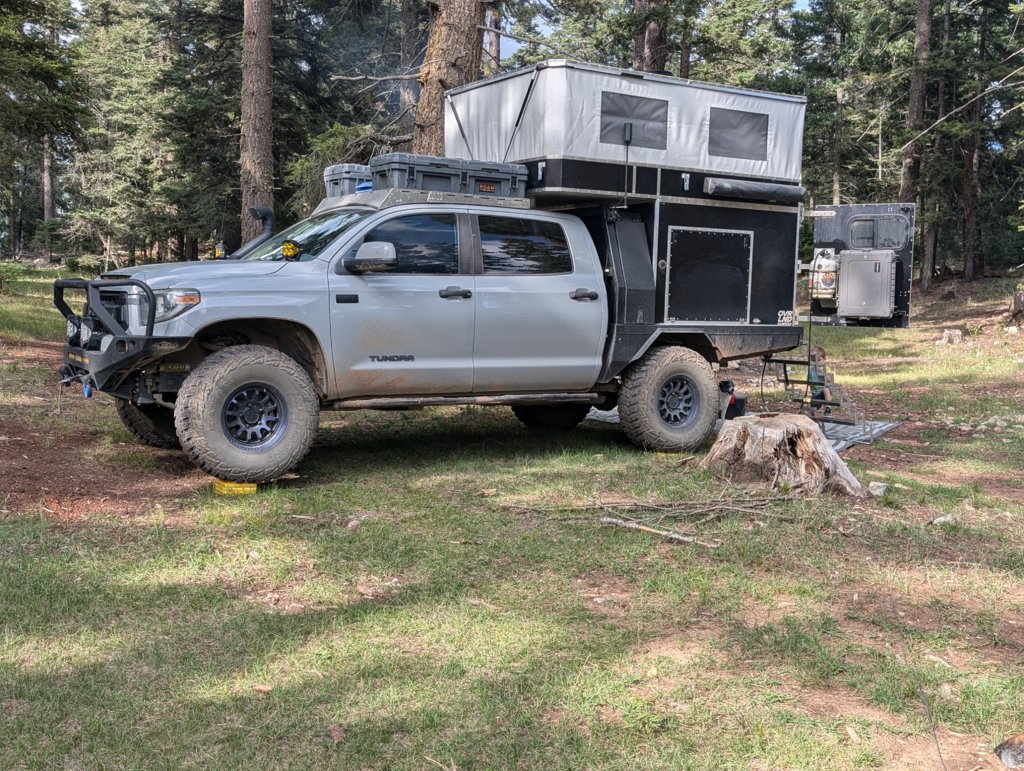

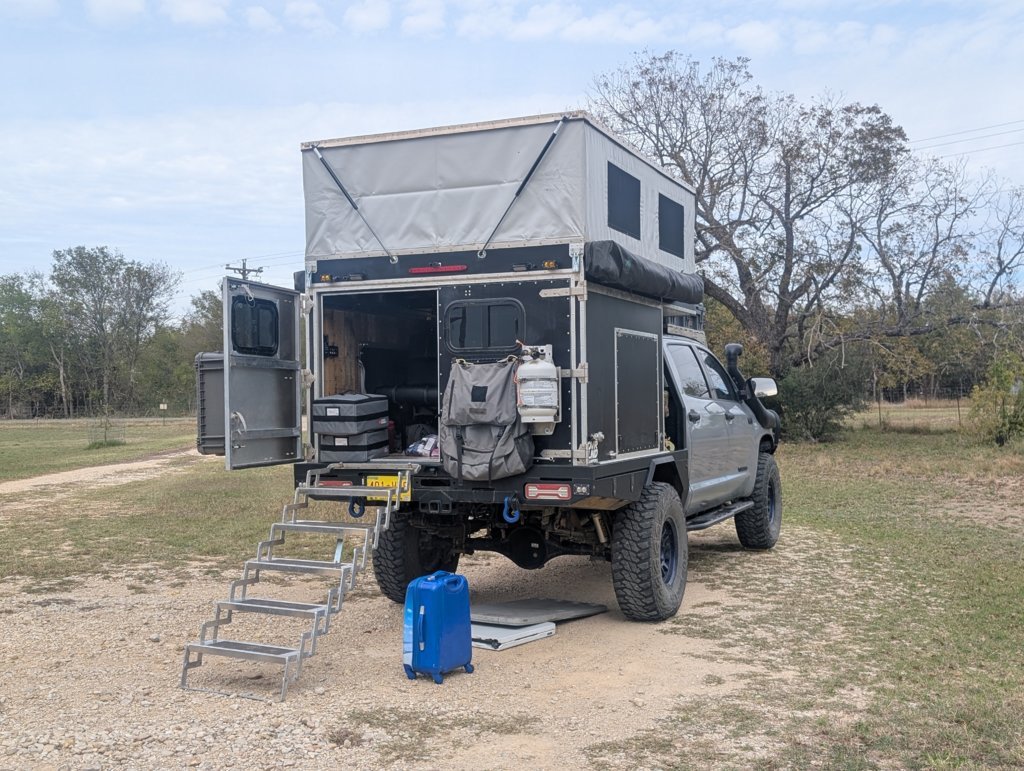

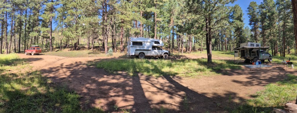

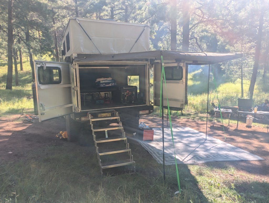

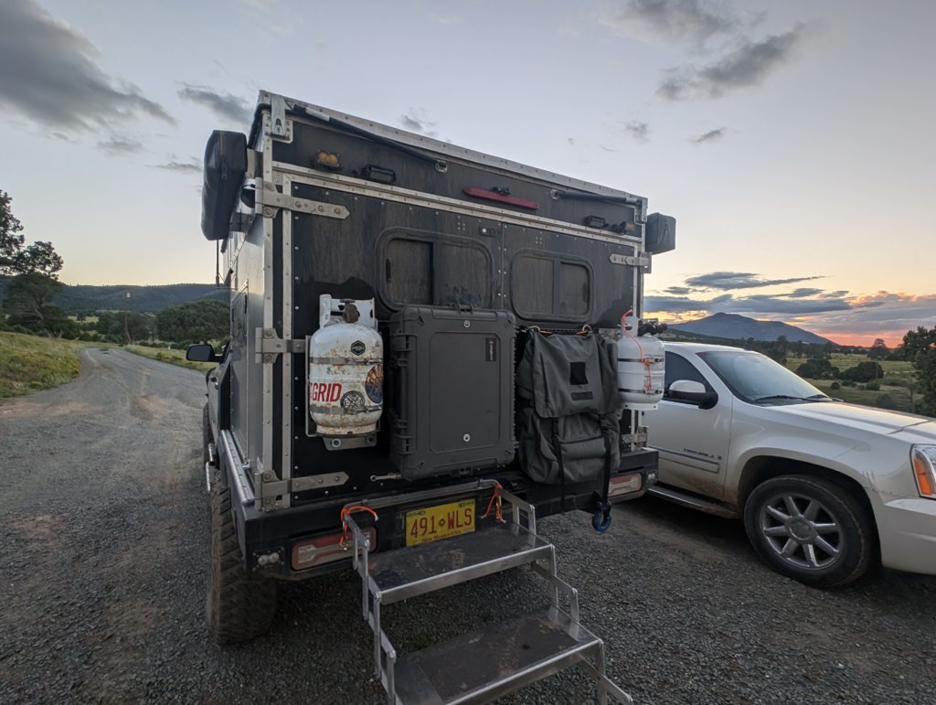

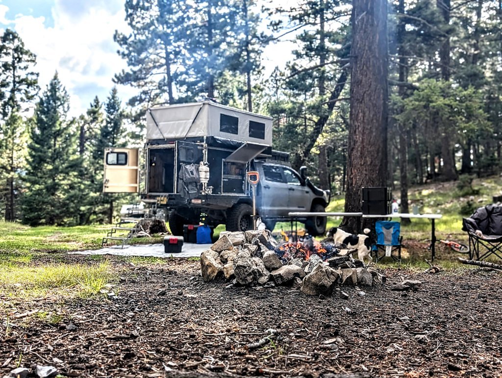

    We got out and camped again last weekend. The camper is pretty dialed in how we have it set up now. We added some frontrunner flat packs for our personal storage stuff and they fit perfectly behind the couch back.
    Also, the propex is awesome. The thermostat keeps the temperature pretty even all night and the heater runs pretty quietly, especially compared to the diesel heater.

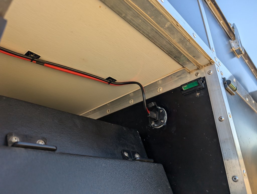

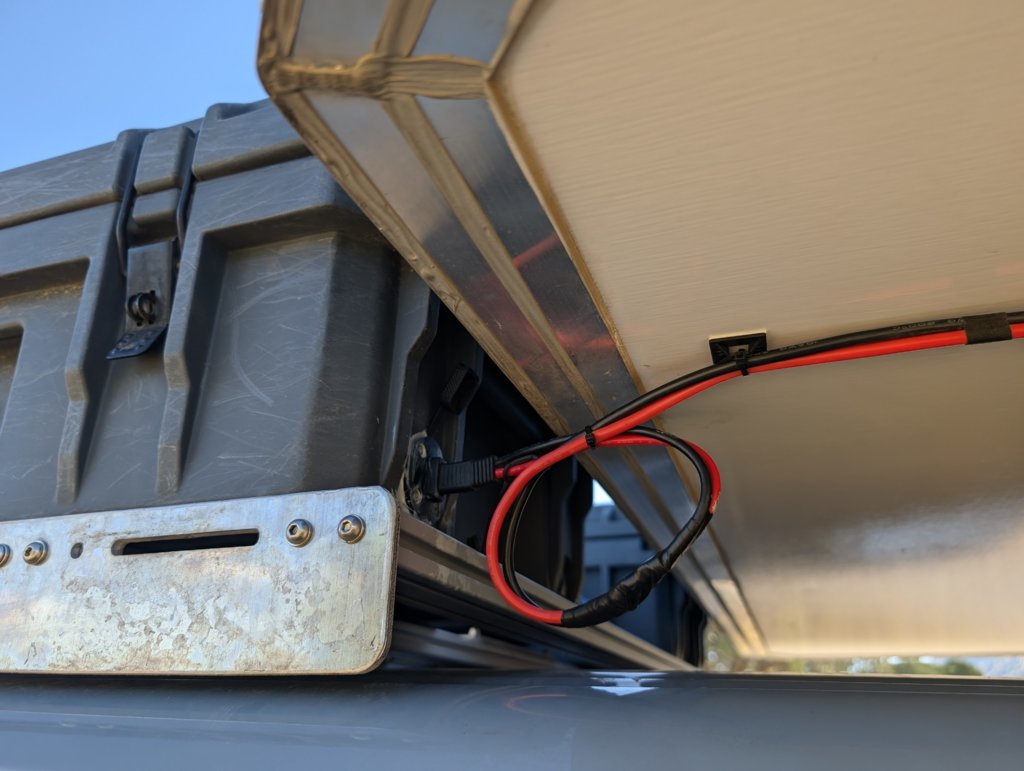

    I knocked out a little project this afternoon. I wired up a plug on the camper and on my roof box to power our starlink mini. This will be nice because everything just unplugs if I need to remove any component of it.
    I need to get some more of the KC wire hider stuff to run the wires through but it works for now. The starlink works through the roam case in motion so it will live in there unless I need to aim it at camp.

    Am I reading this right? So if I get a star link and throw it in my roam case, I’d never have to open the case to give it a clear view of the sky?

    Correct, the gen 3 and mini dish have been approved in motion, and mine works through my roam case. I'm sure that it is not as fast as if it was oriented correctly but it worked well today on a trip to town. I carried a phone call and streamed a football game in an area that never has service to test it out and it worked.

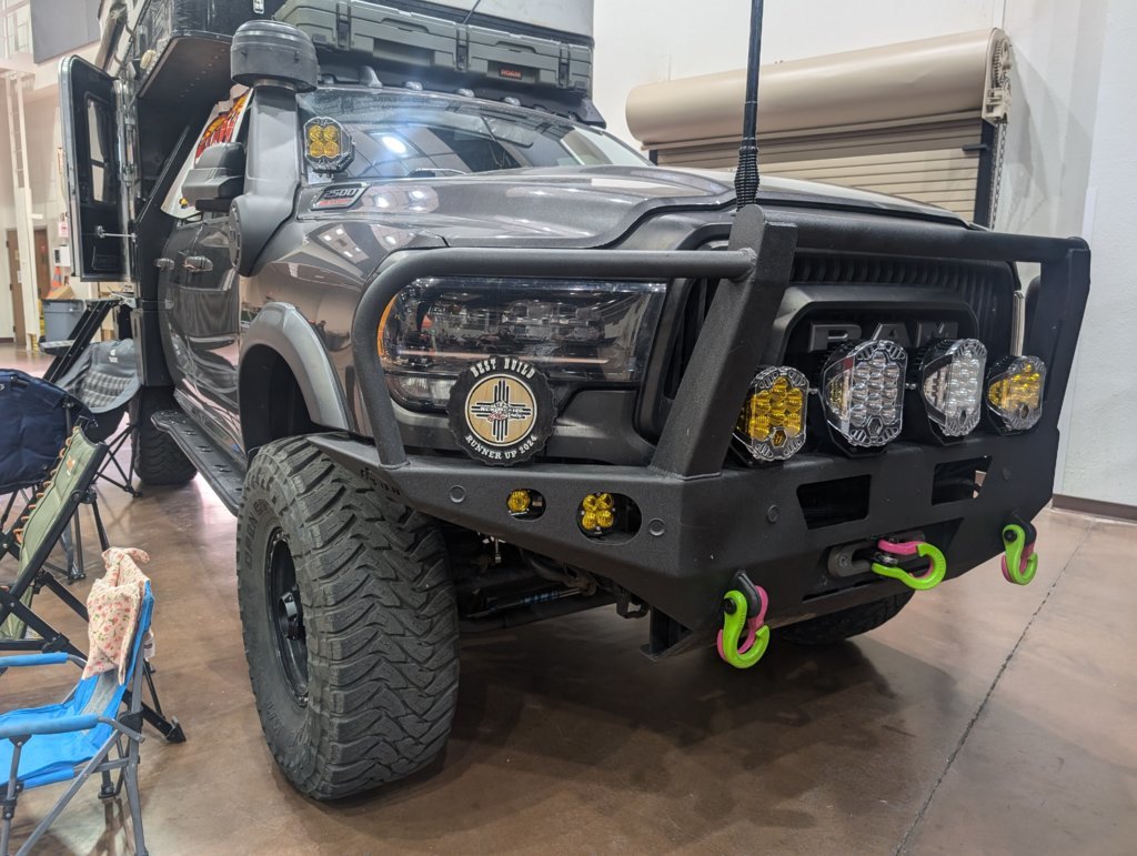

    We had a little local 4x4 expo here this last weekend and we had my truck and one of our customers power wagons in our booth for the shop. The power wagon got runner up for best build and the tundra took best 4x4 build.
