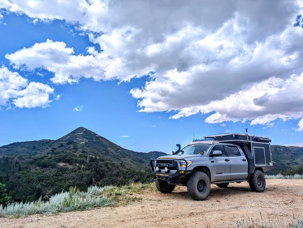

    Our plasma table at the shop went down so while we were waiting on parts I made some progress on the camper build out. Plywood with vinyl floors and then insulated and used a MDF wood panel for the walls. I also got my water tank, fridge, rollover couch and power management stuff in. I still need to get the propex mounted and do a little more organization for the wiring but it turned out good. There is still a million things I need to get done to the camper but it's useable now.

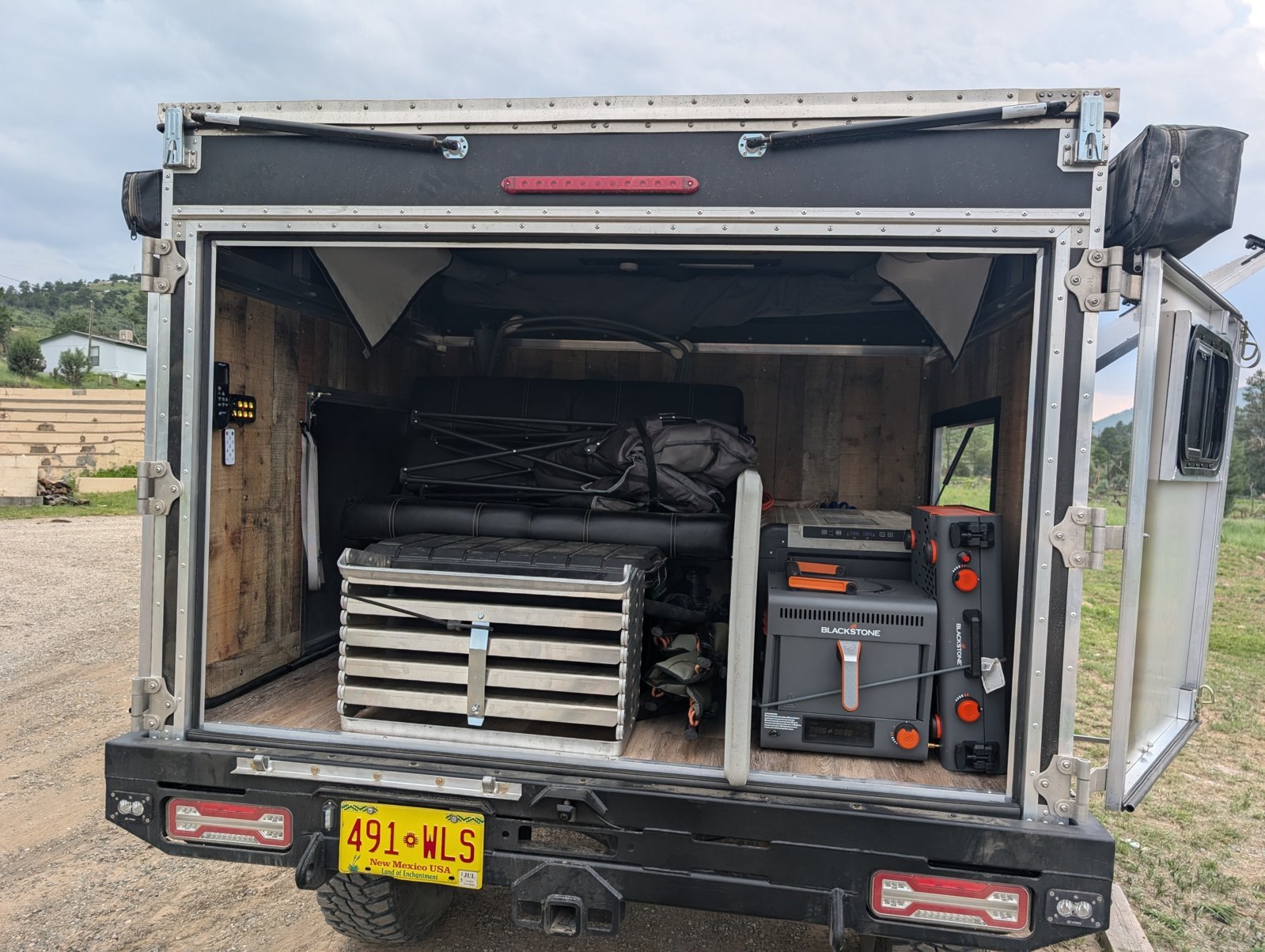

    We crammed all of that build into a few days so we could hit a trip with a group of friends to a lake in northern NM for a couple nights and then bounce up to Pagosa Springs CO with my parents for a few nights. It was our first trip with the new baby and she absolutely crushed it. The new camper and sleeping arrangements worked out great for us and both kids so I'm pretty stoked about that. We also learned a lot about how we want to pack everything and finish the build after 6 nights in it.

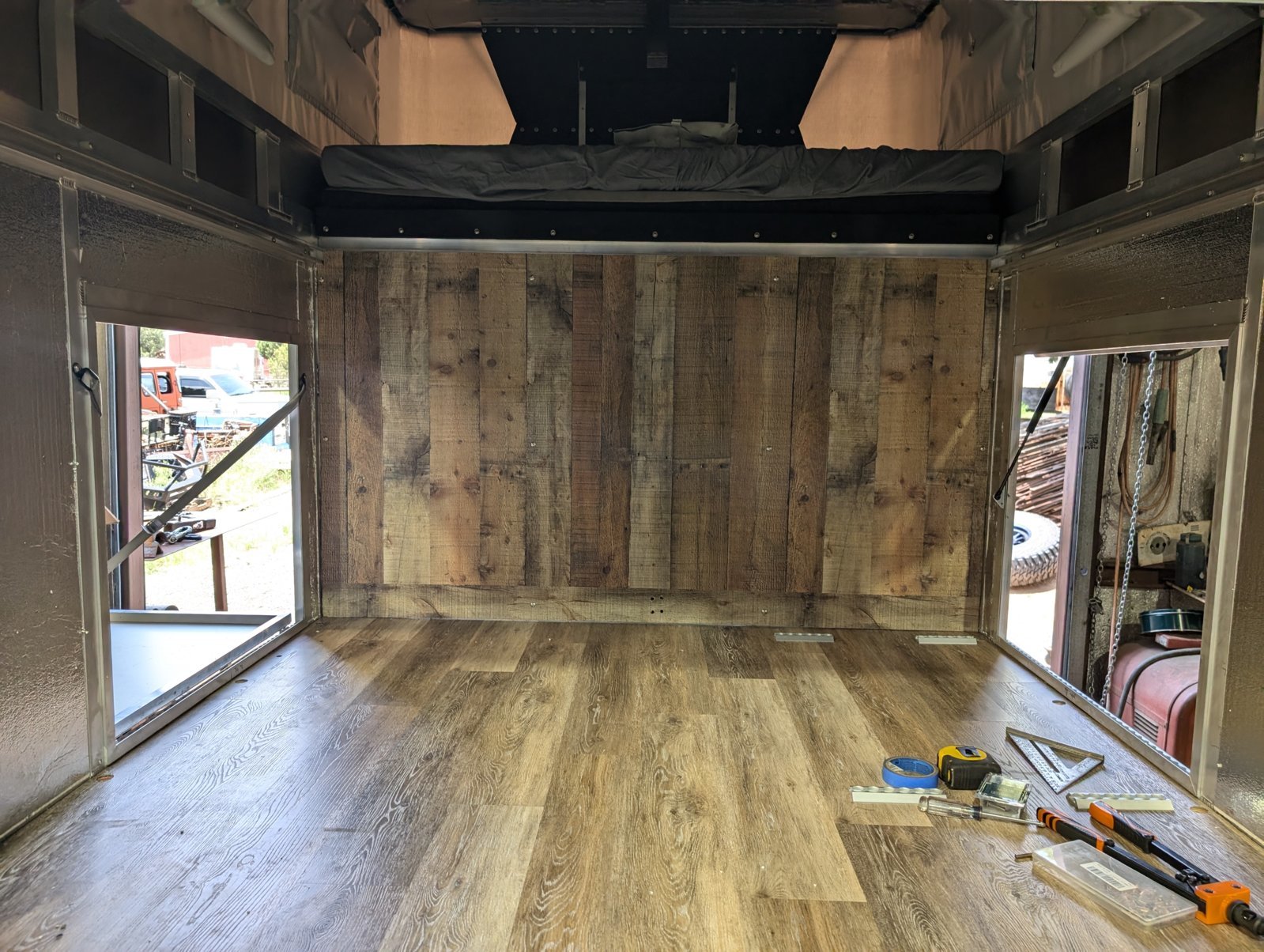

    Interior came out awesome! Can't wait to see more of it!

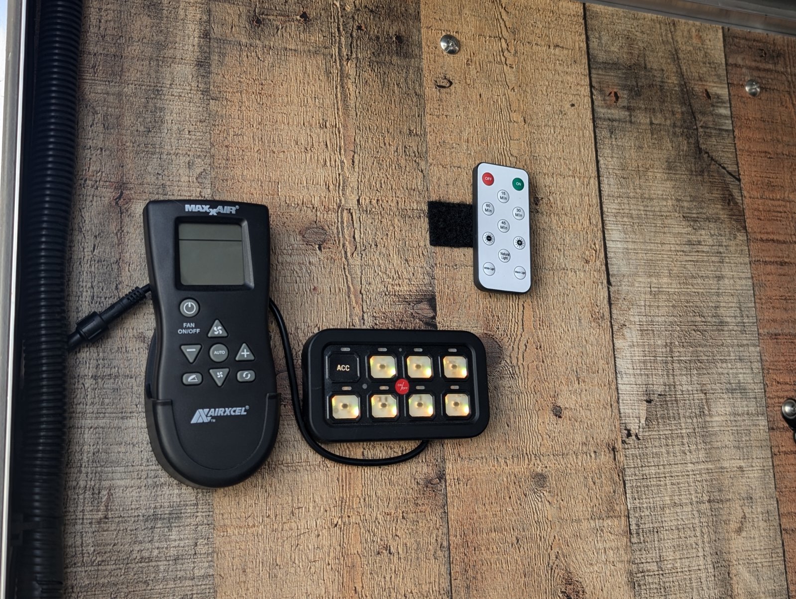

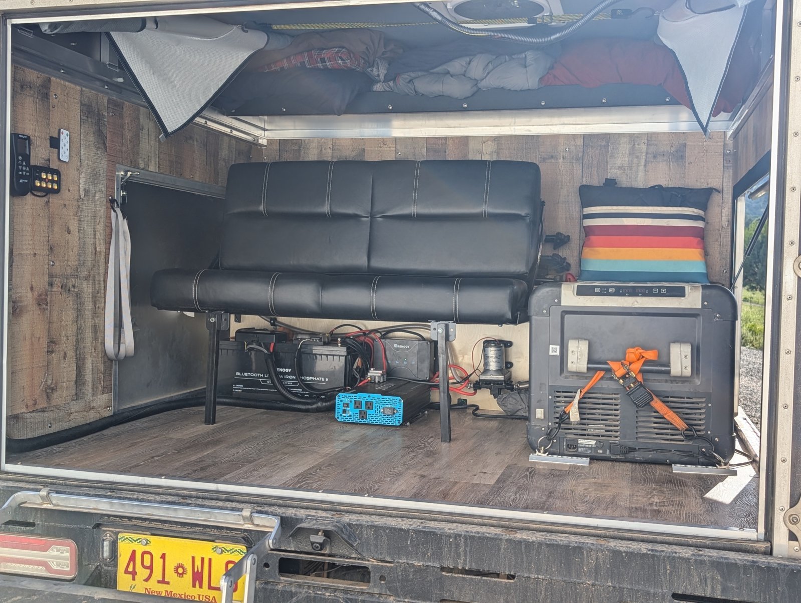

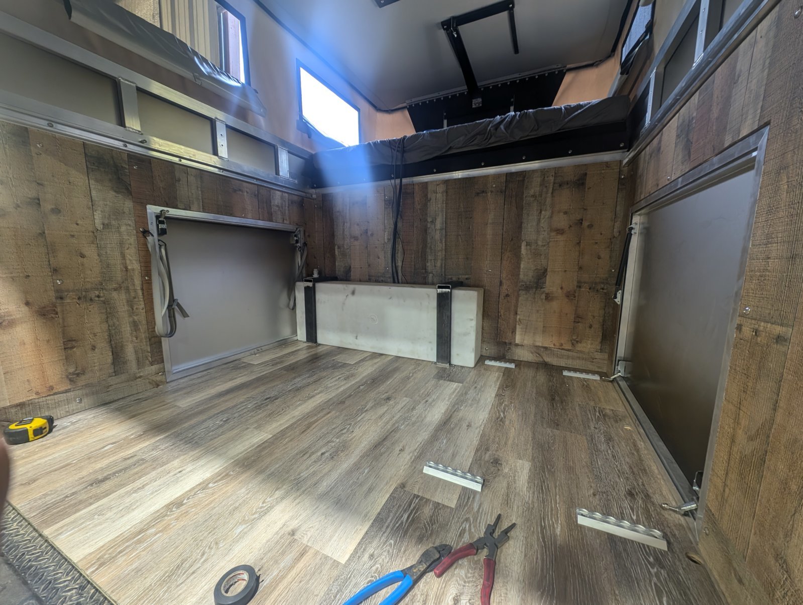

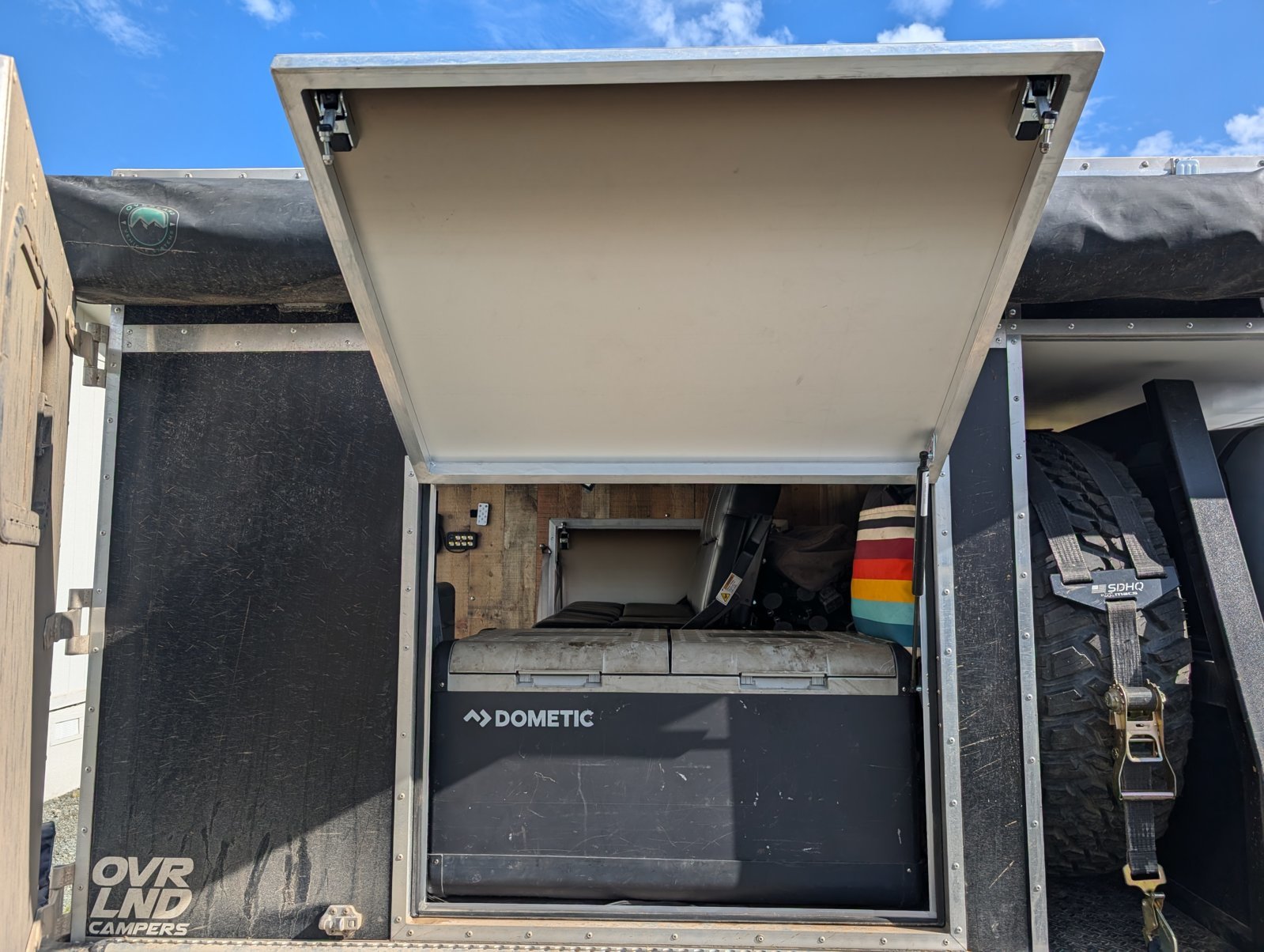

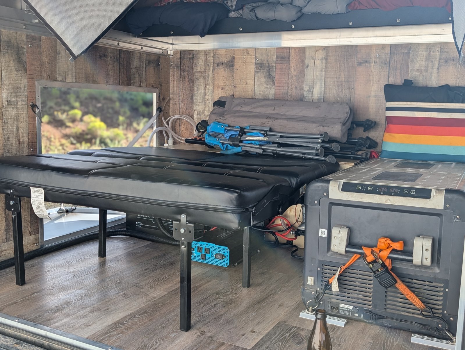

    The interior build on our flatbed camper is pretty close to done. I still need to build a shelf for cooking appliances and storage but it's totally functional now. We had OVRLND put floor "joists" in and we completely enclosed the camper. We used 1/2" birch plywood covered with vinyl for the floor. Then we insulated the walls and covered it with a wood look MDF panel. The front left has a ~25 gallon water tank with a 12v pump. I still need to put in a couple quick connects for the water through the walls of the camper, but I'm not sure which ones I'll use for that yet. We have 400 watts of solar on the roof running through a renogy 50a dc-dc/mppt controller into a 200ah renogy lithium battery. We have easy fridge access from outside via the flip up hatch and it is still easily accessible from inside. Bags and chairs can be stored behind the back of the couch. The couch rolls over into a bed for our 3 year old. I'm going to add some molle panels to the outside of the rear doors for propane storage and a box for our water heater.

    I absolutely love the rollover couch!

    Thanks man! I'm pretty happy with how it all turned out.

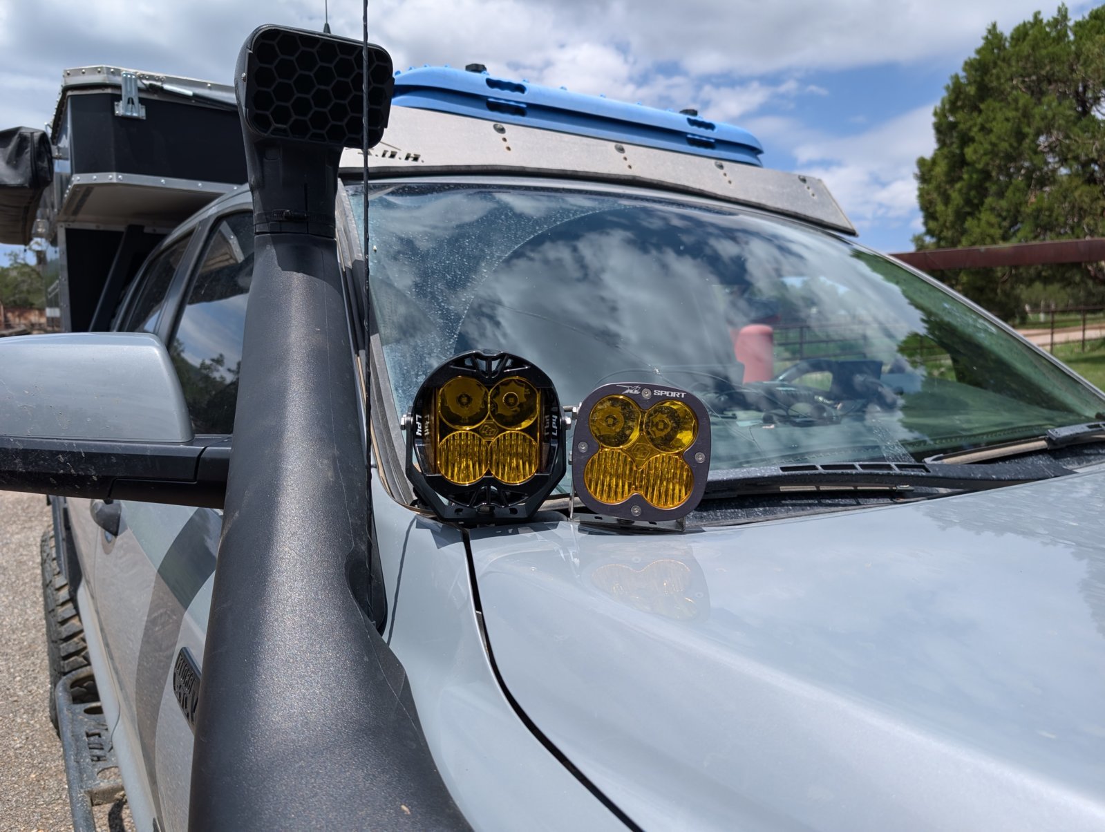

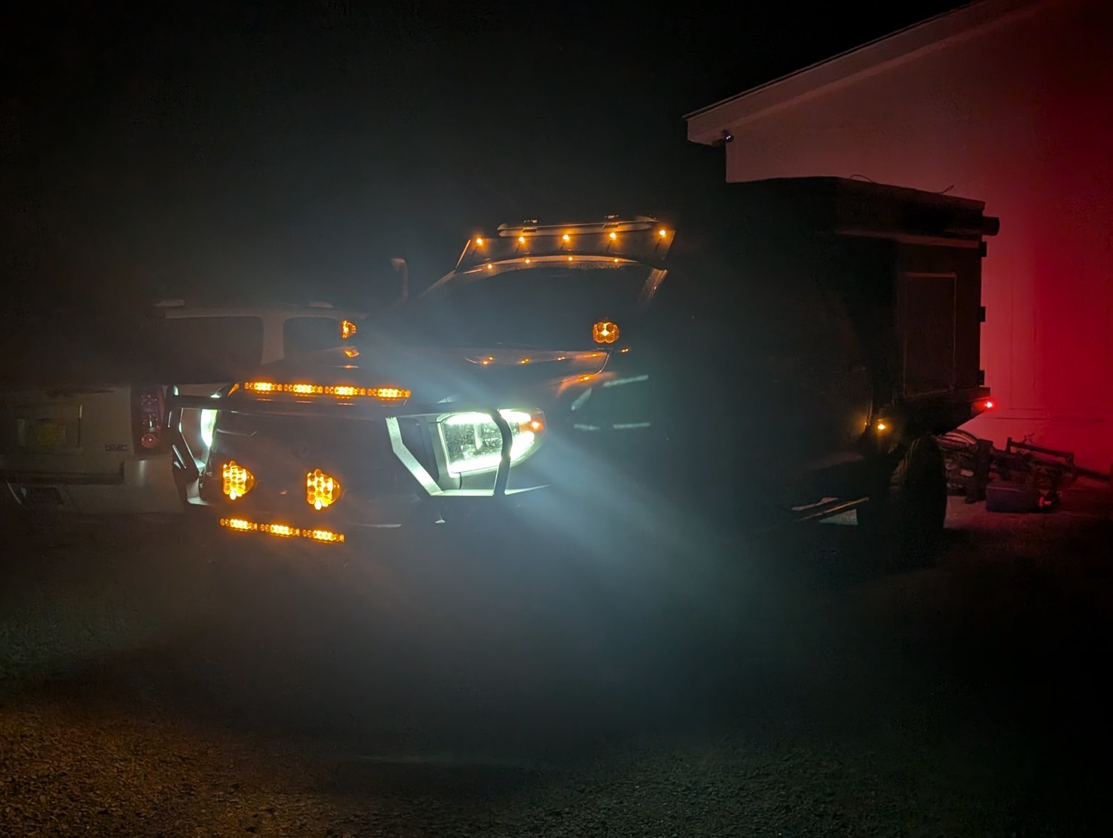

    I also had some time last weekend to swap the XL sports out for new LP4's on the ditch light brackets.

    Still running no front sway bar with all that added weight? How's it handle on the highway?

    The lighting package on the RIG is dialed! How do you like the swap from the XL sports to the LP4 on the A-pillar? Since you have them kicked out a tad do you still get some hood glare with the IPT?

    Yeah still no sway bar. I definitely have some roll, but it's really not unmanageable.

    Thanks! The biggest reason for the swap was because a buddy gave them to me cheap, and I really wanted the drl function. The XL sports were great ditch lights. However, the LP4's are super bright and the style is hard to beat. The IPT does not seem to make much glare on the hood, but I do have them aimed out pretty far. I do have IPT covers in the shop but I don't think they will be going on.

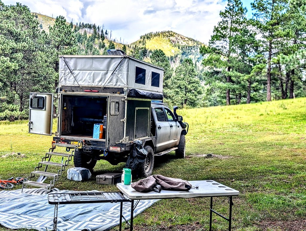

    We got out for a quick overnighter this weekend. The camper is working really well and was definitely worth the change. I'm hoping to find some time this week to cut the parts to extend my roof rack to get my boxes mounted up top and then cut a couple panels for the exterior of the rear doors to get our propane tanks, water heater and water accessories box and the trash bag mounted. The interior of the camper should be pretty open when those couple things are hard mounted on the exterior. I also need to build a cabinet in the interior for our cook stuff, but it stacks pretty well without one at the moment.

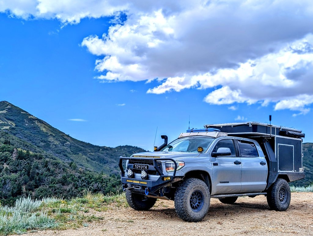

    I had some time the last couple evenings to make some progress on the roof rack extension and rear door mounting.
    I decided to just add to the current rack instead of build a new one and it worked out great. I scored a couple huge ROAM cases a while back on a trade so I mounted them up there and had to turn my traction boards and move my radio antenna but it was a pretty simple job. What's two more holes in my non leaking roof??
    PXL_20240828_231027553.PORTRAIT.ORIGINAL.jpg PXL_20240828_231041262.PORTRAIT.ORIGINAL.jpg
    Next up was drilling a ton of holes in the rear doors of the camper to mount a couple pieces of L track. I just used rivnuts and 3m tape to mount these. The passenger side will have the trash bag and a 10# propane tank. The driver side will have a case with my water heater, hoses and other miscellaneous water stuff and then a second 10# propane tank.

    Man! The roof rack turned out great! The Roam boxes look right at home up there!
    Gotta love putting holes in expensive things! LOL
